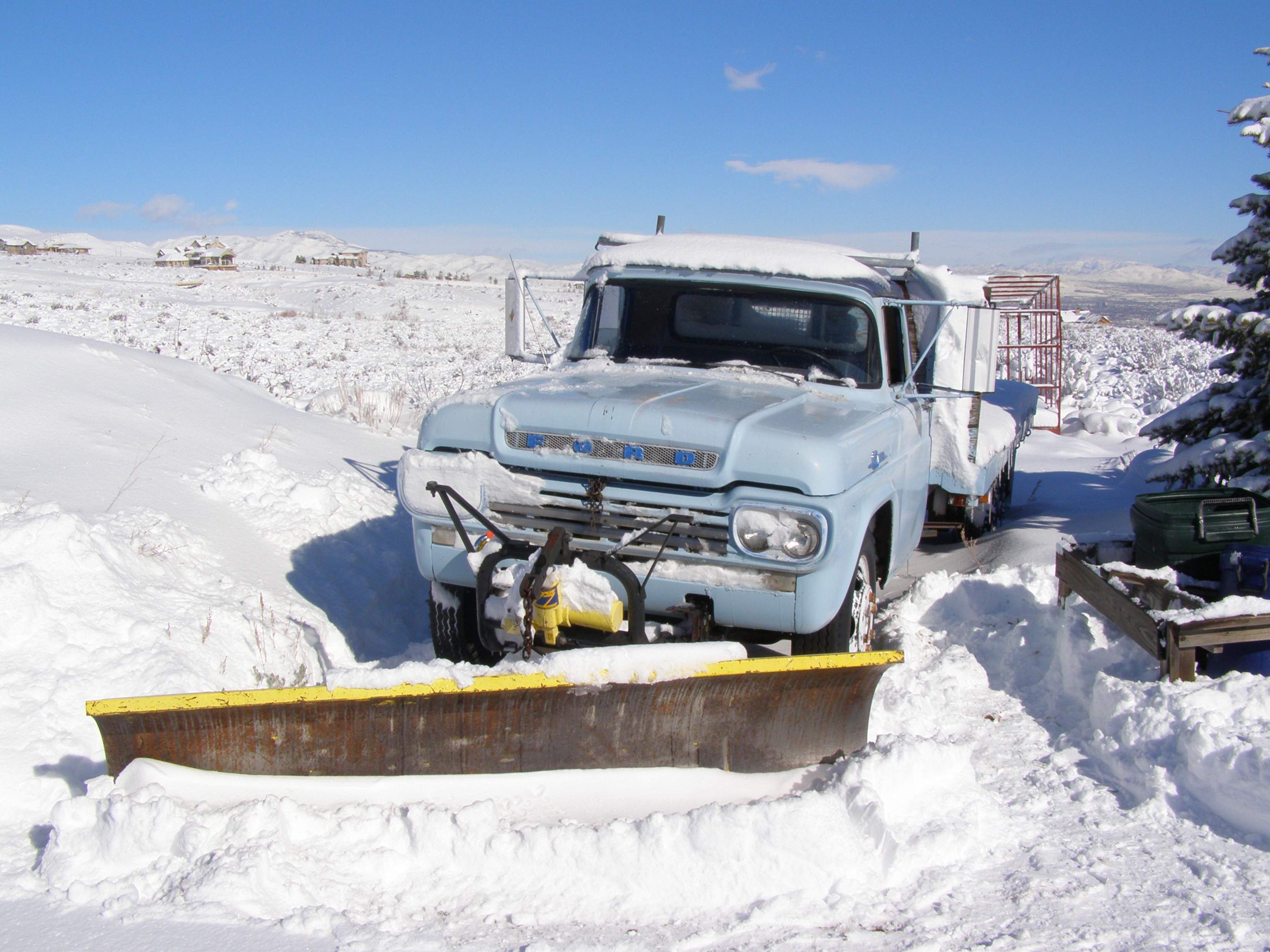

After receiving 3 consecutive days of 2 to 3 feet of snow about five years back, 3/4 mile of road to clear and the final straw that broke the proverbial back. The icing on the cake was the wind storm and another 2 plus feet of snow that filled in the 4 foot snow banks with wind driven snow. The 9.5 foot plow on my f-600 was done. Didn't have my 4x4 tractor then so the only thing left was a 2' Troy Built snow blower. Took 4 hours for the first pass of only 350'. About that time the fire department showed up with a D-7. Emergency money from the state helped clear paths for our vehicles.
Lesson learned, snowblowers send snow to far away places, places that are out of the way. I still use the Ford F-600 most of the time, faster and more efficient. But when the big ones come again, I will be ready now with the 74" Shulte rear blower on the 49 horse 4$x$4 Yellow MF tractor.
yada yada yada.:dance1:
And these days the state is broke.:shocked:
