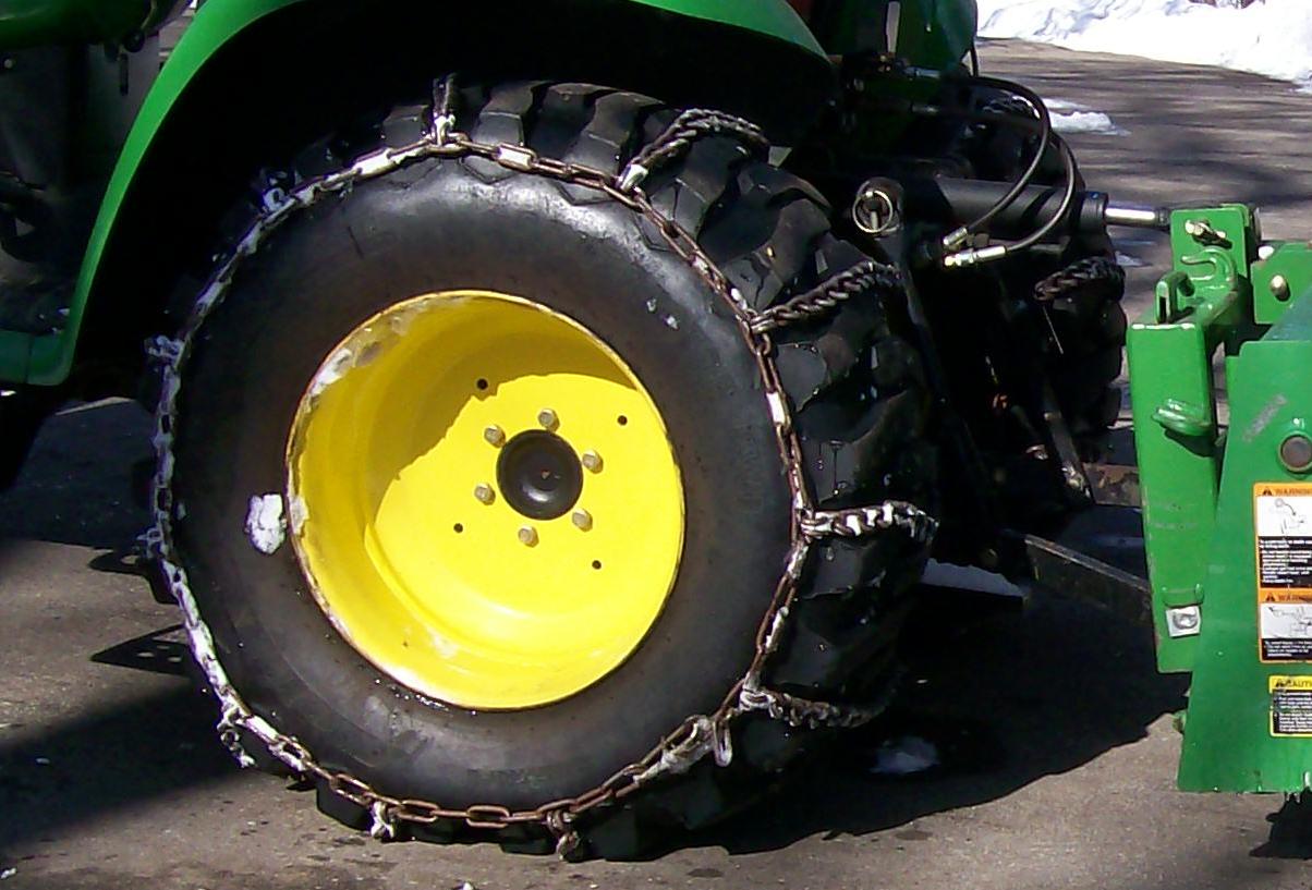

Wow, Dead Horse, that is a great set up you have. Will look into the plow. Just got a estimate for a front blower 59 H $5,500! I think my wife would move out if I tried to slide that by. Def. getting chains, but they seem to run the gamet as far as price. Any suggestions? JD also gave me a estimate for a 7 foot hydrolic front blade for $2000.00 any thoughts on that?
I will catch flack for this, I am sure, but I have the experience to back my opinion up. On a gravel drive, chains are chains............. and you can source them on the CHEAP from NAPA. All you need is your tire size and tread (R1, R4 or turf) design, and make sure they fit tight.
Buy at least 4 bungee cords when you pick up the chains, too. Measure the diameter of your tractor rim and get the cords a hair shorter than that. Two on each wheel will keep the chains from moving around once you have them on TIGHT.
You will be tempted to just go with front chains because of cost. I do not recommend that on a small tractor, especially if you are also going to put a plow blade on the nose..... go with rear chains. Your front differential and planetary gears/bearings will thank you.

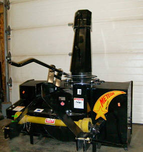

As to my opinion on your last sentence........I have found JD is VERY PROUD of their stuff......... way too proud as far as I am concerned. I sourced the Fisher you see on the front of my Hesston for $0......... yep, zero. My cost involved making up the hoses for the cylinders, and an hour or two of playing around with how to mount the bugger.
Heell, the Meteor blower I have was $1,200 brand new......... I believe you would have to be nutz to spend $2,000 on a plow, unless you were planning to run it commercially.

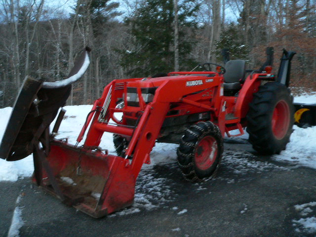

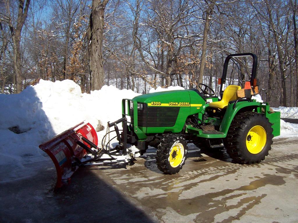

I picked this plow and A frame up for $100. Yes, it was an old truck plow. Yes the cylinders work just fine with my loader hydraulic connections. In high gear, snow runs away from the tractor. A few bolts and a front cylinder link pin and its on or off. The key element is its closeness to the front wheels. This reduces the moment arm that tends to resist steering forces from the front tires. I have 6 40 lb suitcase weights on the bar to increase front traction. The rear mounted rake is added for spring/fall gravel dressing. Going on 11 years with this setup. Not a single problem. As mentioned, I can do 2 lanes of the township road after my driveway is done. I usually outrun following traffic, too. They have nowhere to go once I turn around...

I picked this plow and A frame up for $100. Yes, it was an old truck plow. The key element is its closeness to the front wheels. This reduces the moment arm that tends to resist steering forces from the front tires.

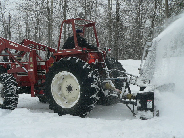

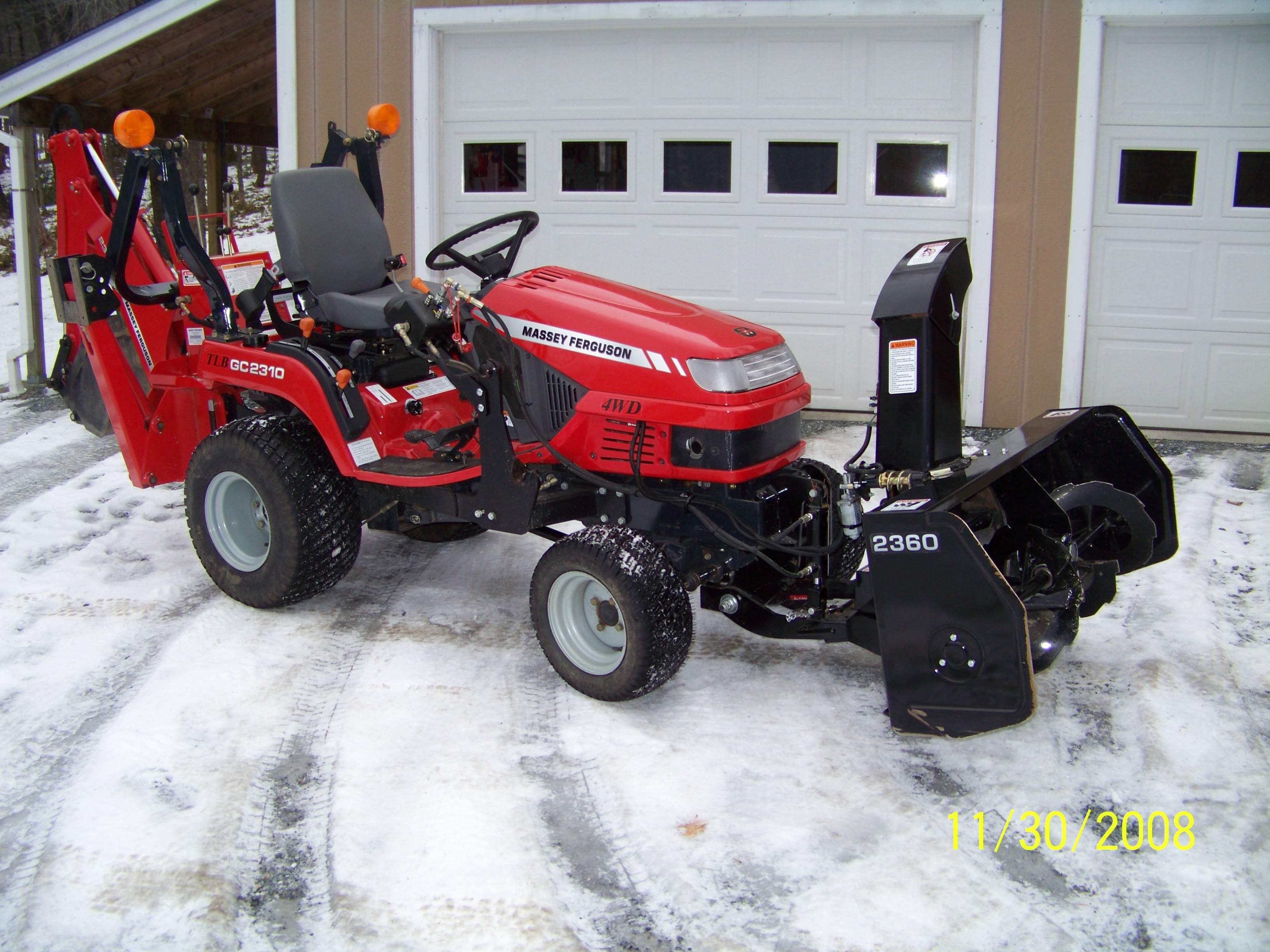

Steep = chains, no doubt about it. I use front and rear and our 4320 is a tank with them. You will get snow covered if blower and no cab - helmet and one piece suit recommended. I don't think there's a mid-PTO driven easy front blower option for the 43x0 Deere's - if hydraulic blower into serious money. Blower getting rid of the piles is a huge benefit especially in the spring - not relevant if you don't get accumulated snow eg melts between storms. All solutions are easier where snow and ice stick around so plowing frozen ground and leave a thin layer of frozzen stuff to keep gravel down - good to drive on first snows to pack it down if able. A blower will be easier than a plow on unfrozen ground in my opinion though if it does dig in you throw the gravel (beware buildings etc. If I had to plow I'd get a truck plow before a plow for an uncabbed tractor. I use blower to clean up between truck plows and keeps the banks to a manageable size - where we are pickup plow without wings can't keep road wide enough most years due to banks.

........ I don't think there's a mid-PTO driven easy front blower option for the 43x0 Deere's - ........]
I believe there is a front mid PTO driven Deere blower. Don't recall the number right off, but they are around.
(albeit, the FEL has to come off)
Nice pics, and agree that the snowmobile helmet makes life more cozy. :D

It certainly is a plus......... I have loaded tires on both tractors and recommend that approach. NB: that when the plow blade is on the ground it does not unbalance the tractor so with chains you will not be unhappy unless you are trying to push a lot of snow UP hill.
In my opinion the purpose of the chains is to limit wheel spin and have effective braking. You start a slide and the first thing you should do is drop the blade. With chains, you can use the brakes to slow the tractor without eliminating steering. A tractor is not a plow truck......... it is made to do the work effectively with a TON of torque and at a slow speed.

Blades are OK, but you'll run into trouble if you get a couple of feet of wet heavy snow. I have a fairly steep driveway myself, and 1100 feet of it to boot. To tackle anything that drops, you need one of these:
I found this 6' blower w/ hydraulic chute controls on Craigs list - listed for $1500 - after a bit of negotiating, I ended up getting it for $1350 w/ a Woods 6' scraping blade thrown in for free :).
I bought chains for all 4 tires this year, but haven't mounted them yet. I'm thinking of mounting just the front wheel chains first (2-link ladder V-bars), then put them on the back (2-link ladders) only if I find I need more traction.
