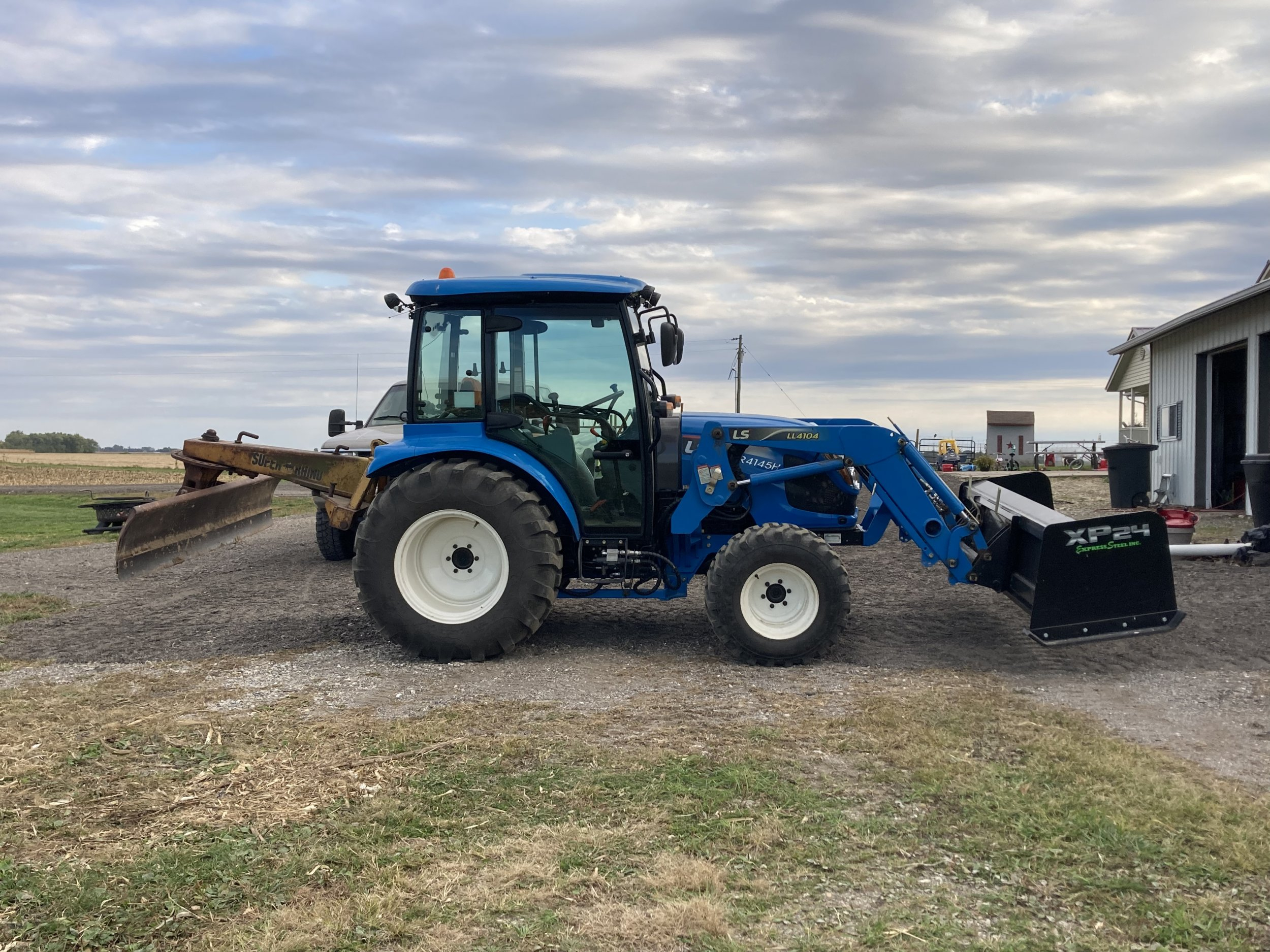

I’ve got an Express Steel 8ft XP24 snow pusher. My driveway is straight and about 900ft long. My tractor is a LS XR4145HC. Rear tires are loaded and I keep my Servis Super Rhino blade on the back.

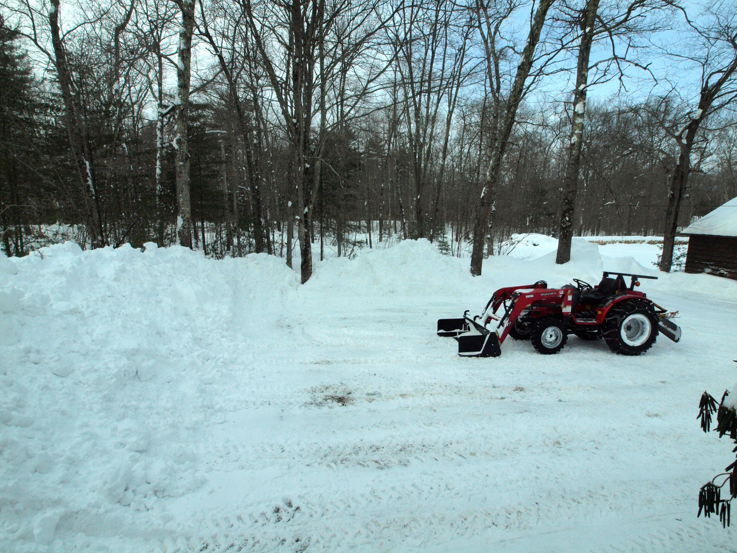

I find this combo pretty efficient. Problems arise when people get too large an implement for their machines. I have a 5' pusher and a 6' rear blade on my 3016 four thousand lb tractor with rear chains
It gets the job done and works for all kinds of snow from 6" of wet stuff to 27"of dry stuff.

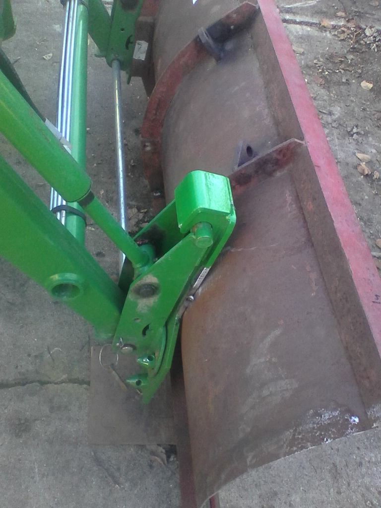

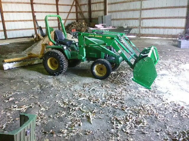

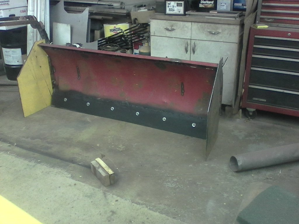

I made my own. I bought a rusty 7 foot plow blade for $100, cut it down to 6 foot, made wings and used some (real cool) pre-fabbed quick release mounts (also $100) to attach to my loader. Haven't used it yet, though.
