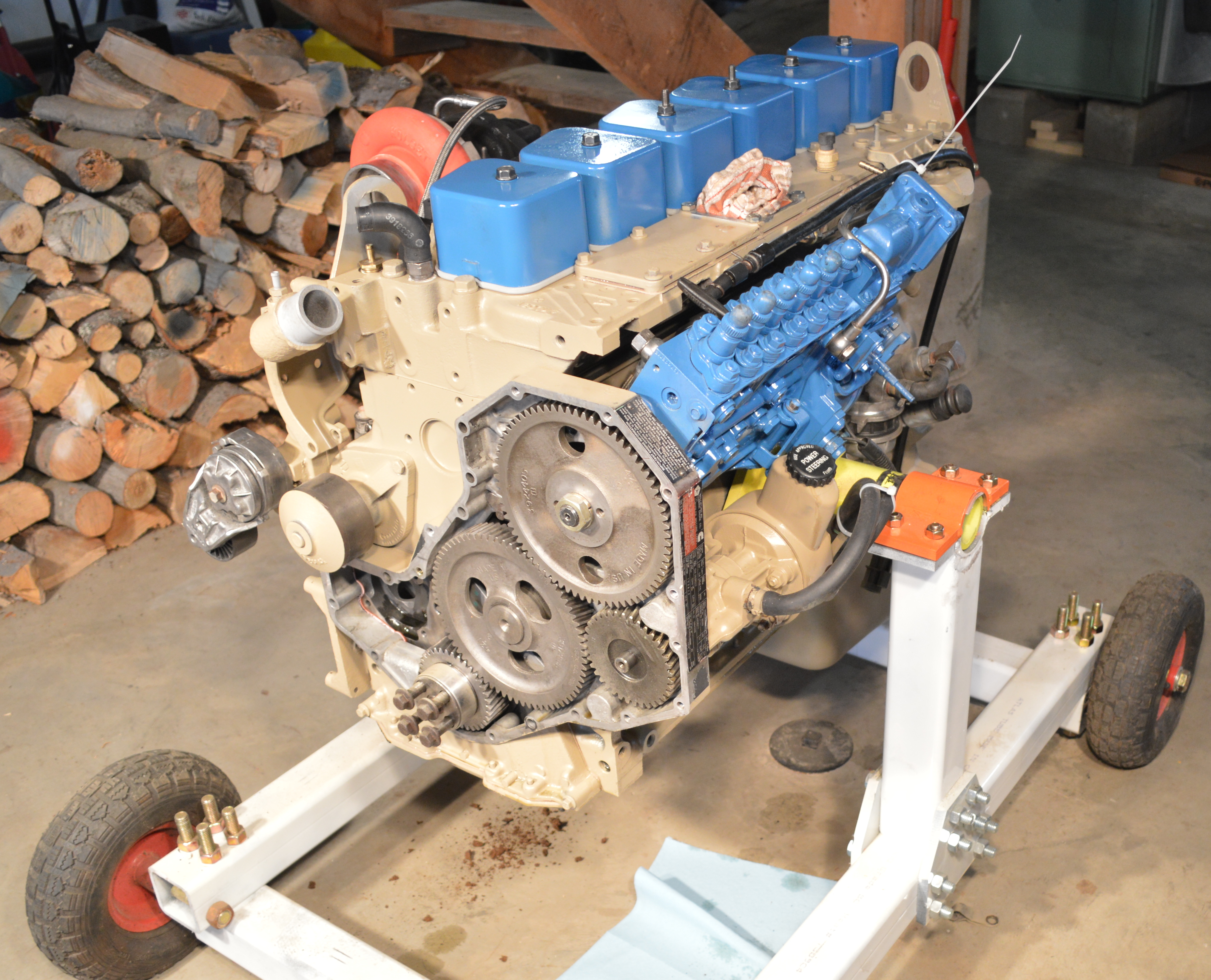

/ Snow PUMP
#199
The first engine bagged (and to enter service) in this project is coming along nicely. It's my second diesel and first Cummins build. I've learned a lot of respect for Cummins in the exercise, for example the way the power steering pump is done. It's exactly how "I" would have done it. Let's face it, loosing steering boost on a half-serious truck is a distinct accident risk so a solid drive instead of the belted pump makes points with me. I won't even mention the current fad of electrically assisted steering solutions.
