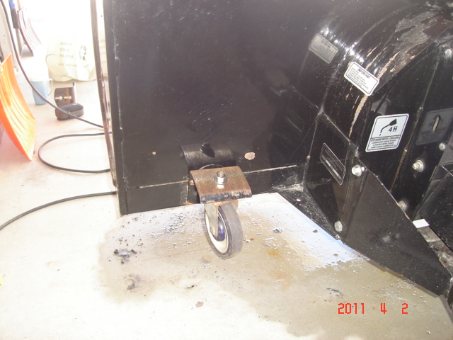

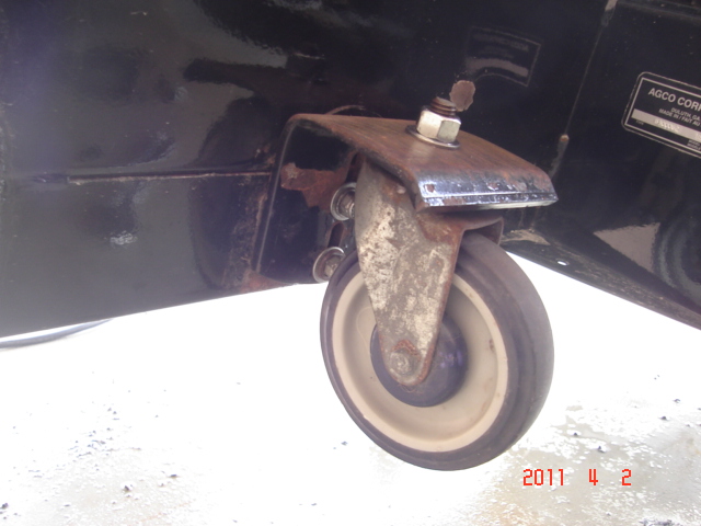

I also tried to come up with a way to deal with the wet, heavy stuff on top of a soft gravel drive.... my solution was "free" (had some 5" casters laying around), but wasn't entirely successful.
It did help some, and might be quite useful next winter, but I like your skis idea!
I took my skids and flipped them upside down to mount the casters; however, the casters are a bit too narrow to prvent sinking in, if the ground is really soft. They'd probably be fine if the drive was firmer.

FINALLY! I have to find an easier way to get pics from my camera onto my laptop.
Anyways.... here's the pics I promised.
