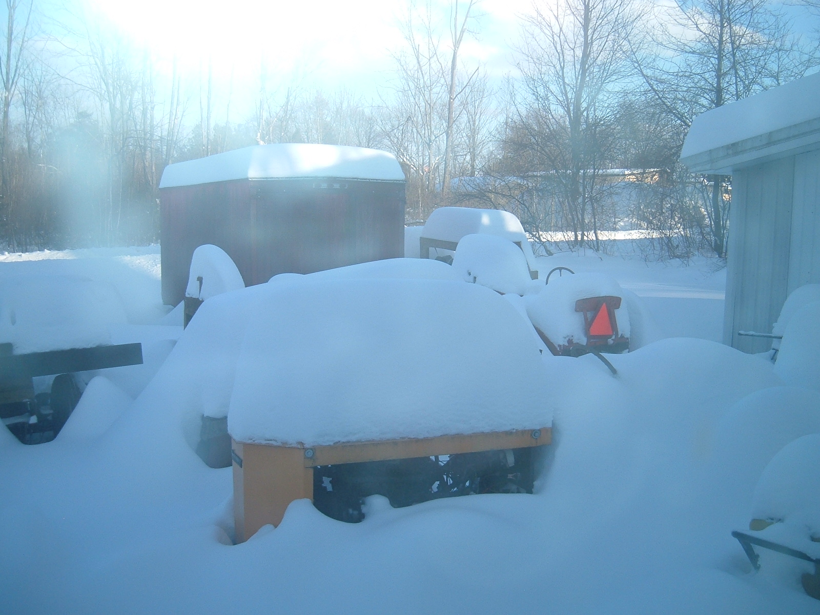

That snow wouldn't rate a second look around here. Somewhere in this picture are four trailers, two farm tractors, a skid steer and a backhoe. I'll probably find them by Spring.

Norm, at least your lumps have definition in the yard.... my picnic table is gone.... just a gentle swell in the snow!

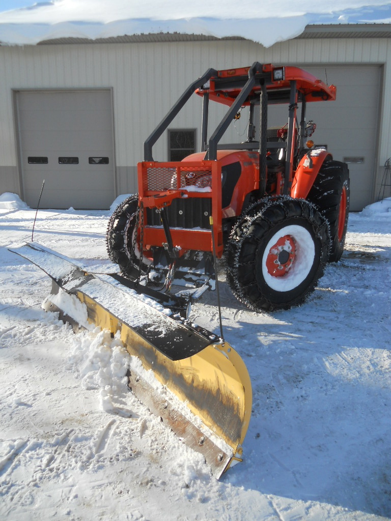

Ed, a 8"-10" piece of rubber belting across the top will do the trick and is an easy drill & bolt job. You can bolt ti on sticking straight forward, if the snow get's deep enough, it will roll the belting upward and deflect it just like it was a vertical blade extension.

Rusty, not sure if I asked before but, how wide is that blade,
looks like a good 8 1/2 footer.
