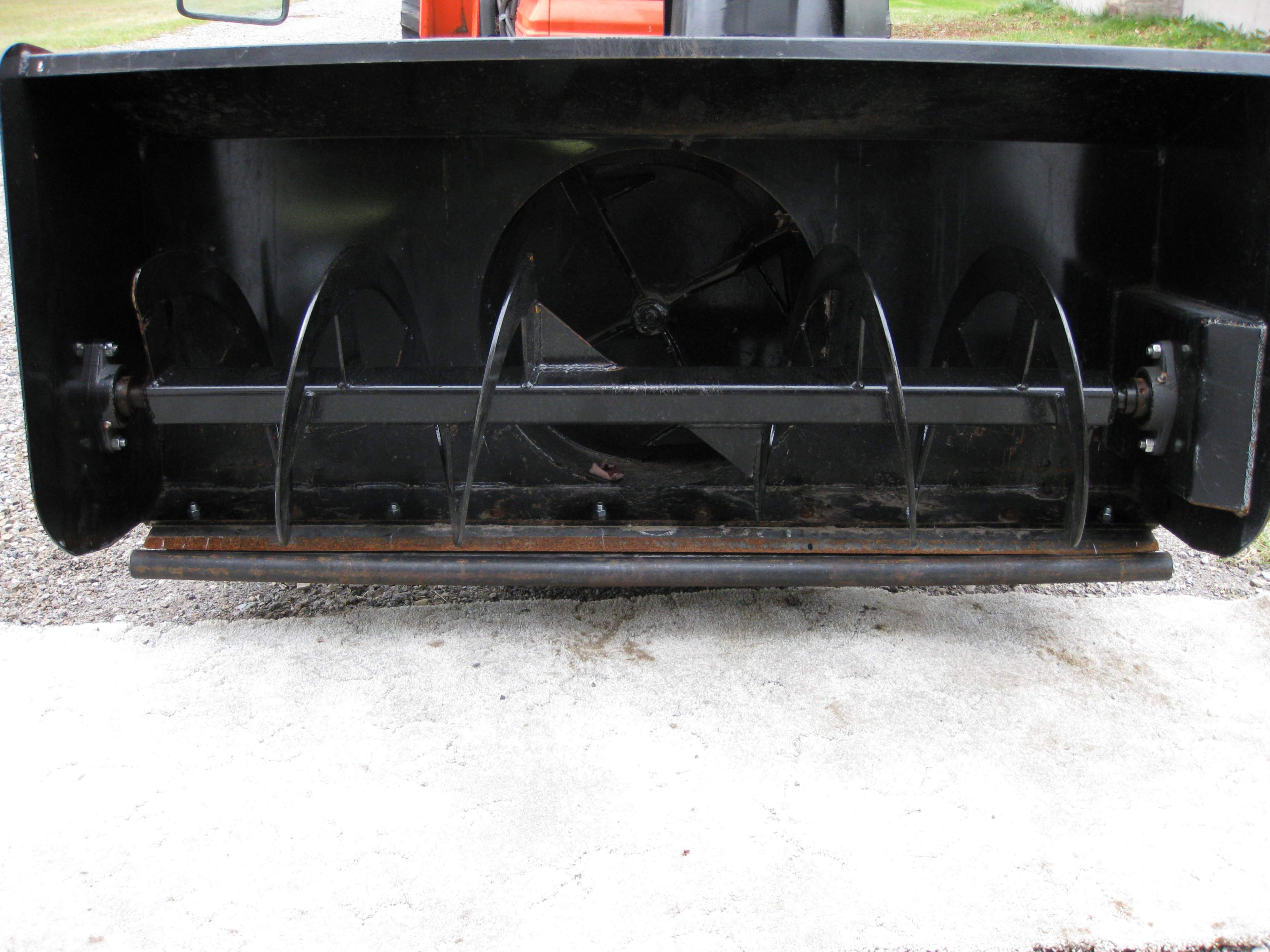

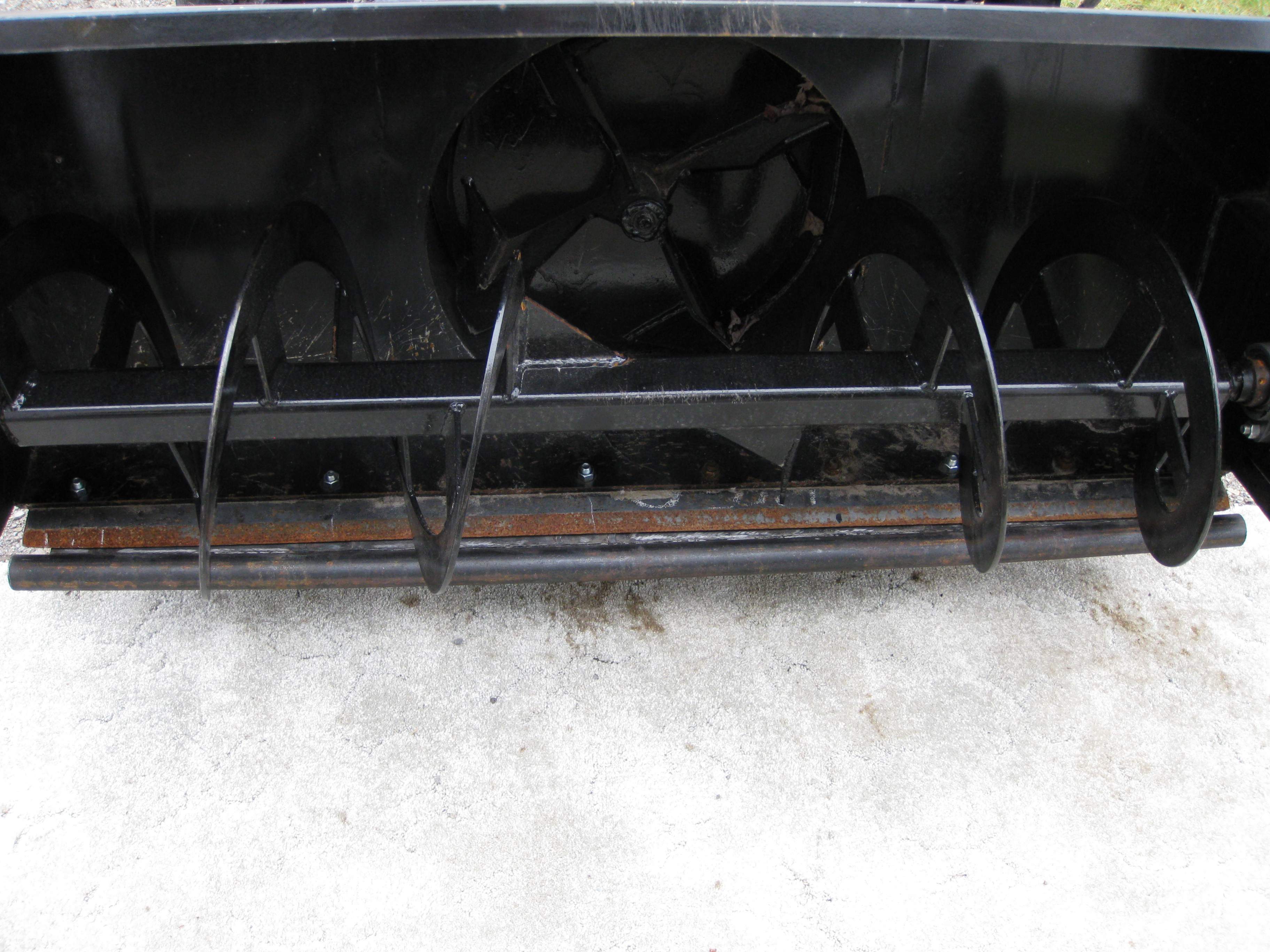

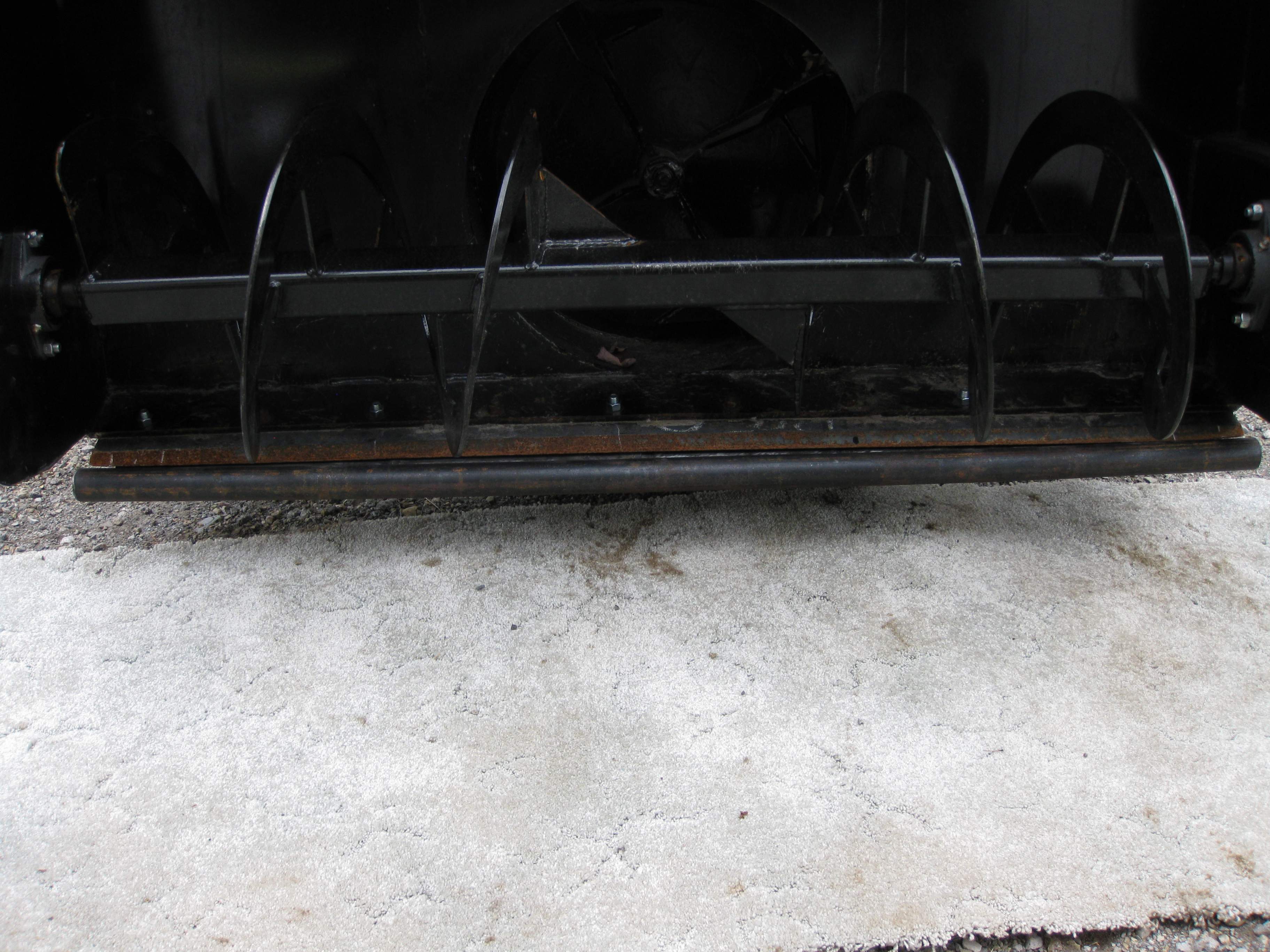

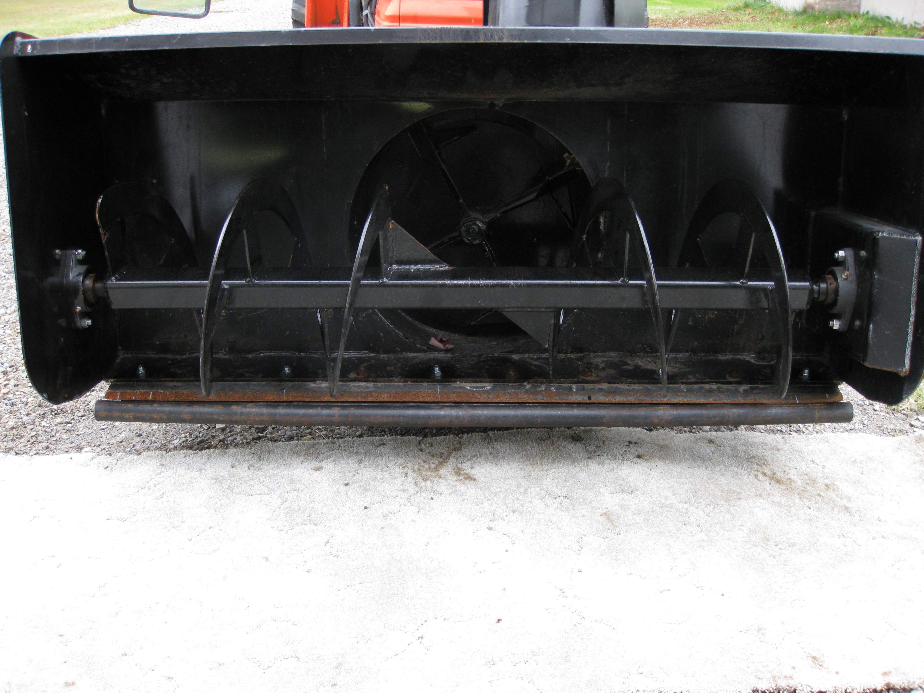

This is what i did to the front of my blower. It would be the same on a loader bucket also. I welded five tabs to a 1.25" schedule 80 black iron pipe and bolted it to the existing cutting edge in five spots.
