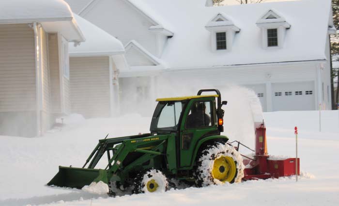

Yes all of the JD3x20 machines are 4wd. My issue is control of the machine going down the steep section of my driveway when we have ice. This is usually when I have a 1" hard packed snow surface on top of the gravel after plowing previous storms and then we get some rain and a freeze and then a few inches of light snow on top of the ice. I have lost control of my plow truck in the past and now use chains on all 4 wheels of the truck with ice on the driveway under the snow. Of course I don't drive the truck at speed on the road with the chains.
As I said, the R4s work well in snow on moderate grades. I do have loaded tires and either the blade or a ballast box on the 3pt hitch so I am running at about 5,500 lbs which is great in plain old snow. The chains give me control on ice in my special situation.

I had to do a little (and I mean little) research as to why I've been told NOT to use chains on the front tires. The short answer, from my dealer/mechanic, is that if you're running straight, you don't have a problem. However, as soon as you start to turn the wheel (4WD) if both front wheels dig in, neither can spin, you'll start getting "axle windup" (very technical term /forums/images/graemlins/tongue.gif) and run the real risk of tearing up the front axle drive gears (clear as mud?).
My dealer said that there are dealers around who will sell, and/or bless, use of chains on the front in 4wd but they will not as they have re-built several front ends damaged by that practice and ended up with very unhappy customers who they could have saved the serious $'s of a rebuild.
I'm sure there are TBN'ers with much more sophisticated descrtiptions of what happens in the front drive if turning in 4wd and the inside wheel is not allowed to slip, to keep up with the revolutions of the outside wheel turning the larger radius turn,....or something like that.
