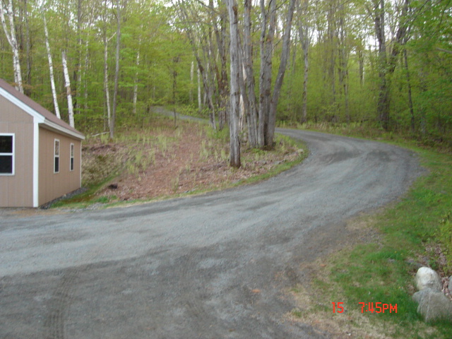

I use a M-F GC2310 SCUT with turf tires on this driveway-- try to imagine it with 1-2 feet of snow on it (yes, it's uphill, and rather steeply at that).
I use the FEL occasionally, but mostly a front-mounted 50" snowblower, and it works very well. Going uphill the tractor's a bit light on the front end so steering control is reduced, but downhill or level ground is no problem at all. I don't even use the 4WD much. I suspect the blower is more effective than a blade as it clears its own path.
The sloped part of the drive is about 150'. The turf tires have surprised me more than once, and I haven't yet had to use the chains I bought with the tractor--

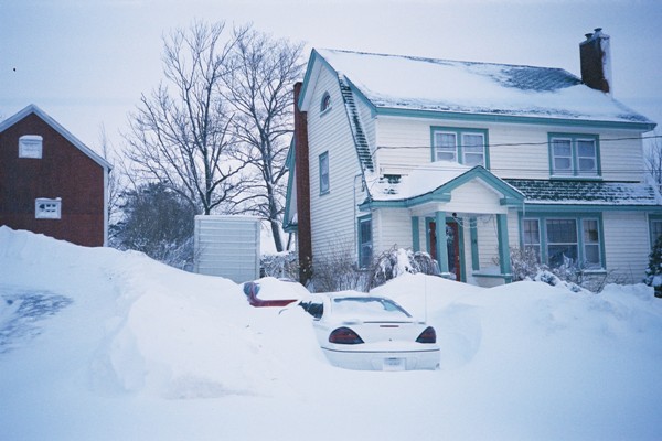

The tractor mentioned is very similar to ours and should be able to do the job.
Our driveway has a 20 degree slope and it is cleared in the winter with a Kubota B7100 HST with turf tires. I just use the loader as the snow must be moved and piled if we get much of it.
Turf tires are probably better or at least equal to other types of tires on hard packed driveways under winter conditions. Of course the addition of chains makes for a world of difference. :D
Picture of one driveway shown.The upper shown driveway is not steep like the lower driveway
