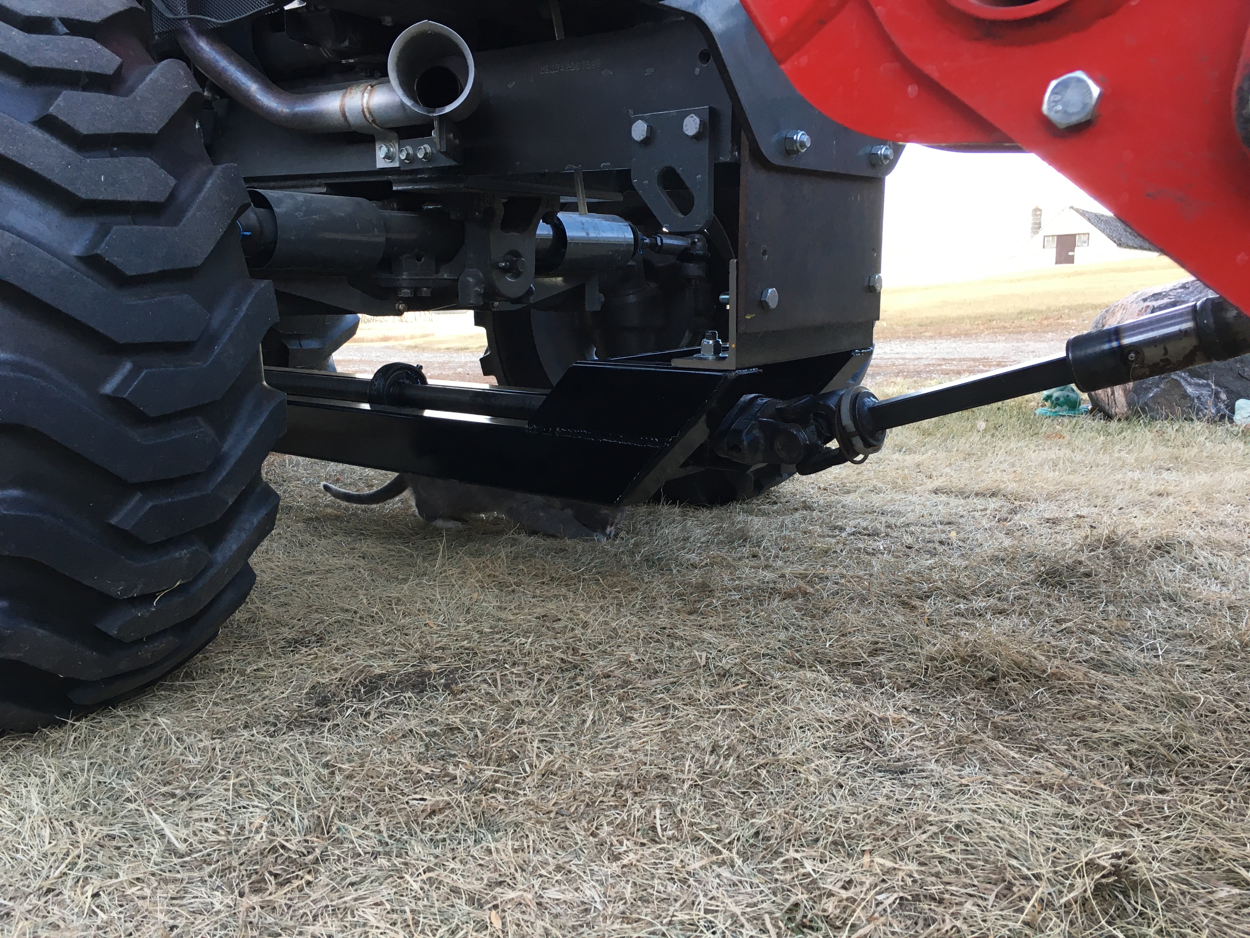

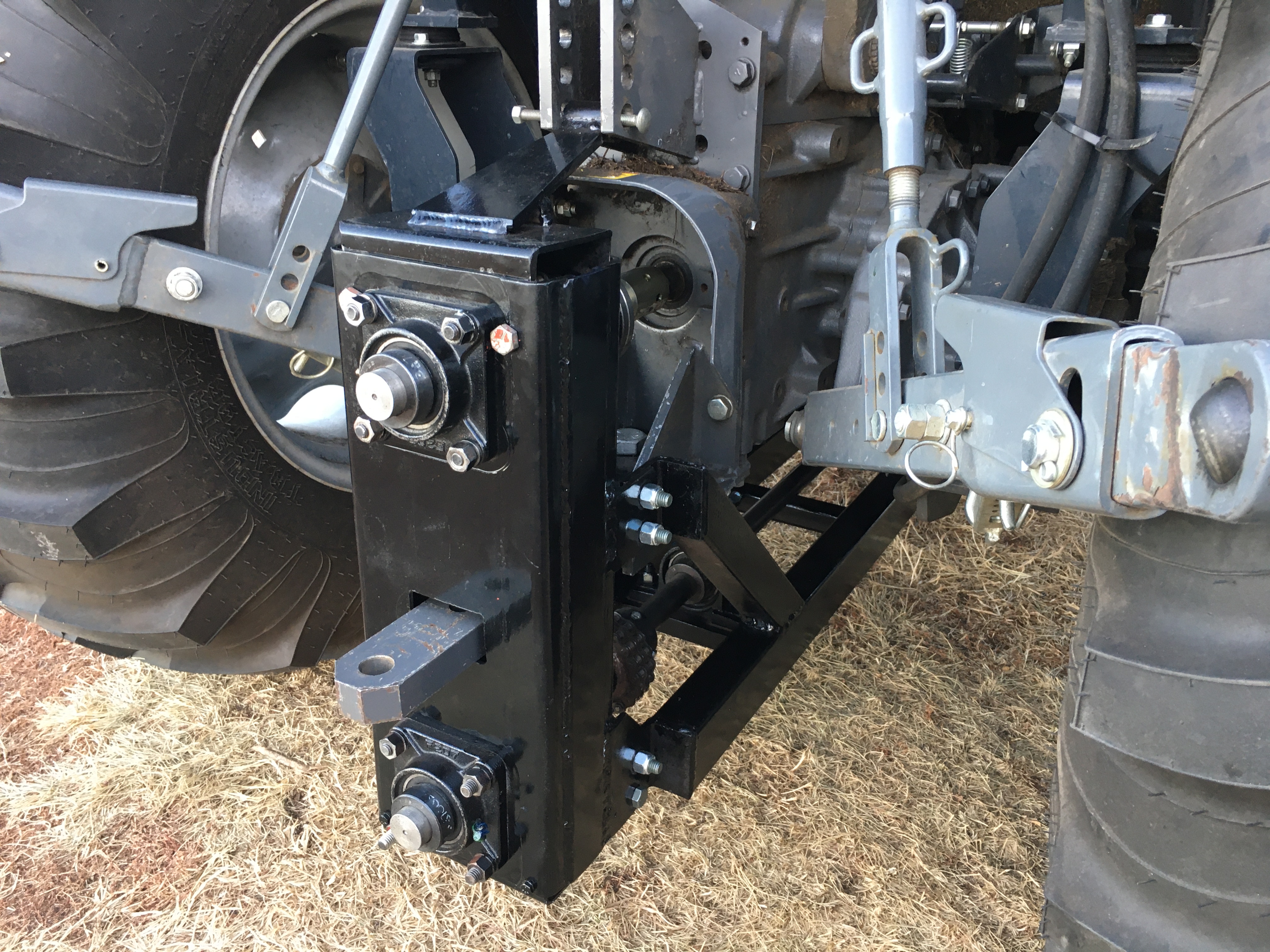

CB42B14F-D361-4826-84DA-984317EE5B69.jpeg55C96324-327A-40DD-863B-6272F7E00993.jpegA couple more pics.

That unit you have constructed looks very similar to the setup installed on the 2009 Kubota M7040 I saw in the the dealers shop. As I remember - the entire setup cost right around $14K. Only the school district with federal tax $$$ could afford such a setup. Brand new M7040 and this shaft drive front mount blower.

Weather forecast is for a major blizzard this weekend. Almost two feet of the white stuff has been ordered, I think off Amazon by a local farmer. Much needed moisture for the prairies. I have two end caps for sprocket shafts to spin on the lathe and one weld to finish this off. A trip for some extra fuel for the tractor and gas for the generator is also in order.
oosik, I will check what receipts I have to see a cost on this project. Pretty sure it is under the $2 k mark. Got a smokin deal on the blower at the local Kubota dealer. Just over $900 for the blower, $230 for the ssqa plate and $100 and a bit for the shaft. Prob another $100 for the 2x3x .125 rails. Bearings, sprockets, chain and a couple pto adapters don't add up to a lot.
