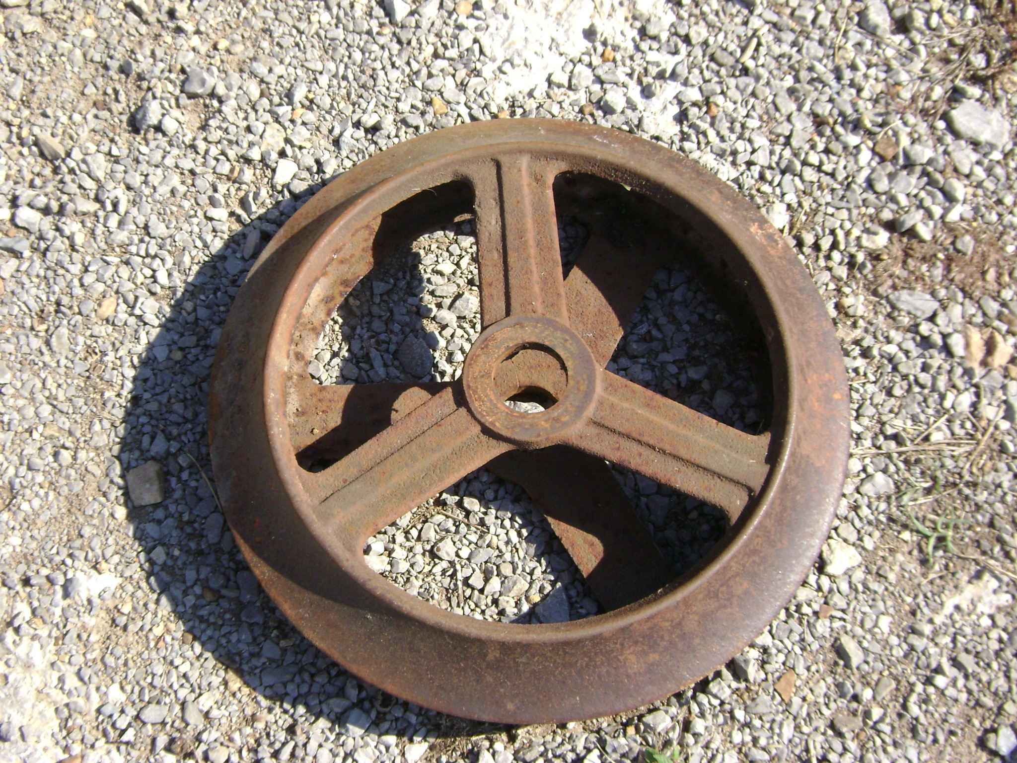

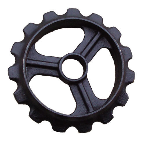

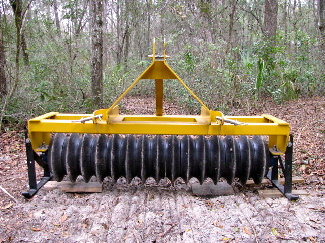

Building a cultipacker and looking at two wheel options. Option 1: larger smooth wheels 17" OD x 3 3/4" wide and 24lbs each Option 2: Notched wheels are 9.5" x 2.28" wide weighing 8.2lbs each. Based on a 5' wide cultipacker, the smooth wheels add about 40% overall weight. Is weight the only factor that I need to be concerned with? Seems like the notched wheels are what most people are using these days. My only other concern would be part availability (if one breaks) for the smooth wheels whereas Agri supply stocks the notched ones. I would be using this cultipacker after a tiller for food plots such as clover or larger grains.
Smaller notched wheels
Larger smooth wheels

If soil is highly prone to form hard clods which remain after one pass of a Disc Harrow, notched wheels are preferred to break them. Notched wheels are somewhat a specialty item.

Not in my experience. Even the "smooth" wheels have a high ridge, which gives them a certain boat rudder effect. And, being of cast iron, they are heavy, so lots of rolling inertia. I think my 72" Cultipacker weighs 860 pounds.

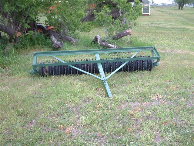

You need both. Alternate the smooth and notched wheels. That way you keep damp soil from clogging the V's formed by the smooth wheels.
Here's my 10-ft wide cultipacker which is set up that way.
Good luck

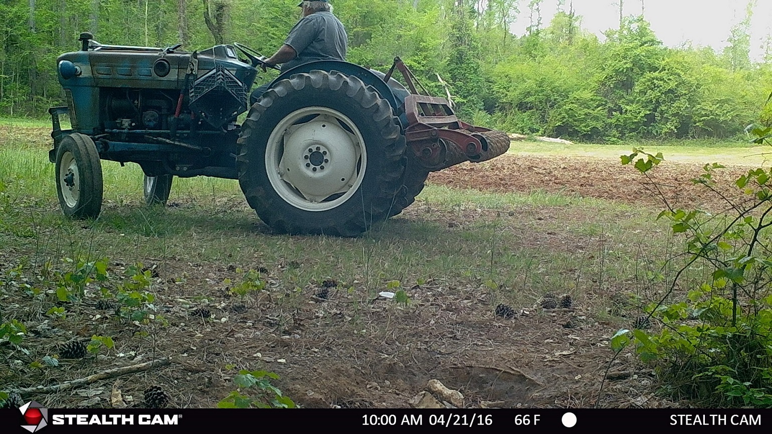

Until I seen that chart I wouldn't have thought there would be much difference. Not a good picture but the only one I could find right now. My Brillion has the notched wheels.

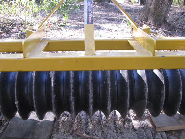

For food plots, etc, I don't think you'll notice much difference between the types. I think you'll see a bigger difference in performance based on soil type and moisture between plots. If I were you, and had access to the old original wheels, I would be using them. Tried and true. I would also be sure to get a few replacements and store them for future use. I could use a few wheels, but haven't stumbled across any locally.

Looks like it will be the notched wheels since I just couldn't get to the used ones in time. Hopefully it will be heavy enough but I'm sure it will since they make a lot of them that way. Thanks for the replies.
/ Smooth or notched cultipacker wheels? #13
I think it will be fine. I add several solid cement blocks to my old cultipacker for extra weight, which helps too. It's really amazing the difference in germination when you use one. It doesn't look like it does much, but if there is any moisture in the ground, you'll get an instant start on germination compared to areas you don't roll. I usually double roll mine, in angled or perpendicular directions.
