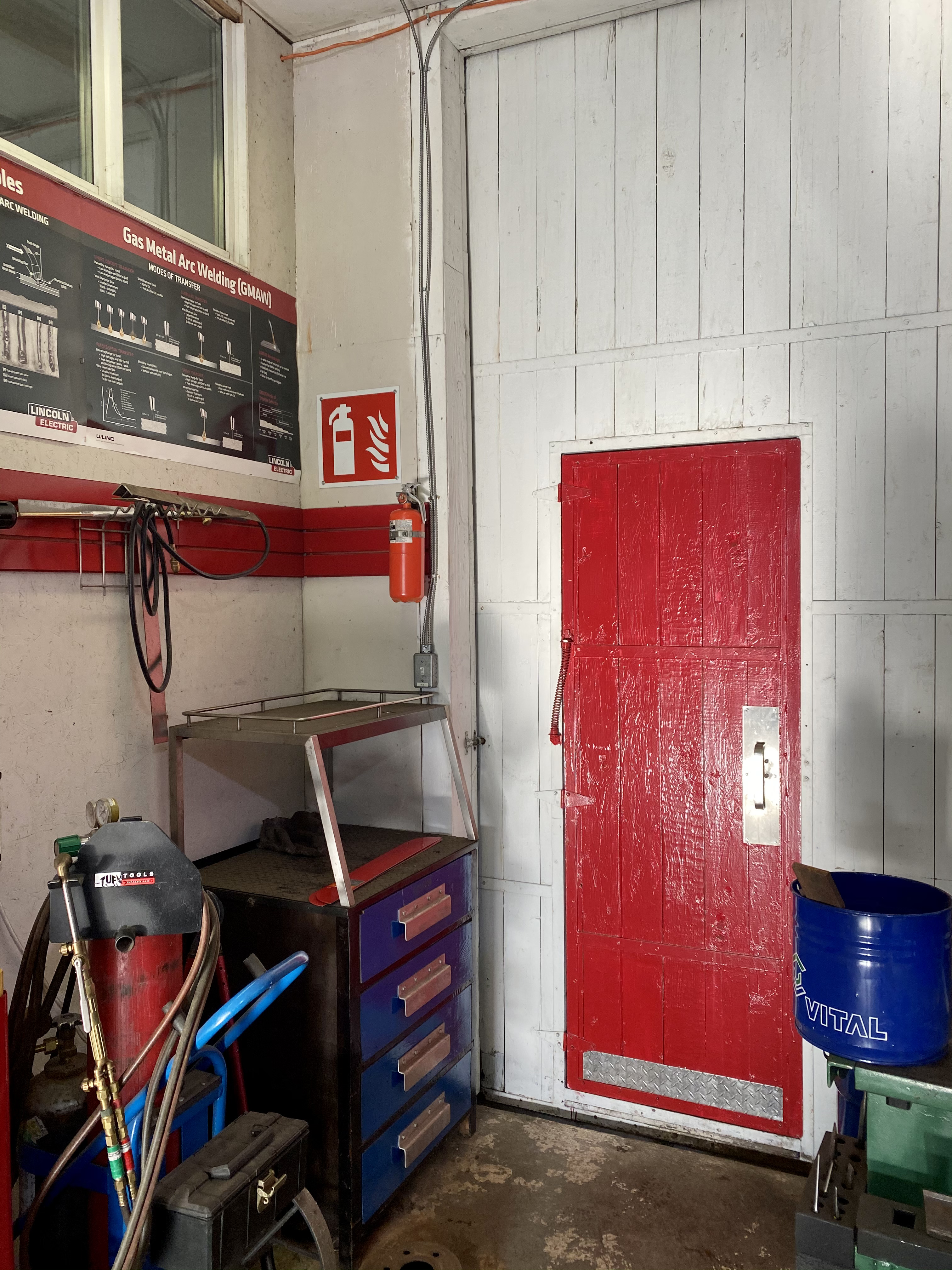

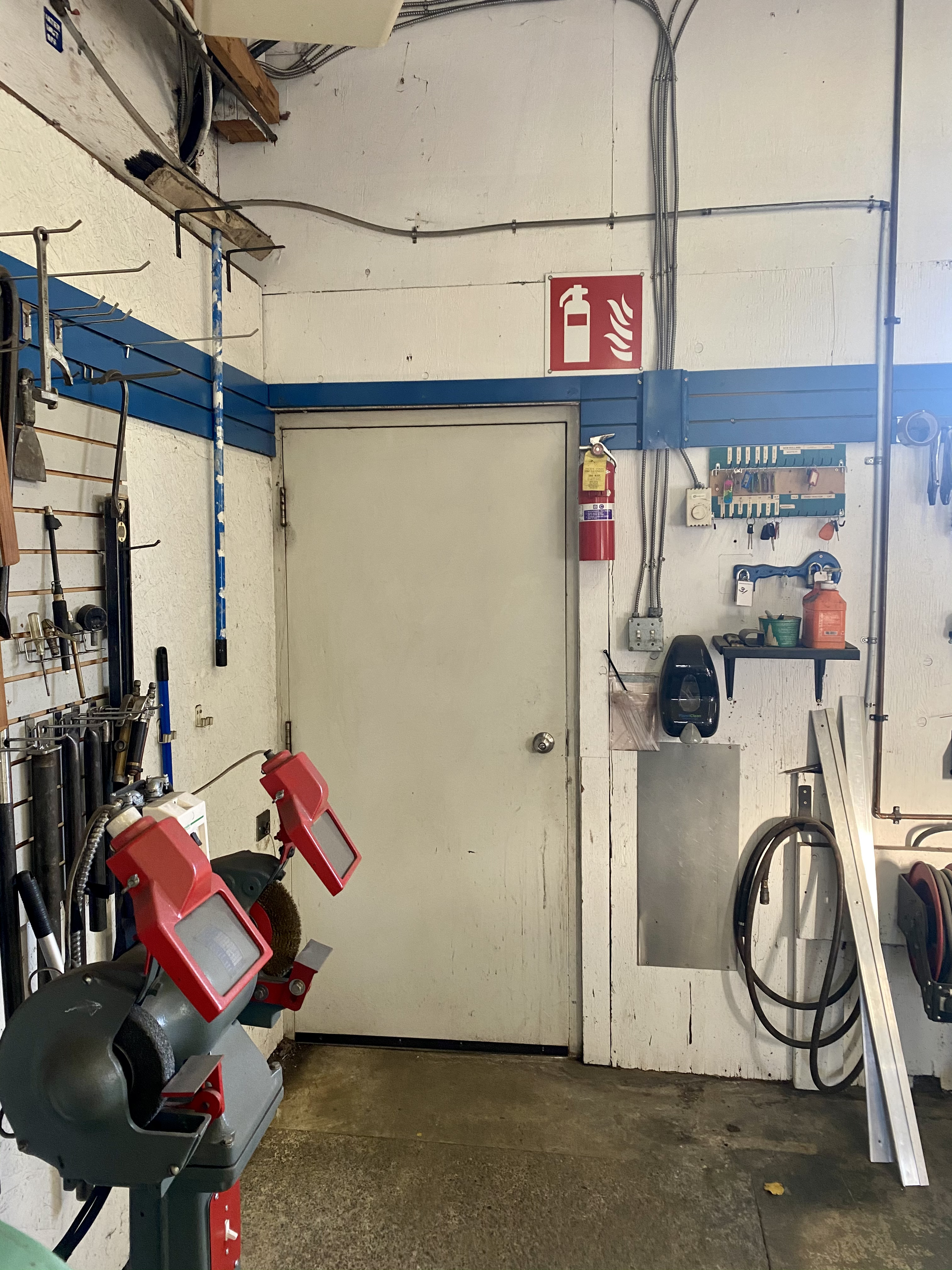

Fire extinguisher is very important. I have mine where I can get it on the way OUT of the building. Can be seen in the background here. Really should be a larger unit though.
It's good to have an extinguisher accessible if your way out is blocked!
Note the ratings on the extinguisher. Many are rated for liquids and electrical ONLY (e.g. 5BC). Such an extinguisher is NOT rated for solid fuel fires (wood, paper, etc.) The "A" rating is for solid fuels and is typically rated much less (1A:5BC). I really like to have an old pressured water extinguisher in the shop although I have to bring it into the house in winter.
As for electrical fire ratings, the first step is always to remove the electrical power. At that point, it is no longer a class C fire, it's usually a class A fire, so your 5BC extinguisher is no longer appropriate.

Fire extinguisher is very important. I have mine where I can get it on the way OUT of the building. .
Same.
Plus a few others in areas I deemed strategic.
