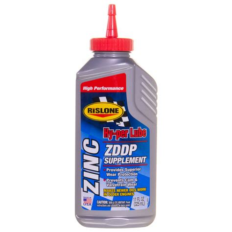

@dodge man Regular oil is fine and doesn't require synthetic. Lawnmower oil is formulated to operate at higher temps than regular auto oil, and also contains a higher zinc content due to the flat tappets.
Where do you find "lawnmower" oil? Straight 30w "reduces oil consumption" per my JD zero turn manual. I usually add zink also.

My 2 cents. Don't put additives in your oil for the long run. You don't know how it will effect the additive package of the main oil.
Some air cooled engine oils are high in zinc, others are not. When reviewing JD branded oil data sheets a while back, they had changed their blend away from zinc. Oil tech is constantly evolving.
