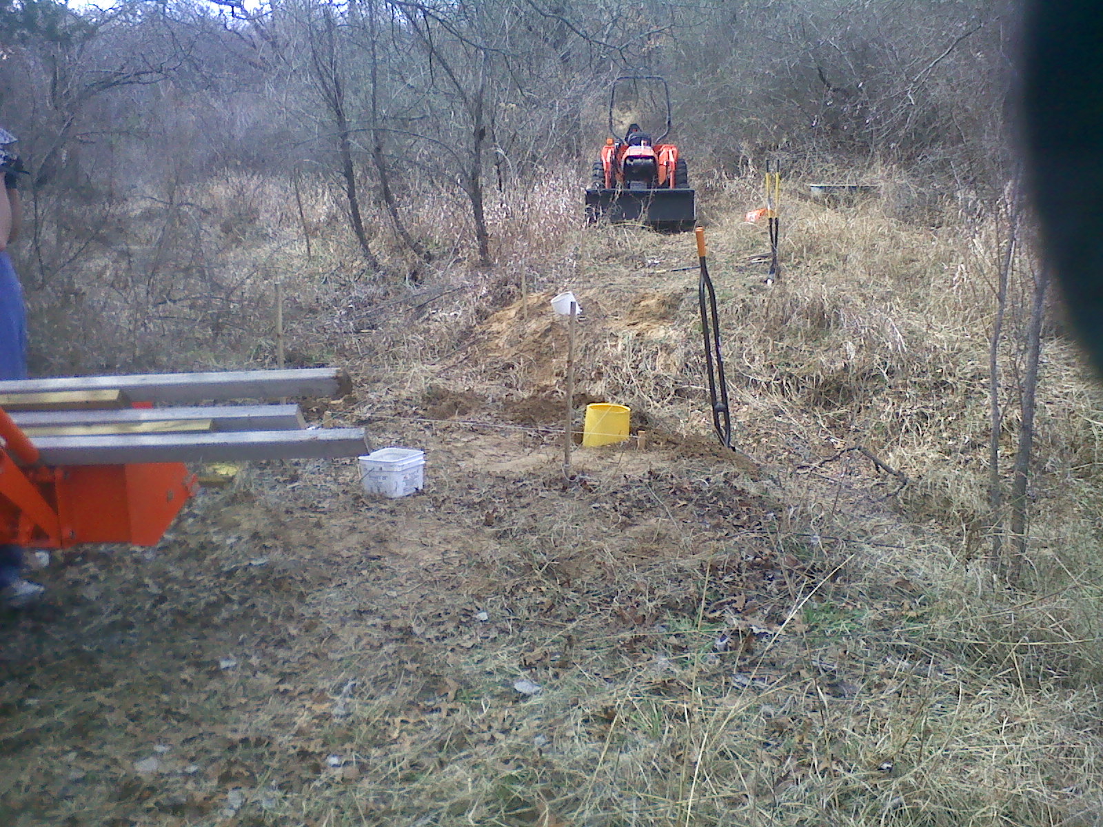

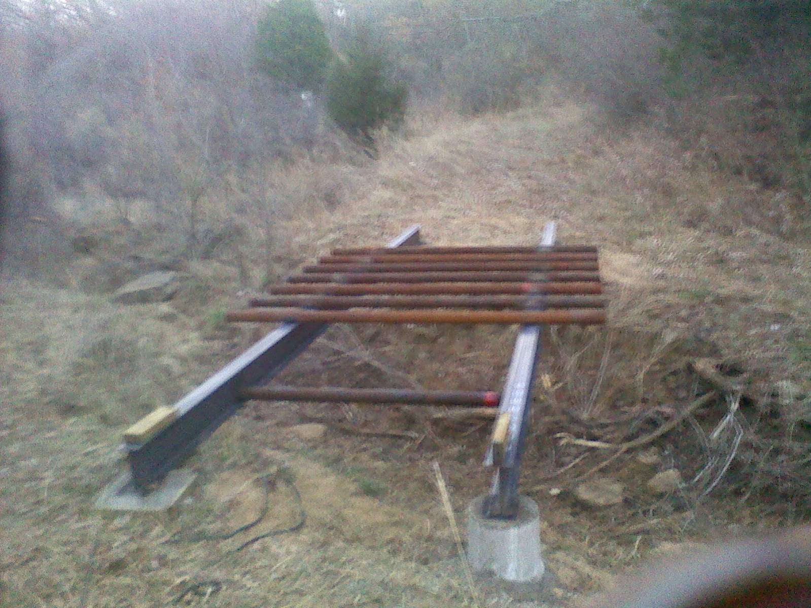

I hope the photos work, taken with my phone. If there is interest I will post throughout the little project.
This is a small bridge I am helping my neighbor build. It only spans 14' over a wet weather creek. He wants to get his small Kubota across to work on a food plot, fill the feeder and such. We officially declared it a "bridge to know where"
In the photo is a view after we had located the best place, squared it up and began digging pier holes for the beams. Hit bedrock on two holes pretty shallow.
The structure it's self will be 8" 10lb I-beam (20') set a 5' apart or just inside his wheel width. The top runners will be 2 7/8" pipe set at "TBD", will depend on what my neighbor wants as decking. Choices right now are welded "catwalk" grate or treated lumber. He is leaning towards the catwalk so we will probably put a pipe every foot. So far the cost at this piont is right at $600, not to bad.

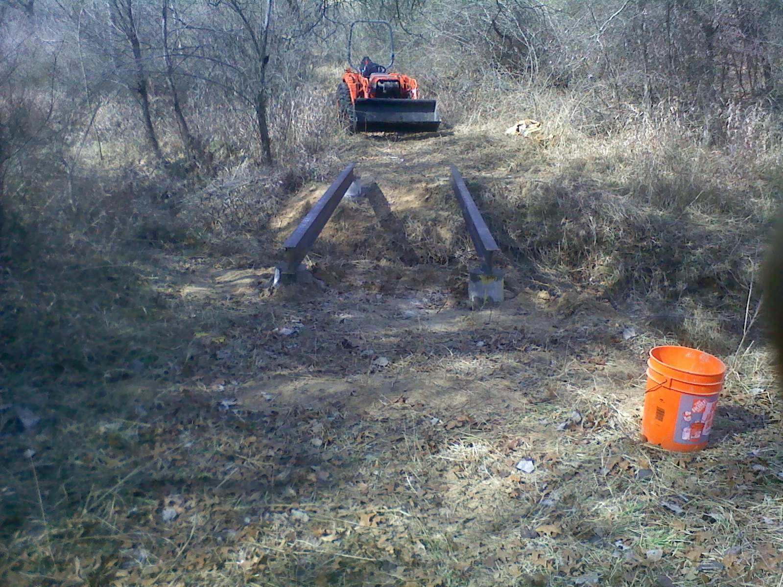

This photo shows the I-beam in place on the piers.
At this point but not in the photo, I have 2 pipe welded near each end (3.5') and I-beam welded to base plates set in piers.
The intention is also to weld a crossbeam crossing under both I-beams parallel with the creek flow, with steel "legs" to the creek floor. This is almost like a raised cattle guard with the pipe set opposite of normal (running width not length)

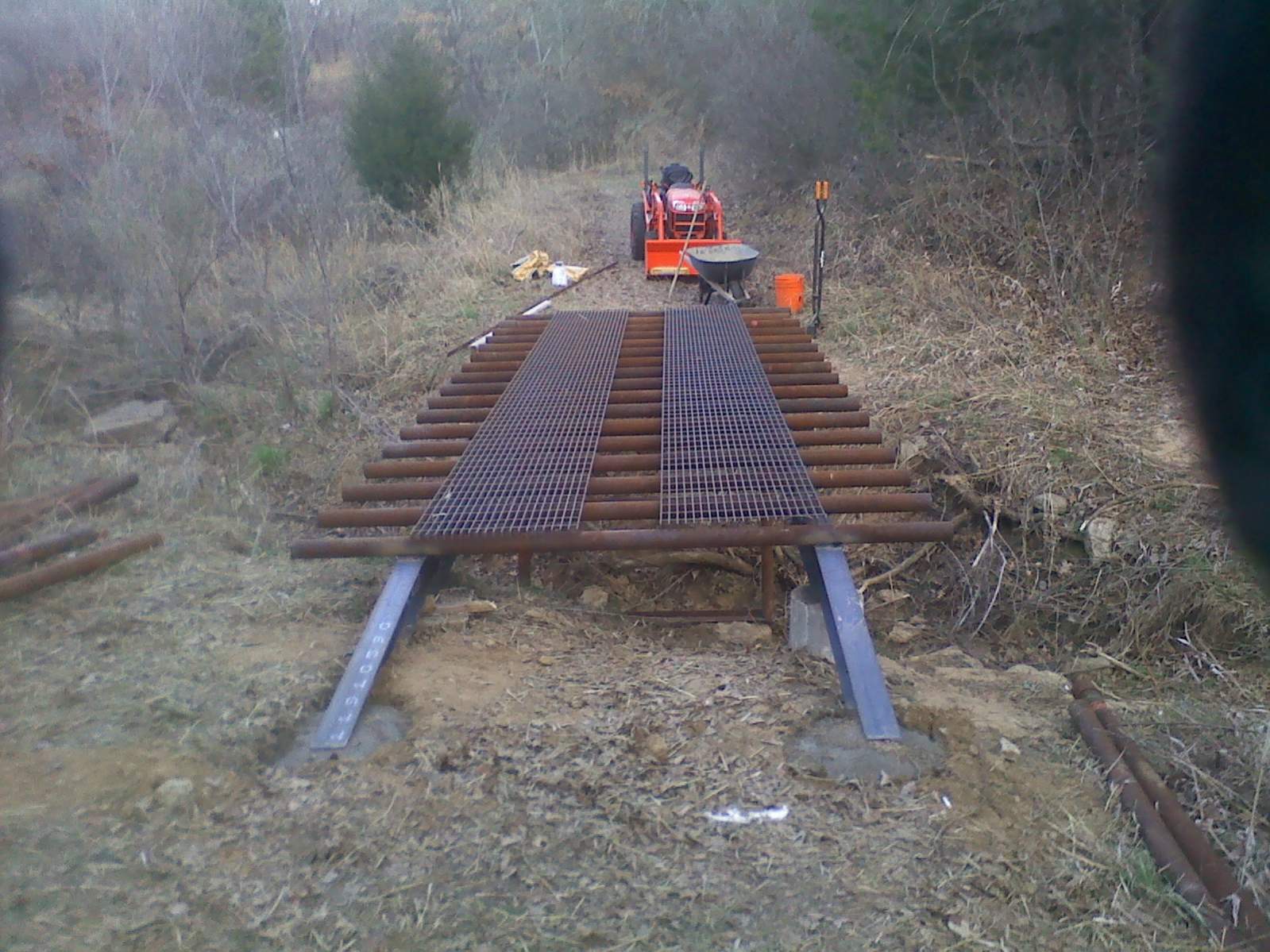

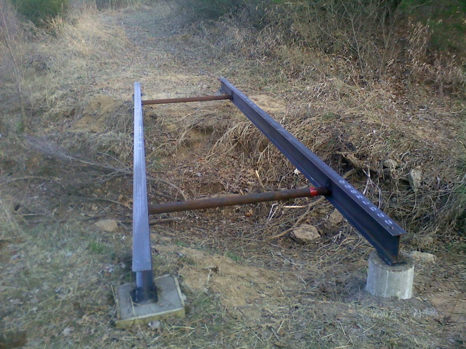

1st one shows 2 of the pipe cross supports welded in with the I-beam welded to the piers.
2nd one is the first few pipe cross overs welded on. We went 12" since my neighbor has decided on the steel catwalk material for deck. This will be a "stout" sucker for sure. Total weight of the bridge will be between 2000-3000lbs approximately.

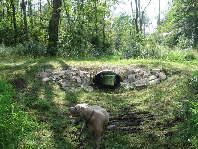

Below is a photo of my "culvert" project from 5 years ago.
I had a County road guy stop by and give me advice on a culvert, also had the help of the bulldozer operator who has put in ALLOT of them.
Since I had such a steep approach from one side I went with a 48" culvert. The dozer operator pushed and pulled dirt to try and mix what little clay I had to build up a base. We placed the culvert and then started with the dirt, 6" increments then water and rolling, (My place is sandy to a sandy loam.)
After that I formed the top and apron with 1/2 re-bar set at 16" center with cement at 8" ( I wanted to be able to take a full cement truck over later) The day after the pour it started to rain, we got almost 15" in 4 days. We where flooded, heck ft worth was flooded. It was 3' over the culvert drive. I am not in the 100yr flood plain and this event will likely never happen again.
And so it sits, my $6500 gorilla. This creek isn't much till it get's aggravated.

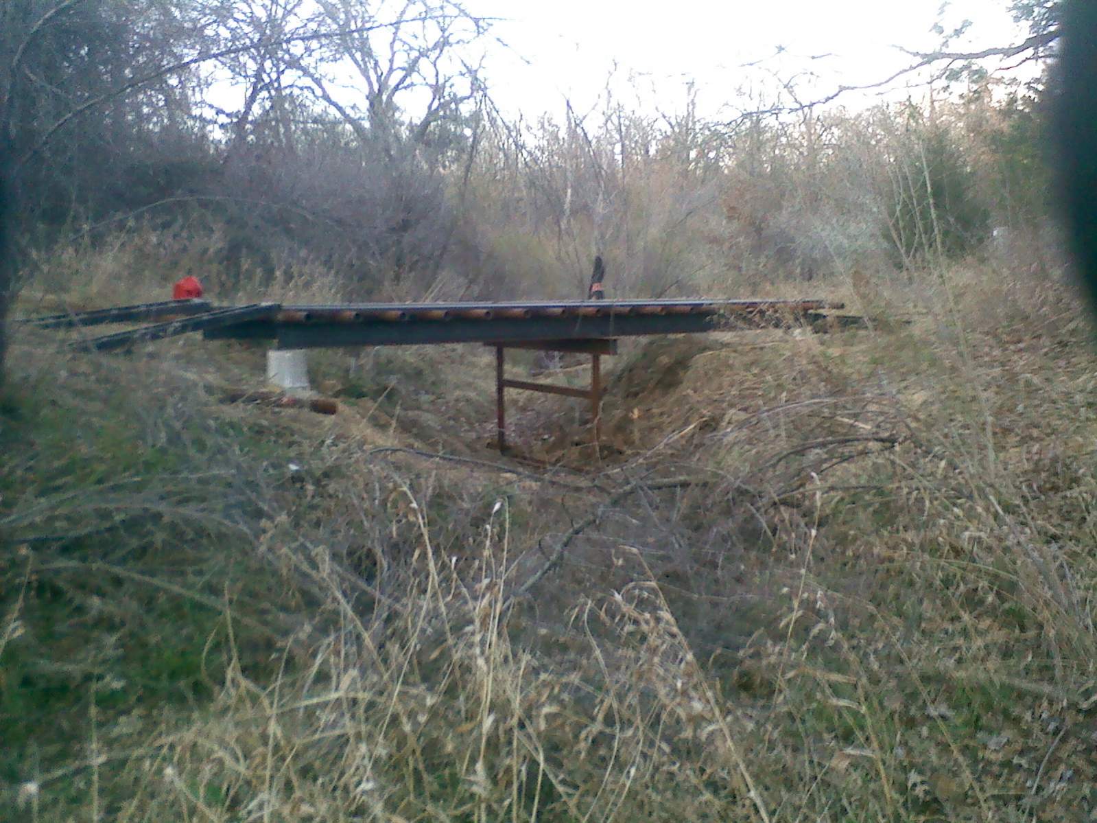

Had some time to add to the project.
We got the center I-beam in, little of the top deck and the approaches cut, welded and concreted. We still need to build the center beam forms and pour around the center columns.
