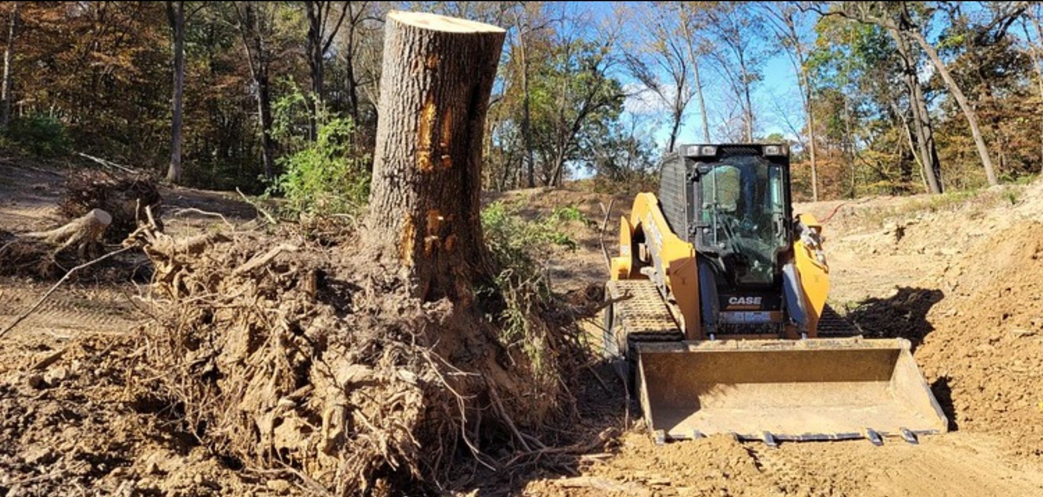

Depends on the skill of the operator. I remove stumps all the time with a standard bucket.
Give yourself some more seat time and you might be able to someday, too.

Like 3” stumps?
Much bigger. You use the cutting edge of the bucket to cut the peripheral roots, then dig under them. Takes a little longer, but it’ll work. I’ve dug out 12-18” stumps and pushed over good sized trees after digging around the base.
I was taught by depression-era people. They did more work with a couple shovels and a couple cups of coffee at 5am than most guys with expensive, fancy machinery that get up at 9am.

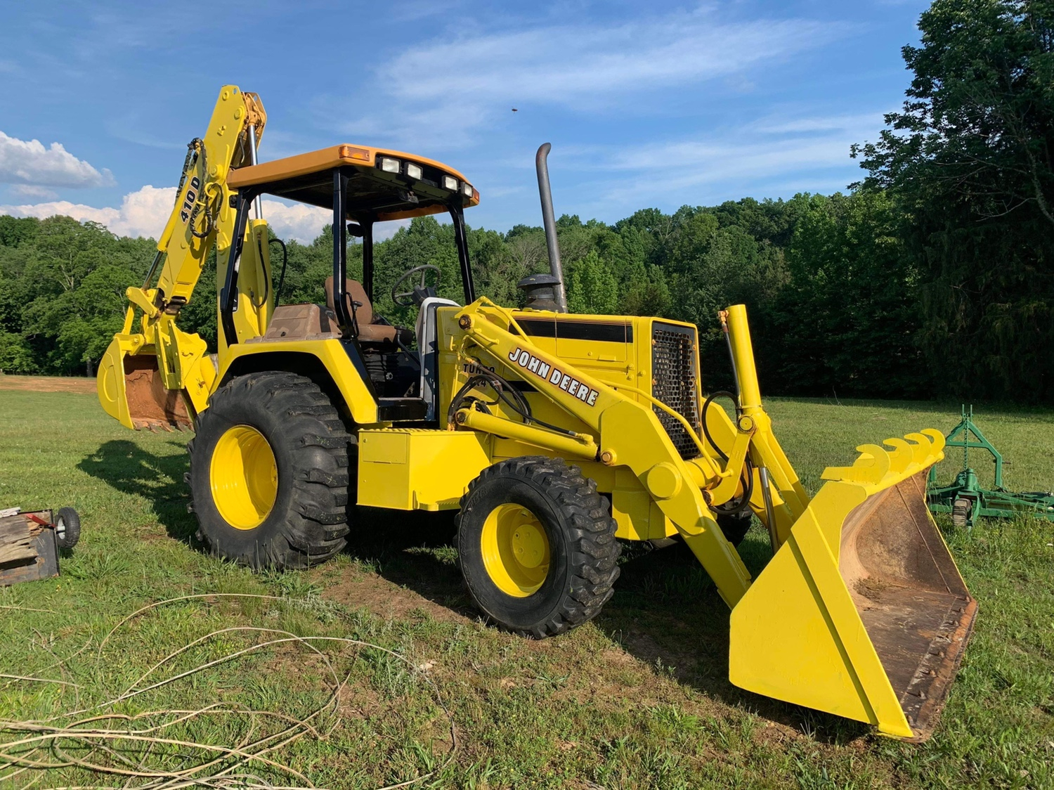

Ralph,
Backhoes are nice on steeper ground since they can be leveled with their stabilizers. Once in place, they can still dig like a champ.
Maybe that’s your ace in the hole for the task?
