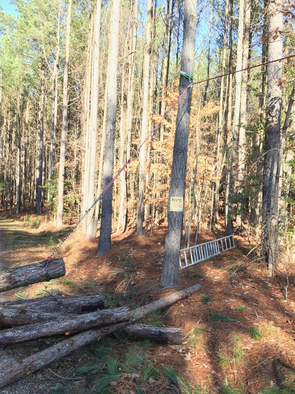

If you have a lot of logs to move from a common area and the path is clear, setting up a fairlead with a bull rope is fast and easy.
When I was clearing a road, I pulled out about 24 pine logs with that rope in a day. Tractor was on our driveway, about 90 degrees to the new road, and I had lots of space to pull (from drawbar of course).

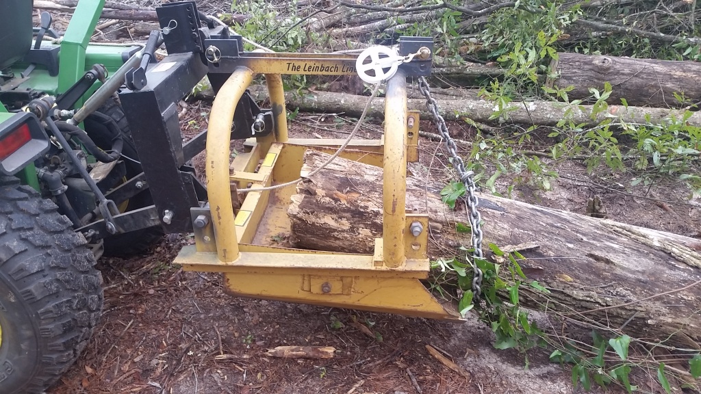

Years ago when I skidded a lot of logs with my smaller B2920, I'd use the skid plate on the 3-pt to lift the butt off the ground with a choker chain, then run a short 2' chain from the choker to the drawbar pull. With that arrangement, the 3-pt provided the lift and the drawbar provided the pull and reduced risk of pulling a wheelie.
