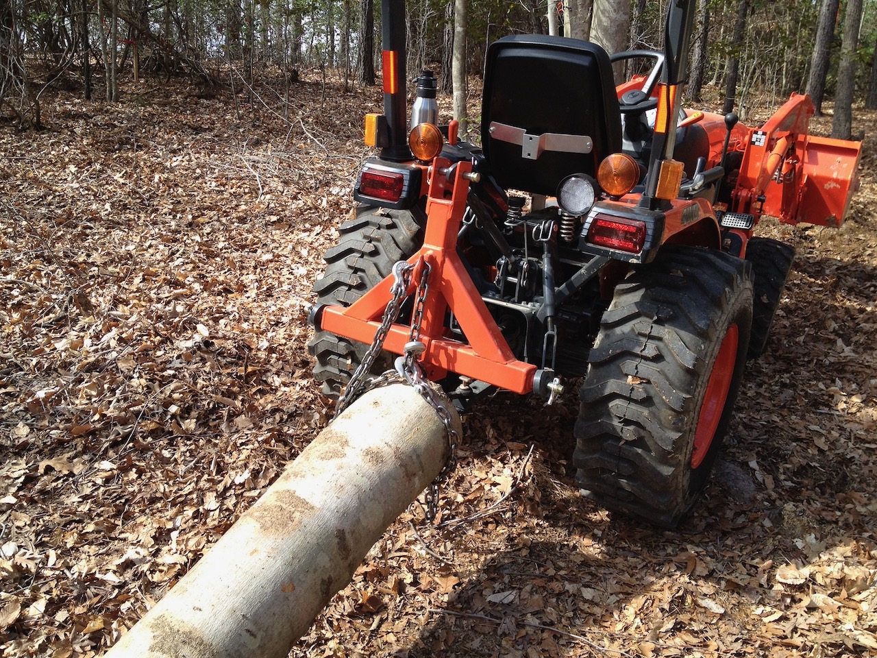

I use a simple skid plate for the 3-pt hitch, that lets me chain up a log (or 2) with a choker chain, lift the butt of the ground, then skid it. This one also doubles as a trailer hitch. Here's a pic on my old B2920, still using it many years later on my L3200.
Many variations on this concept, and could be rigged up fairly cheaply. Lifting the front butt of the log up off the ground is key to skidding with ease.

I have skidded a lot of logs from the bush using a 3pt receiver hitch similar to the picture in post #2, and a hook at the top link attachment point to hold the lifting chain..
You ALWAYS, ALWAYS skid with another chain to the tractor draw bar..
Our old woodsman neighbor estimated some of the logs were about the weight of the tractor.. Again... ALWAYS pull with the draw bar.. Only lift with the 3 point..
Why not pull with the 3 point hitch?
Pulling from drawbar keeps both ends of log in the dirt. All of log in dirt actually, chain saw gets more dull, log more likely to snag a root or stump, log pulls harder, rear of tractor has less weight/traction to pull log.
I agree that you shouldn’t pull with 3 point (or 2 point) hitch with connection point raised higher than axle or tractor can do a backflip. I can see that when pulling with a boom pole, it’s almost impossible to pull from below axle, and flip danger increases.
...but aren’t tractor’s made for pulling with the 3 point hitch (plows for example)?
