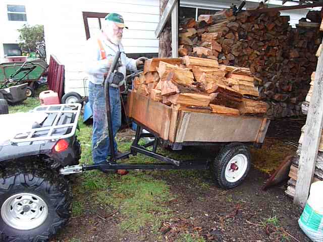

I built something similar. Used all scrap materials, and had the 12v winch. Probably had $100 into it, with the battery.
It will pull a lot behind a small 4 wheeler, would work great behind a tractor.
Now I can't find the picture. But if you check out this site, it gives you a good idea.

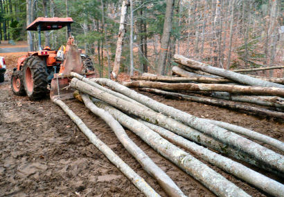

Here's a pic of mine. I'm doing a 25 acre lot on the side of a mountain. Kubota 4150 with a Farmi 501 winch. Tire chains on all 4 wheels and forks on the loader. Excavator at the landing to load and stack logs.

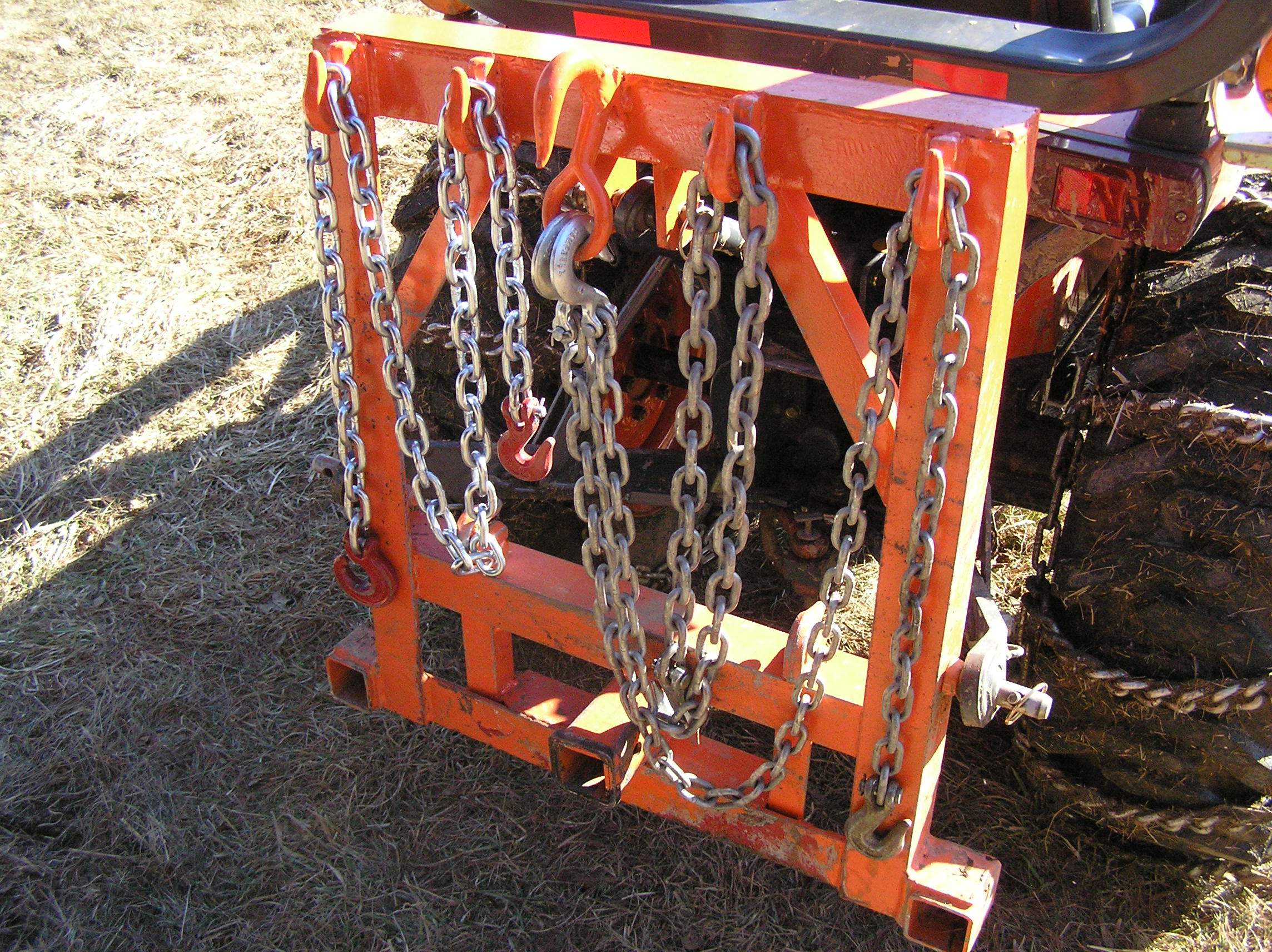

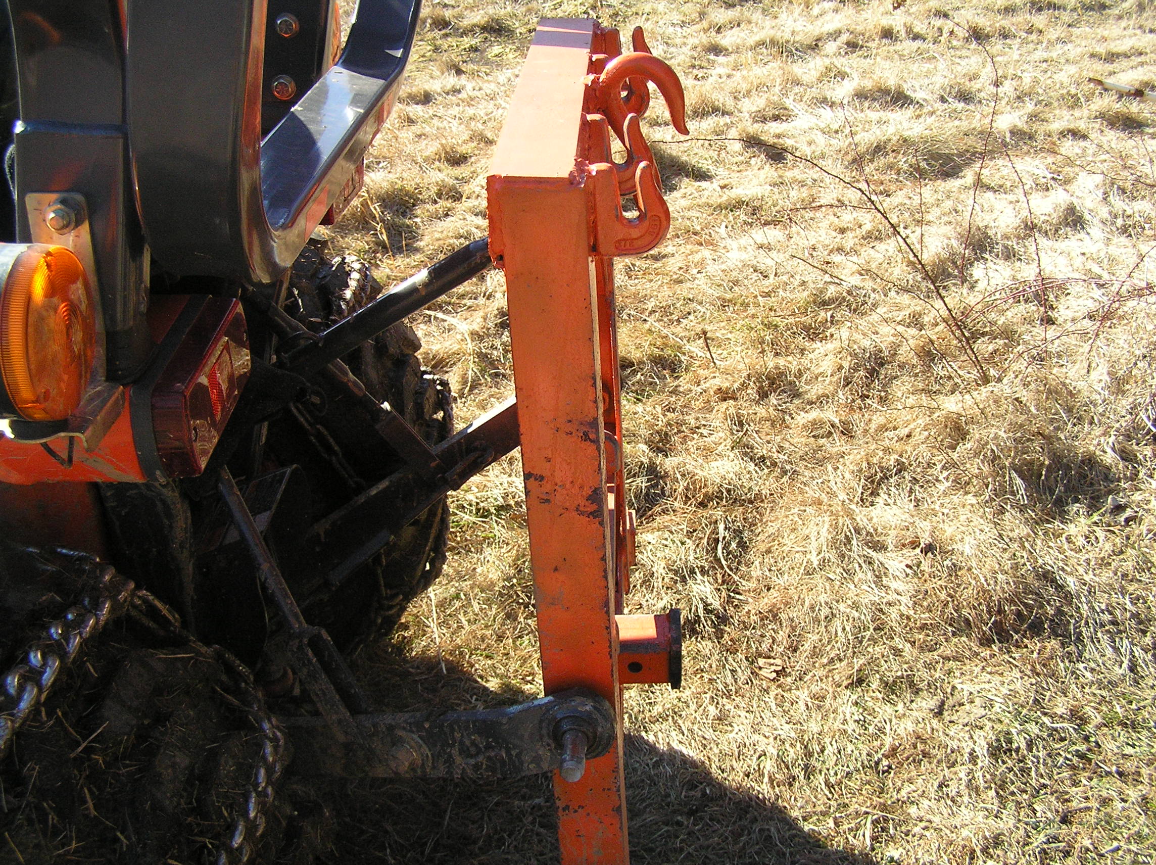

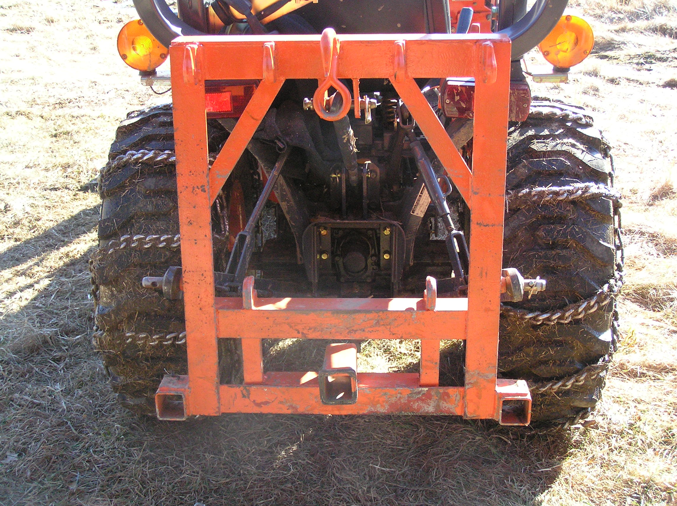

I just came up with this skidding hitch. Works great on my B7500!

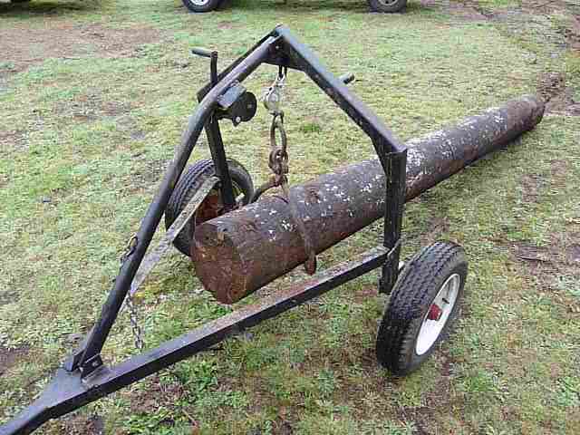

I most likely posted this in here somewhere. I built one of these several years ago for my 336D yanmar. Of course it was much larger.
The principle is the same and it worked well then and does now. As you can see it doubles for a trailer and an arch and doesn't cost a fortune.
As far as getting logs without getting off the tractor, well convenience costs money. They have hyd grapples that hook to the 3pt that are in the thousands.
for those that have seen these pics bear with me.
