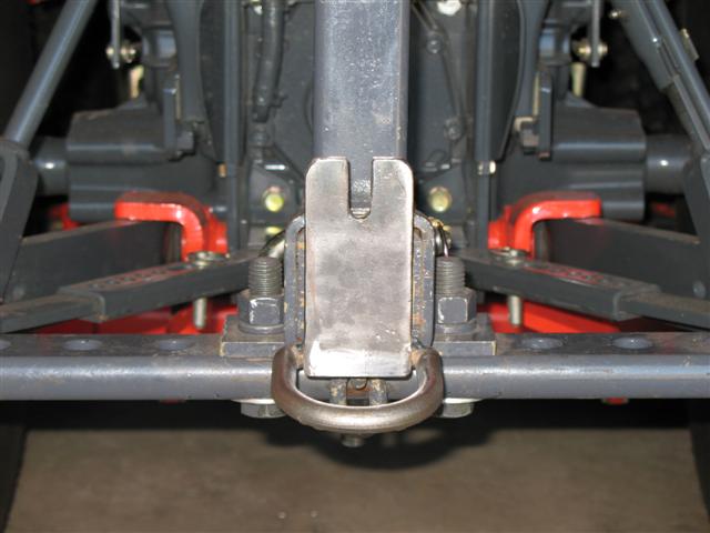

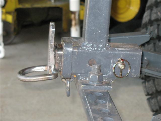

Wow! This thread has been around a long time now. Earlier in the thread I described how I used a hook under the drawbar to lift logs with the 3PTH. Since then I have come up with a new way that I do it now. I made a device that slides into my receiver hitch that works much better than the hook under the drawbar method. The pictures below tell it all. The flat stock that is welded to the 2" square tube is 3/8" thick. The D-ring is 1/2". Works like a charm. Gets the log up higher and is easier to hook and unhook the chain to the tractor. This was the first log I pulled with it. I wrapped the extra chain around the hitch on that one. After that I just let the extra chain drag along. Saves time and doesn't bother anything.
