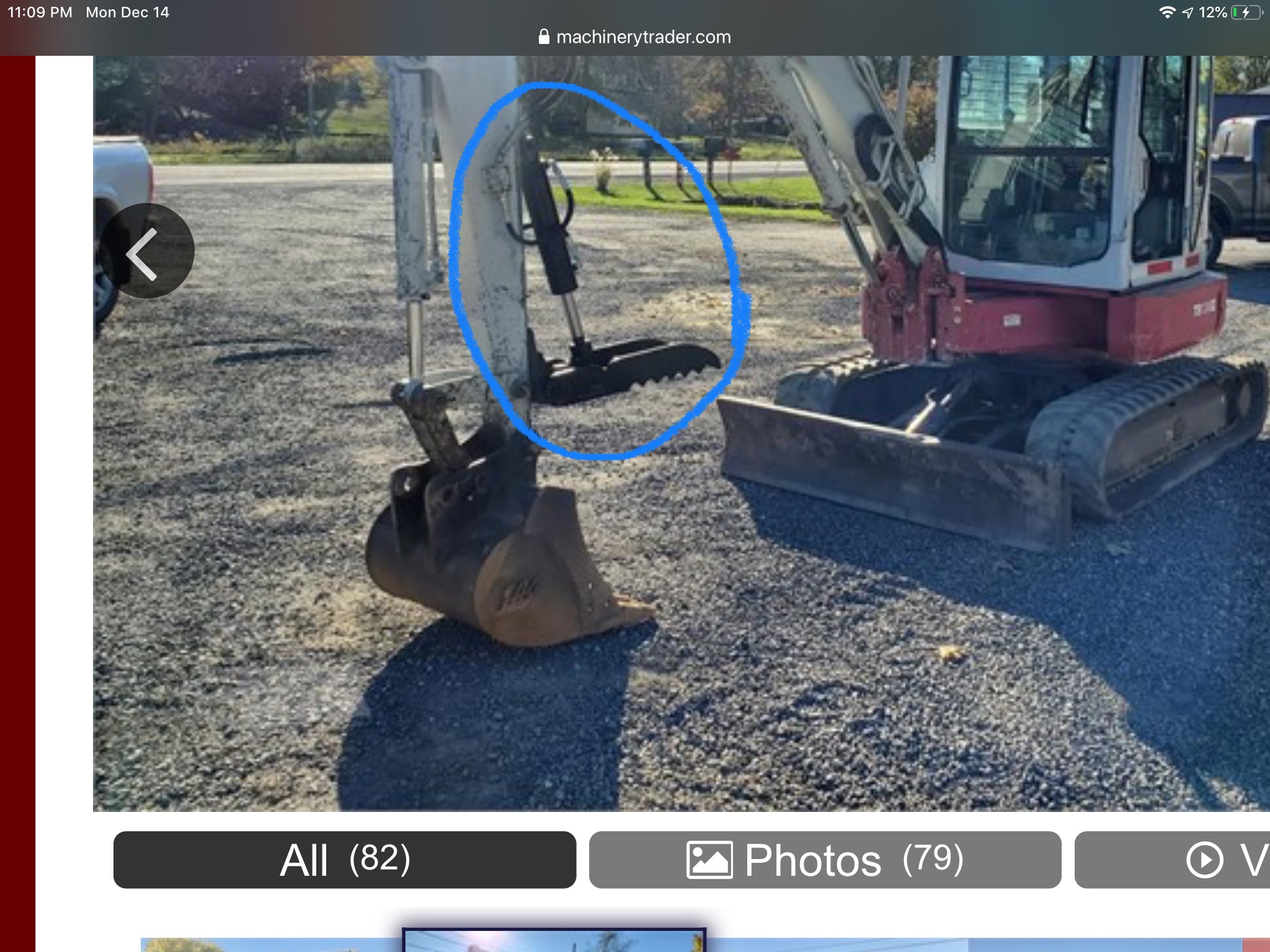

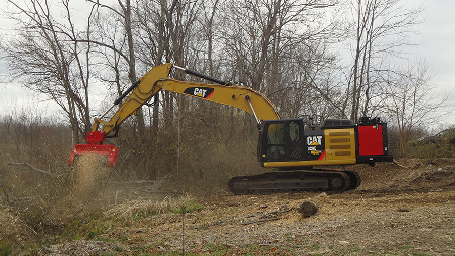

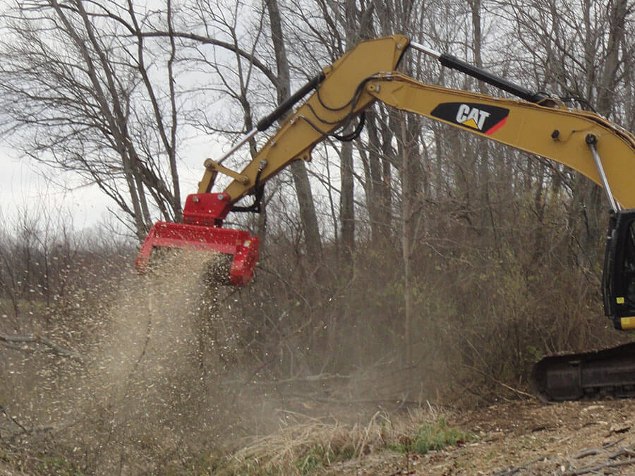

Sure you can mow/mulch with an excavator or track hoe, whoever told you that you cant? They are the best land clearing tool money can buy.
https://www.google.com/url?sa=t&rct...rs-backhoes/&usg=AOvVaw0nV13KtFckVS020zNRj4Um
https://www.google.com/url?sa=t&rct...=ja9pIS2ED24&usg=AOvVaw3hPPBiM-MKgcIquzGKQ3aE
A thumb is like a claw mounted down by the bucket so you can grasp trees, stumps, rocks, etc
