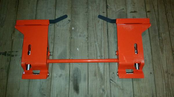

A Euro loader coupler is by far better but getting away from SSQA isn’t really easy. Most people that have euro loaders end up buying a SSQA to euro adapter.

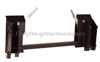

By far and most of the times can be built a lot lighter than the SSQA and still be way stronger and of course, safer, a lot safer.
When you get the hydraulic attach version of global, it’s simpler than the hydraulic version of SSQA, too.
/ Skid Steer or Euro loader attachments? #48
Indeed it is. Simple cylinder in the middle and it's good to go. There are some universal cylinder kits available too. Sometime ago, I found them on a German website with a very reasonable price.

Yes, but along with that, on the global, the pins just shoot straight outward into holes. On SSQA, there are wedges that are more prone to misalignment. After running both for decades, I’ve found global is stronger and simpler.
SSQA is fine, too.

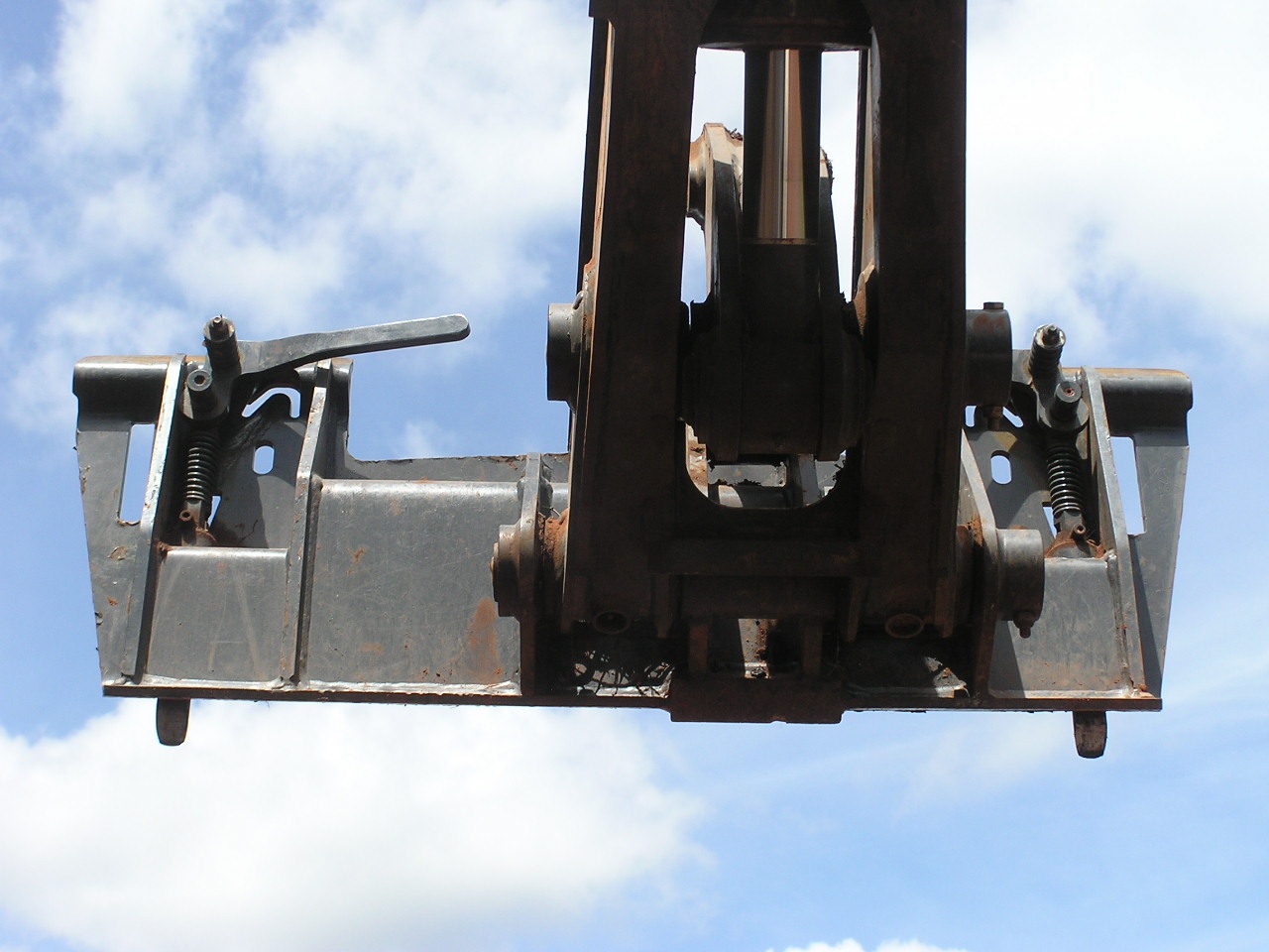

Just look how many threads about bent SSQA frames there is on this forum alone, let alone all the others. Most of them caused by on side of the attachment popping out because.
The Euro quick attach provides a positive lock. Pin slides into the holes on the attachment with long and strong hooks on top. It just won't come out.
I'm sure SSQA is fine but I wouldn't trust it a single bit.

Won’t come out once engaged. What if they don’t?
The locking wedges are a decent design, the operator needs to make sure the pins are locked. Unfortunately quite a few don’t. In my experience, the bent frames are from operator inattention. For whatever reason, the attachment was loose and the wrong forces were applied to make things bend. 1/4” (6.3 mm) isn’t hard to bend either.
BTW, hydraulic connection qd’s don’t pop off when the attachment falls off either.

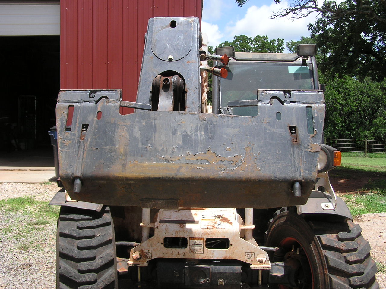

If the pins are not engaged, the top hooks on the attachment will just pivot on the top bar of the quick attach, even if you try to full dump. You need to set the attachment on the ground so you can take it off the loader. That's why it's so safe even if it's not latched.
And yes, I've read loads of threads over the years about SSQA failure. A lot of them happened even with the wedges properly latched.
