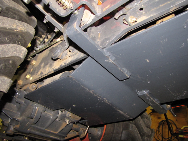

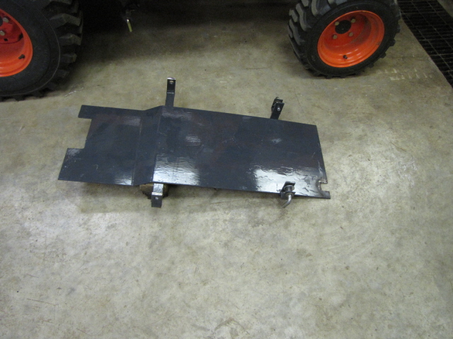

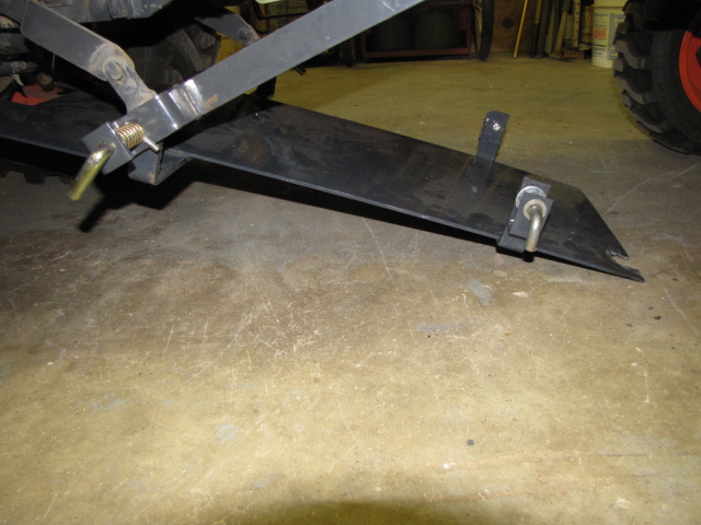

I have made 3 of these and they have worked out real good.
what are the front pins locking into. don't recall any holes in that area but i have not had a chance to get under there to get closer look

There is 2 holes up there, they are just a hair under 1/2". I used 1/2" pins that are spring loaded and can lock open just like the mower deck has. It goes up and down with the tractor hyd. and when you set the mower knob to top and drop the 3pt, it comes down a little, then it is about 1/4" from the frame.

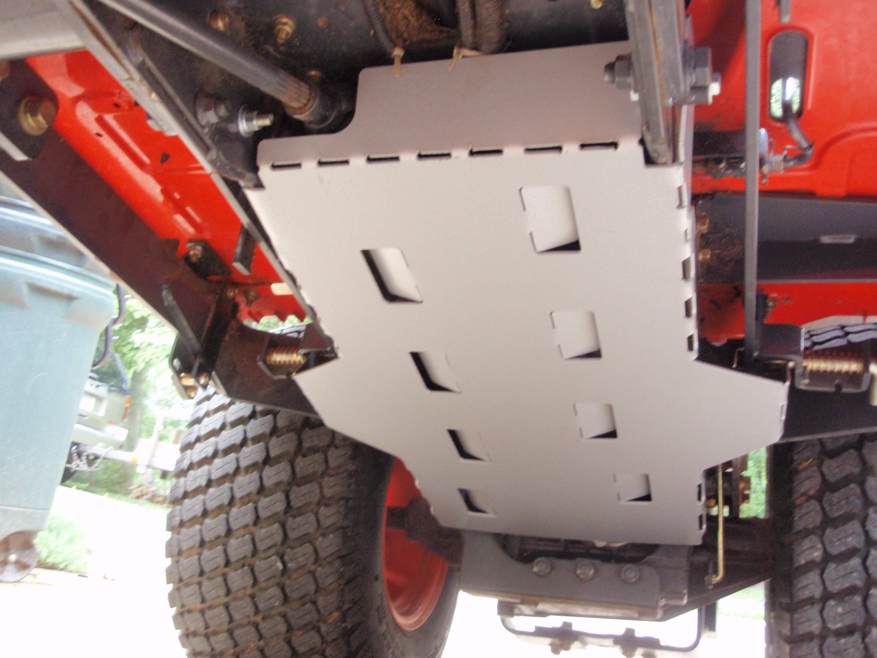

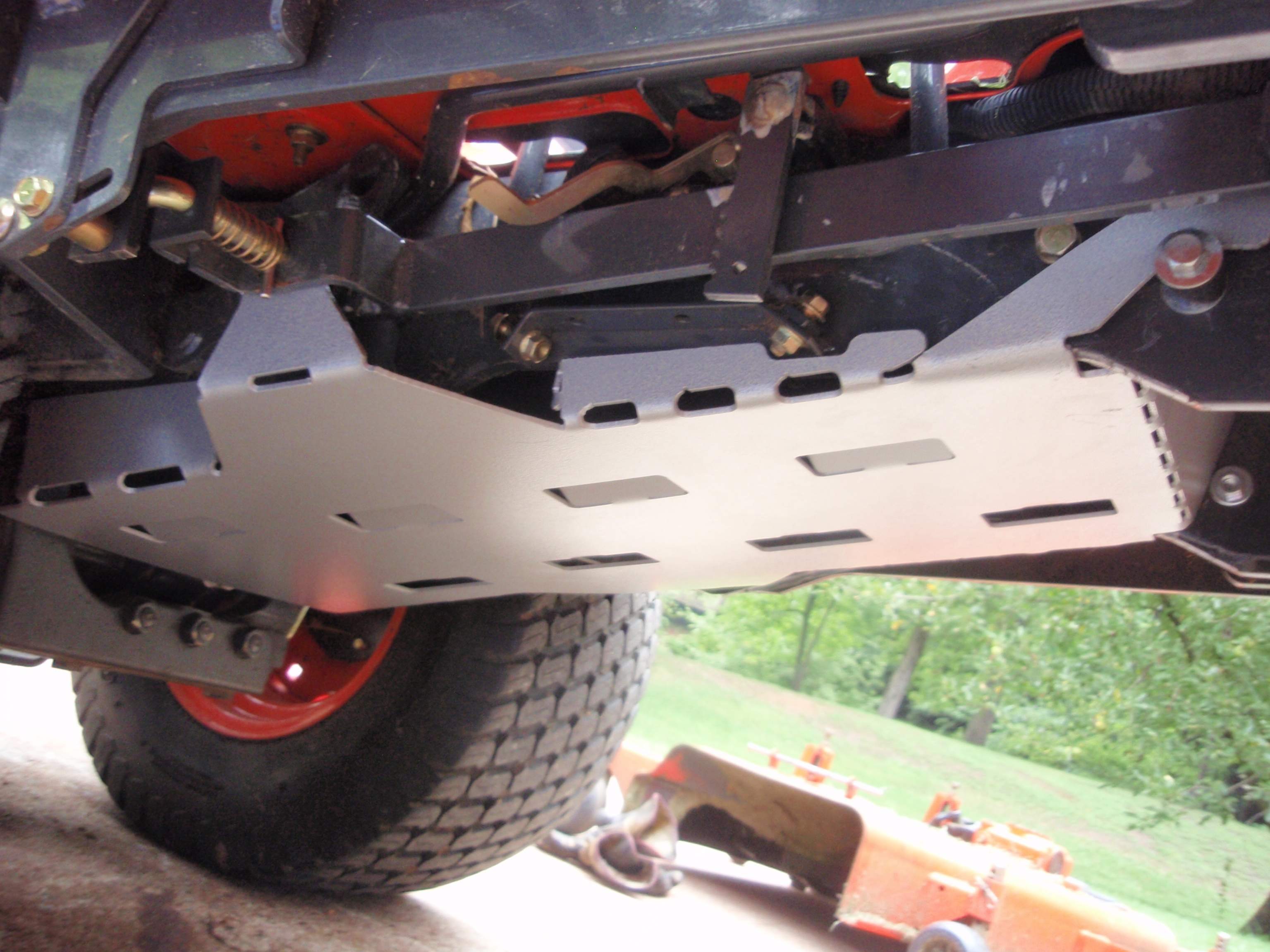

The BXpanded Under Armor is available, but still not on the website. We are in the process of updating some of the "Back Office" software and that's the hold up. Fits BX1850, 1860, 2350, 2360, 2660, BX24, BX25. No drilling, installs in seconds with no tools.
Here's pics though.
Email us contact@bxpanded.com
We wish everyone a very happy and safe holiday and a great new year!
Harry

I was curious as to the function of the rectangular stamped holes with the stampings bent inwards? Is this to done to allow air circulation?
/ skid plate for bx2660 #15
Yes. It's designed to allow airflow while still preventing sticks and such from getting to the fragile HST cooling fan.
