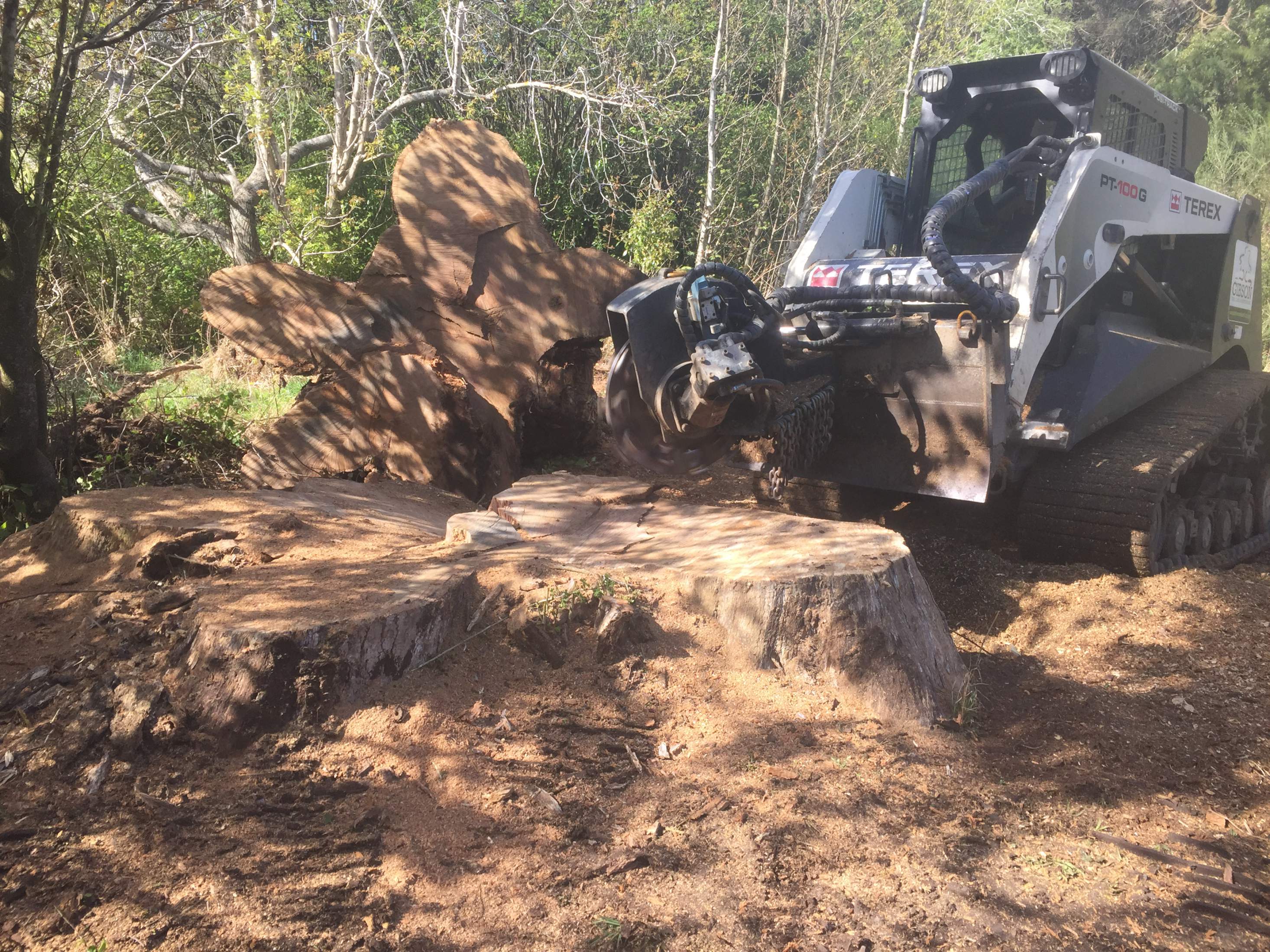

we don't really have a lot of options in this part of the world unless you want to import so I built my own.I think hi flow hydraulics is the key to getting through alot of stumps fast and recovery time when the wheel slows.I did look at the millers but we had a time crunch so built one and have about 600hrs on it with no issues.

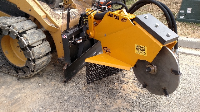

Here is a pic while it was still new and clean. We also bought a Woods PTO stump grinder that we will run side by side with the Miller unit. I will post pics and reviews of both at the end of the week as they will get plenty of run time.

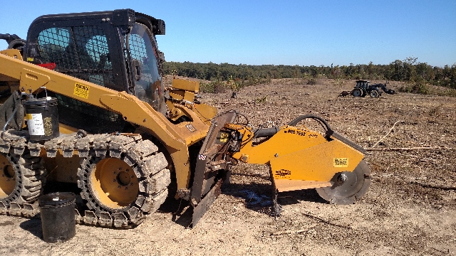

The Miller had so many problems in the first 35 hrs that they want it sent back to them, with no concern for the job that we need to complete . From what we are finding out the Miller was bought out by the Stonebrook group and quality has gone out the window. It was supposed to come from the factory ready to hook up to our Cat machines. Not only were they not wired for the Cat machines but they were half assed wired ! They tried to blame the wiring on our dealer that we bought the unit thru. So a few hundred dollars in micro electronic crimpers and pins later we now have 5 out of 6 functions. Then all of the hydraulic fittings were marked as tightened yet they all leaked, Every single fitting ! Then we think we have it up and running for a bit only to have two o rings blow out at different times at the fitting block and dump all the fluid out of the machine twice ! And the final was the wheel is scoring the housing on the drive pump and we believe the wheel has a crack in the weld. We have pics of all of the problems. Nor does the wheel seat to the hub properly. Their only answers were to send it back. I'm going to send it somewhere alright ! Our only contact is a guy in customer service who tried to do his job but it is obvious that his hands are tied
As for the Woods, it has been our saving grace , fingers crossed. Here is a pic of the miller dumping oil while the Woods continues to work

@Marek. Firstly, I take responsibility as an owner of ArborWolf, and apologize for your issues. Secondly, we would like to do whatever it takes to resolve your issues, so that you can give your Miller a glowing referral. As discussed, we would like to pick your unit up and bring it back to the factory to resolve its issues. When we talked on November 6th to arrange pickup, you were unable to give the unit up because it was in-use on a large land clearing job. I will email you soon to get an update on when we can pick it up.
As you noted in a later post, this is not consistent with the well-known quality of the Miller products. We purchased Miller in early 2015, and tried hard to make it a seamless experience for our clients, to that point that we retained the long-standing manufacturing processes, machinery and manufacturing staff. I feel bad that we've failed you, and look forward to resolving your concerns to your satisfaction.
