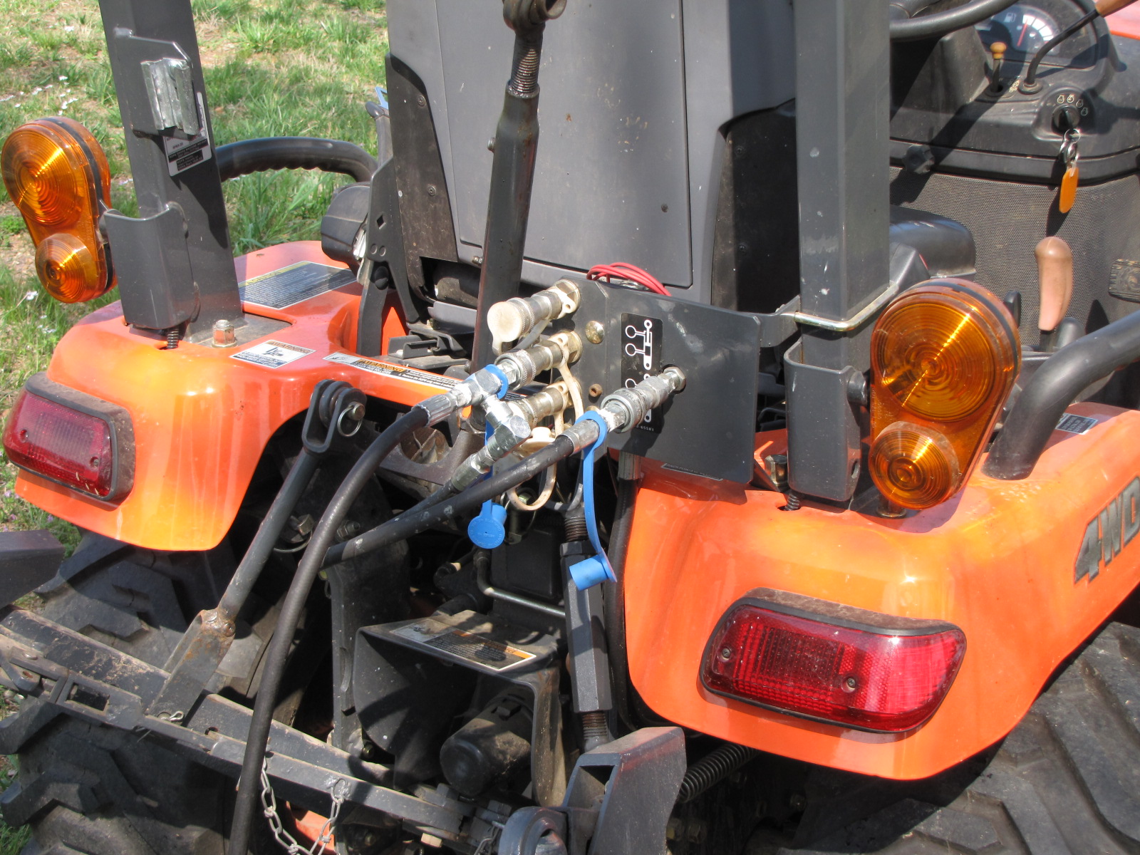

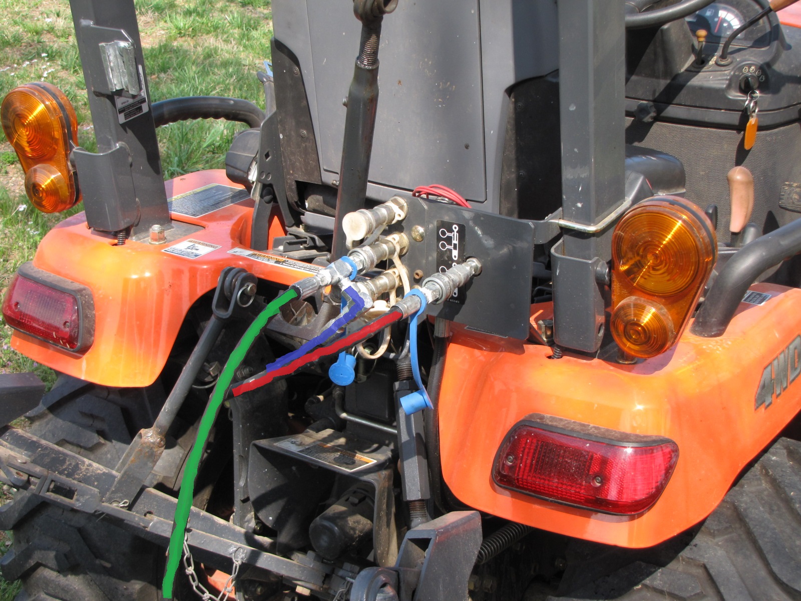

Blow this picture up and you can see how I did mine. I use a 12v off and on valve, tee into the tank return line. Just flip a switch and it comes down and if you forget to switch it back it well not dump. I didn't like my relief valve sound off while the bed was comeing down and it was slow.

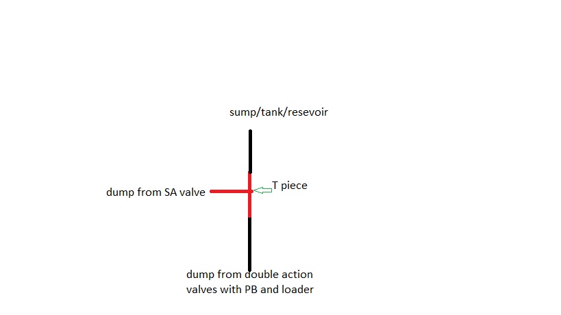

have a look at attached picture where i have done some very fine artwork as an overlay to your photo! :p
can you tell me what the red, green and blue pipe are?
I am guessing the green pipe is the supply to the trailer coming from the A port? the blue pipe would appear to be tapping off the green pipe with a T piece? is it at this T piece that your electronic valve is so that the oil heading back to the valve to be dumped goes straight to the dump line?
Cheers Ed
Green is to the dump cyl and the blue and red are the same hose. The valve you can just see the top, it where the red wires are right behind the coupler.

we already have trailer with a fine working SA ram, do you think it would really be worth jacking up the trailer bad and ripping out the old SA cylinder and replacing with DA of same specs?
in any case i think i might just do as in my above diagrams if someone can confirm this would work as in a few years time i am looking to probably get some hay making gear and a lot of that uses SA cylinders, this would give me 2 DA remotes and 1 SA remote. cost more to set up but the best setup in the long run i reckon
