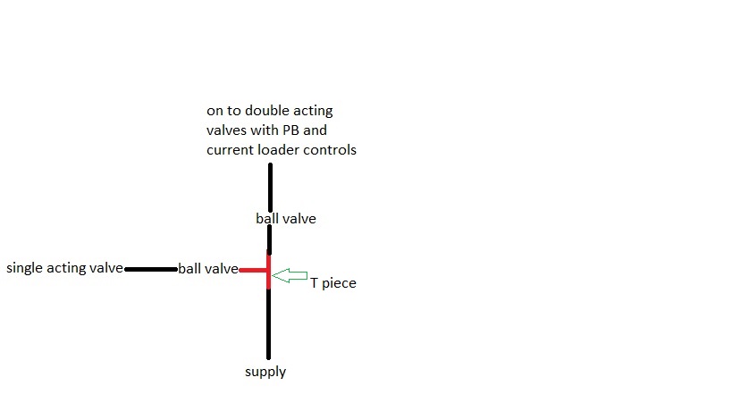

when you say stacked valves do you mean like this?
i would install a 2 valve block like the above of DA valves and then a single SA valve separate for things such as the trailer and lowering and raising SA mowers

actually scrap what i just posted above, i'm pretty sure that's still not a stacked valve
Cheers Ed

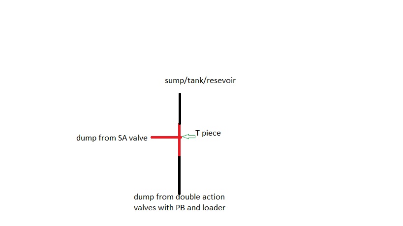

/ single acting #28
Do you absolutely need a SA valve with only one work port.
A DA valve will do the same thing after plugging one p ort.
There are plenty out there.
https://www.google.com/search?q=ces...a=X&ei=Z_NkVNOhK8eogwTgmoOwDg&ved=0CAYQ_AUoAQ
It is just too easy to convert a DA valve spool to SA by plugging one of the work ports, or running the unused workport to tank.

also is the dump line under pressure, would i need a check valve on any lines T'ing into the dump line to stop other oil being dumped going up the pipe T'ing into the main dump line, if this makes sense? can do a basic diagram if it helps?
Cheers Ed

Yes, that is a stacked valve.
You can see the bolts connecting the spool sections together.
