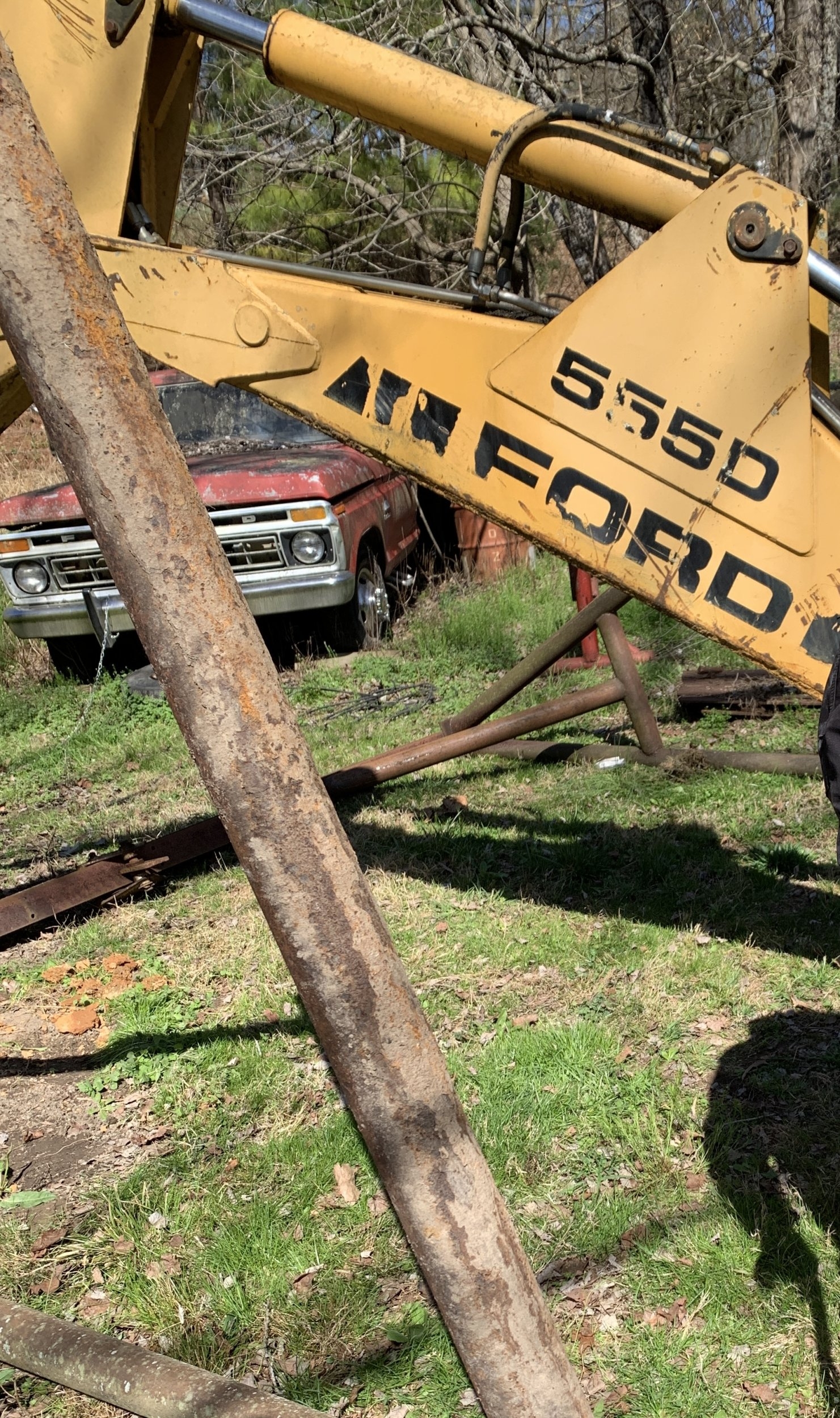

Hi all, hope one of you can help me.
I have a 1994 555D Ford backhoe and when I have been using it anywhere from 20-30 min the shuttle shifter stops working and it won’t go forward or reverse. After it cools down it can be used again…. What is causing this? It’s a real pain and can’t get much work done…. Any help or advice would be greatly appreciated.
Thank you!
