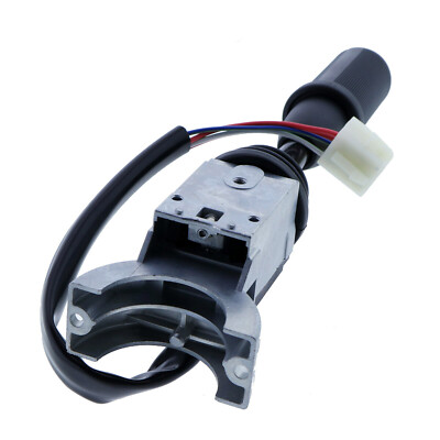

Hey, all. I'm wondering if anyone has a solution for shuttle shifters that aren't the $700 OEM replacement
The issue is totally with the shifter stalk itself. It's pretty intermittent with both forward and reverse and jumps out pretty often. I had become accustomed to simply holding it in place but now that's also sporadic at best. I've had it apart and tried to reshape the metal that actually completes the circuit on the contacts, but it's not much better.
Any ideas, or do I just bite the bullet?
Thanks!

Technically, it’s just a toggle switch on/off/on (plus lockout?) would take a little splicing and fabbing ….
/ Ford 545D shuttle shifter woes #4

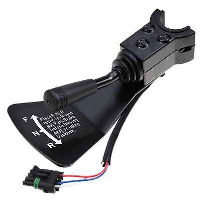

This will work for that shifter. You may have to rewire, but that isn't difficult.
Chinese import
If it has the 8x8 transmission with lockout, you could put an extra button somewhere else to activate. Most people don't use it though
This one might be best:
