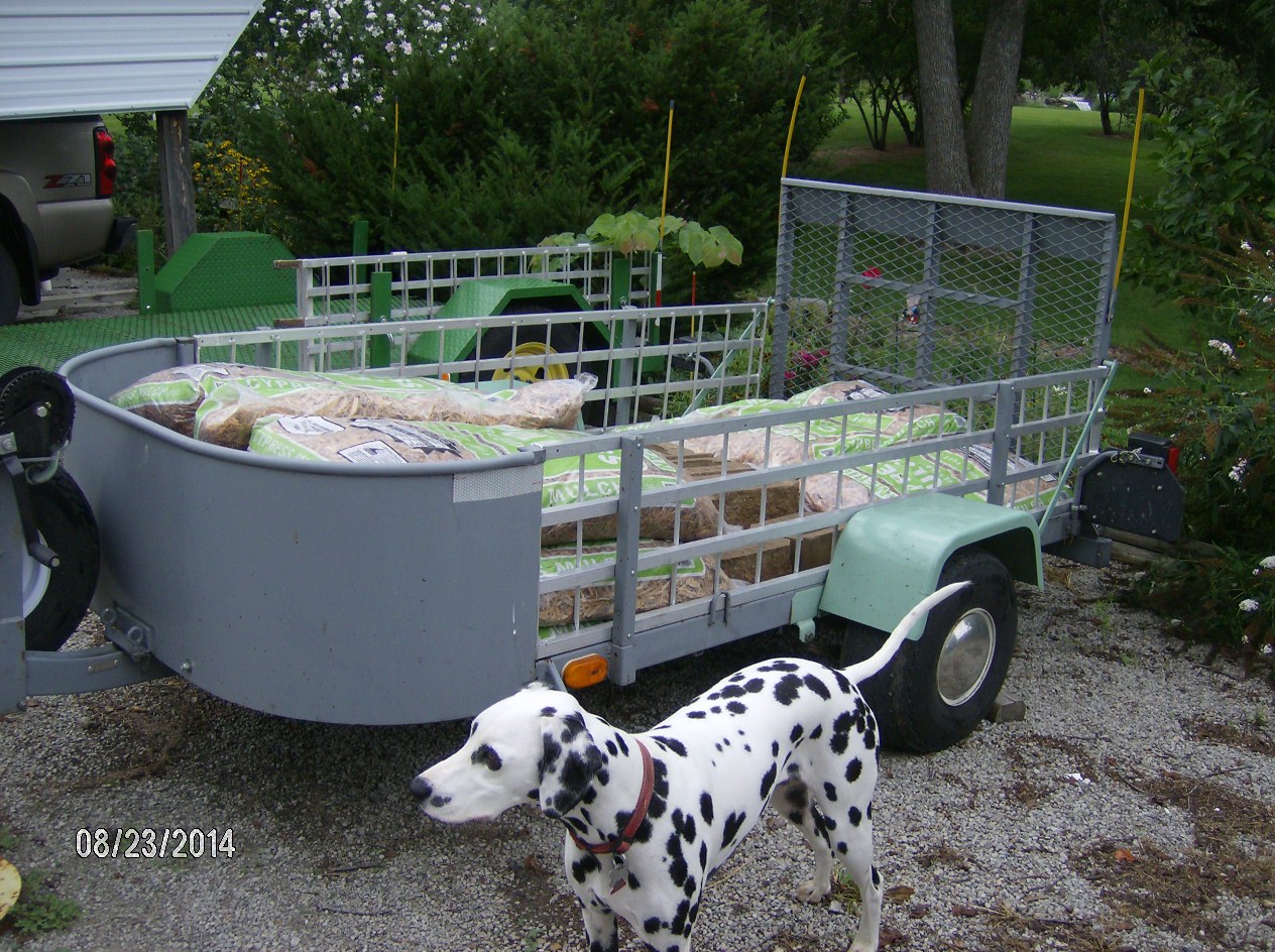

I showed the sides for my 16' trailer early in this thread. Here are the sides for my 10' trailer, wood slats for the front sides & ends, ramps for the rest of the sides: HPIM3264.JPG
The 4 x 8' Snowco just uses aluminum ramps: HPIM3162.JPG

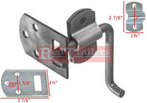

Here are two external style sideboard latches:
Same ones I used. I also had the straight version of the corner brackets to join 2 pannels together. Dont remember if I used the straigh or angled sliding bolt latches. Same thing only has the non moving bent 90 or not so you can install them on a corner or straight, depending on where your mounting post is.

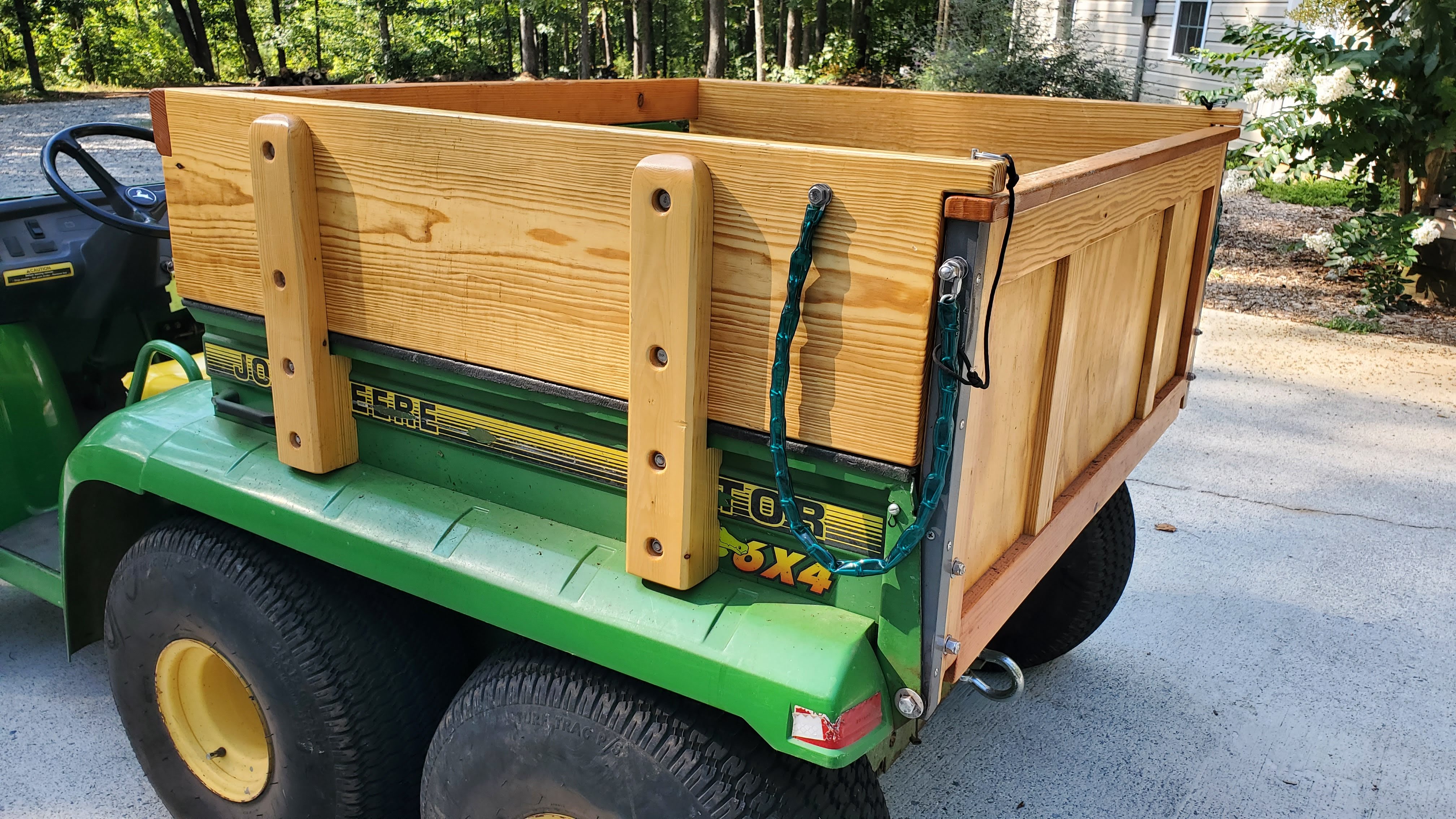

Not quite a trailer, but in the same spirit:

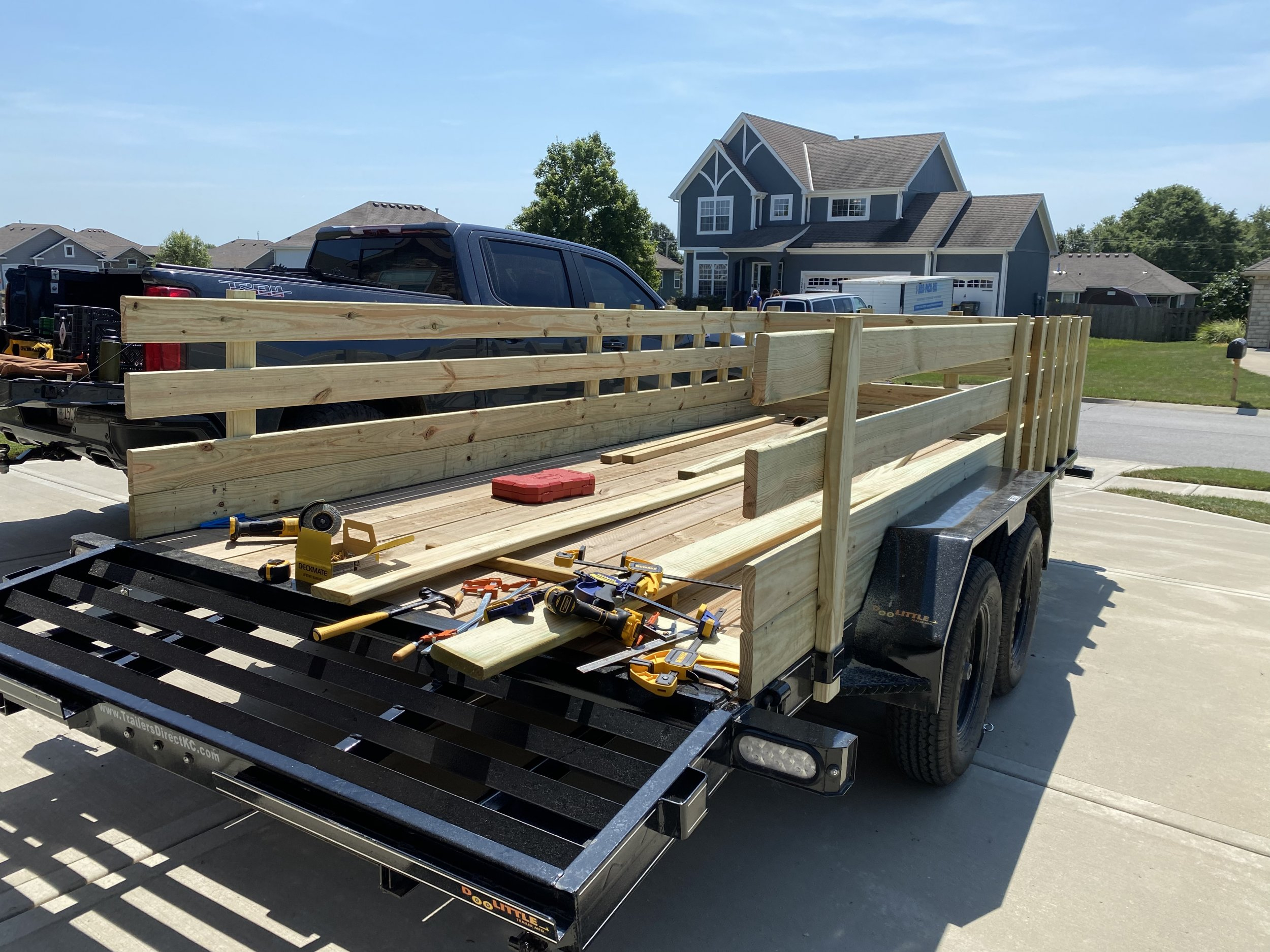

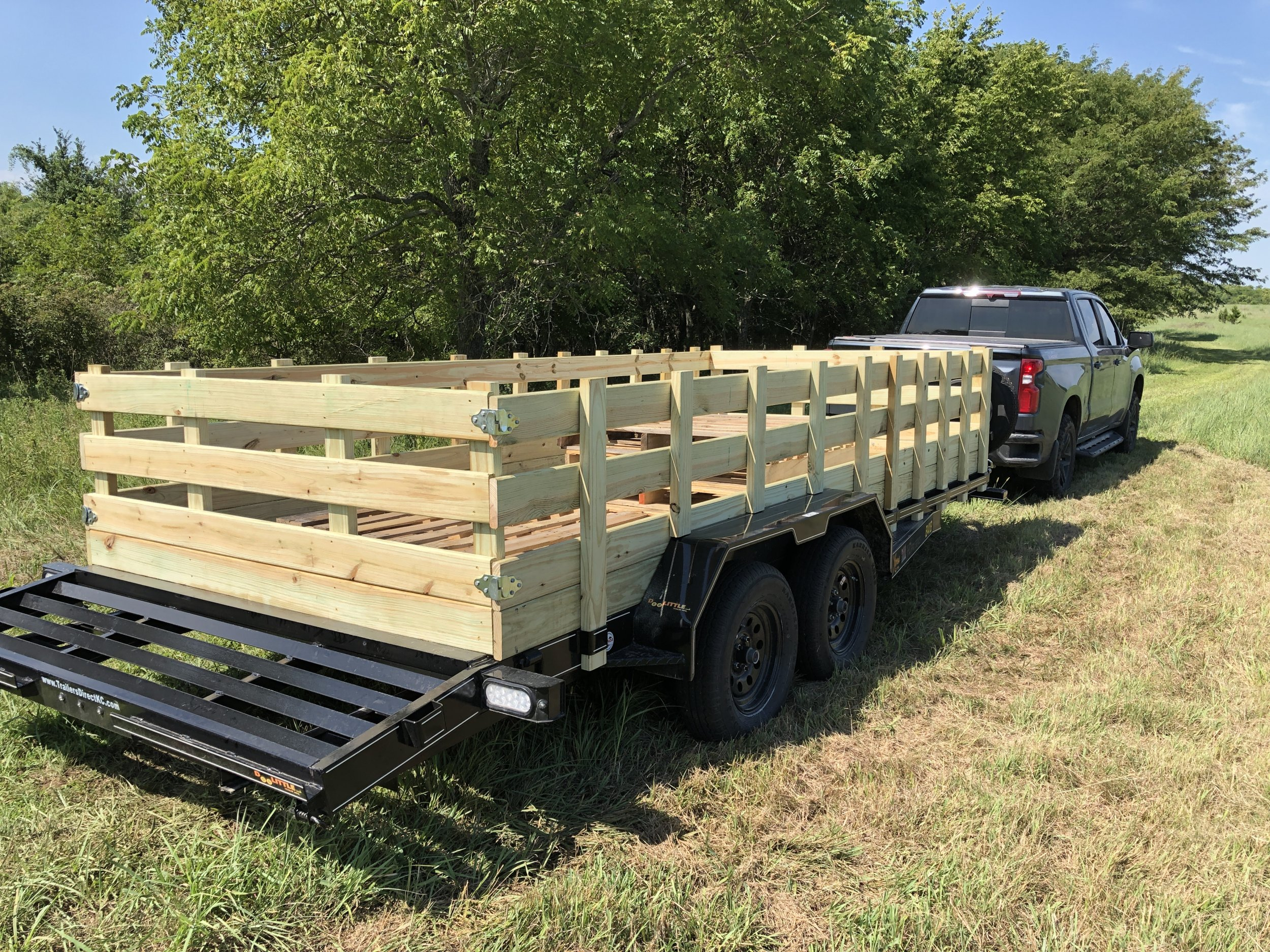

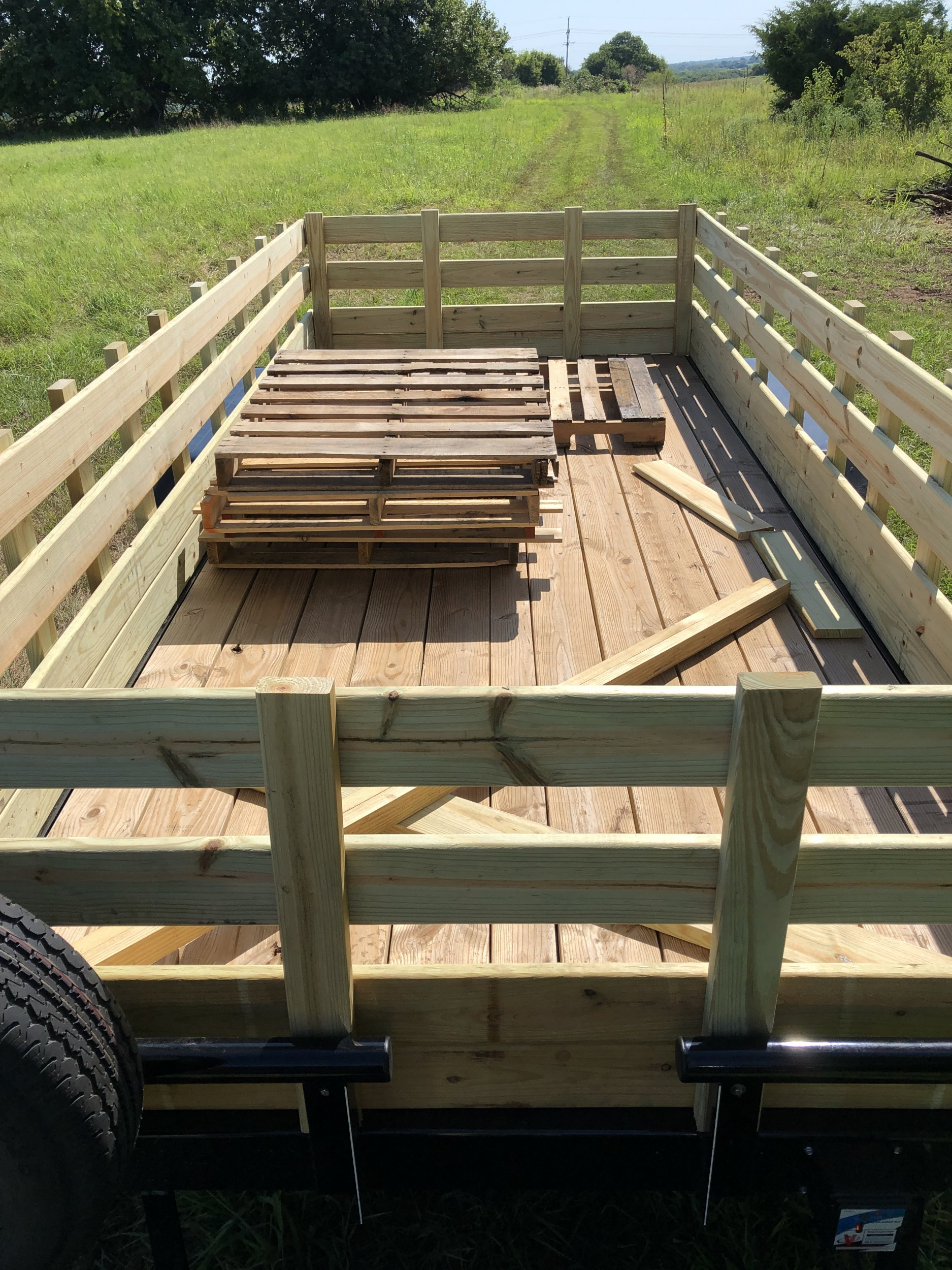

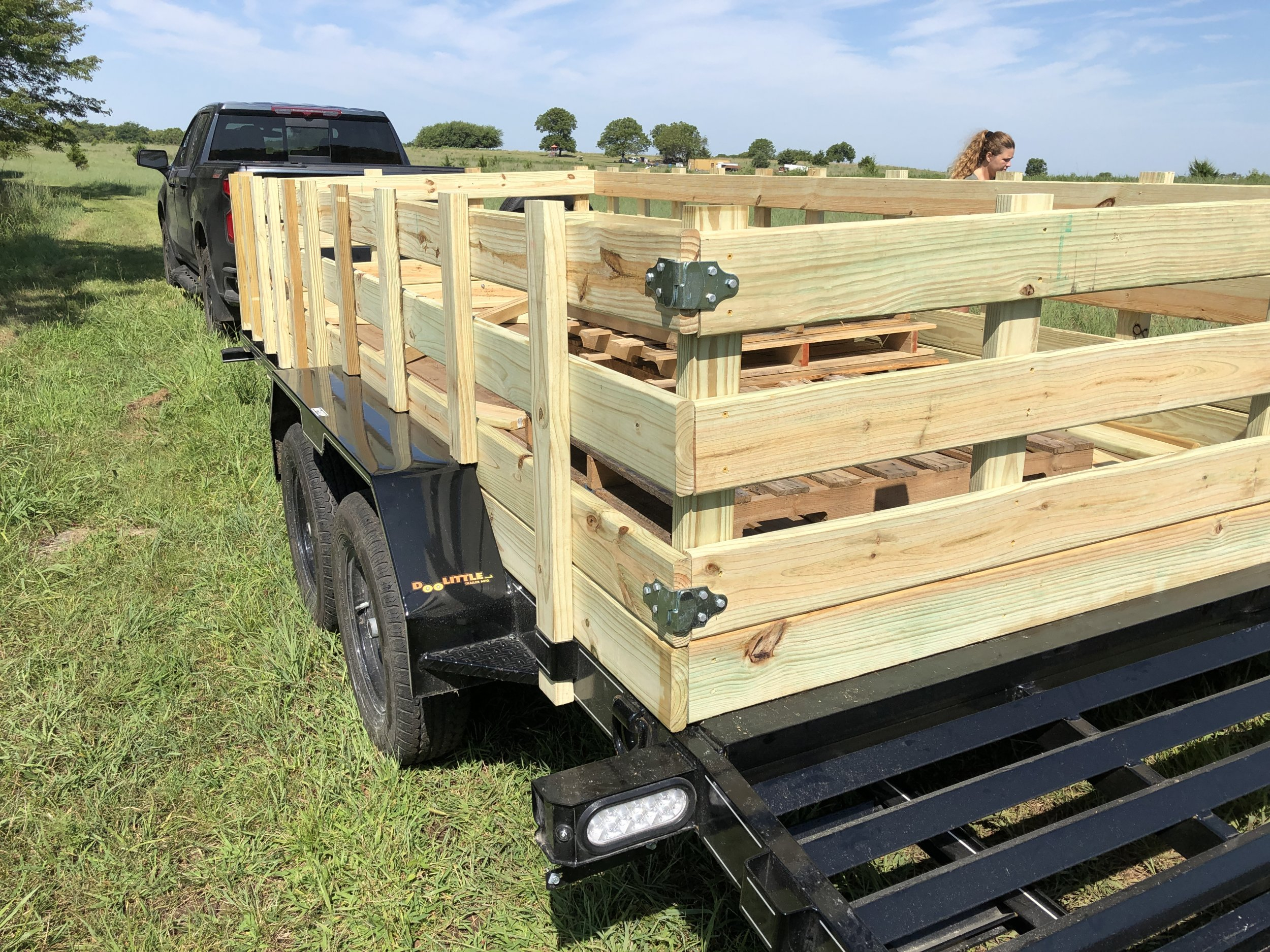

Put wood sides on my 18’ dovetail equipment trailer. Used pressure treated 2x4’s and 5/4 x 6” deck boards. They’re HEAVY! I can get the tailgate off by myself, but the 16’ sides are difficult even with 2 strong men. Luckily, I have this tractor. Throw two lifting slings around it and they come off easy. It’s nice to have both a flatbed for hauling the tractor or picking up pallets with stuff and a utility trailer as well. The sideboards are 32” high from the deck of the trailer.
/ Show your trailer sides #51
Pressure treated looks good when it's new. You gotta keep after it or it will bow, crack and split with the best of them if left outside. After it dries a little, I'd be coating it.
One of these days I'm going to have to replace some treated fence posts I had in corners. I used a double H pattern and every one of the cross posts disintegrated and fell out. :confused:

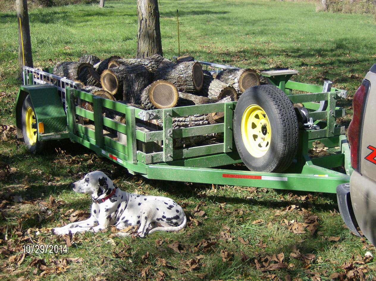

I can get 2.5 cords of heavy oak with room to spare.

You could probably do more than that but I guess 2.5 cord is about your payload. I used to get that much on my 10’ bed dump truck.
Yep. Weight's a factor. And usually load with skid steer bucket in bulk, no stacking.

What does that trailer weigh empty? My bumper pull 14’ 16k weighs 4600 pounds. Are those 8 or 10k axels?
