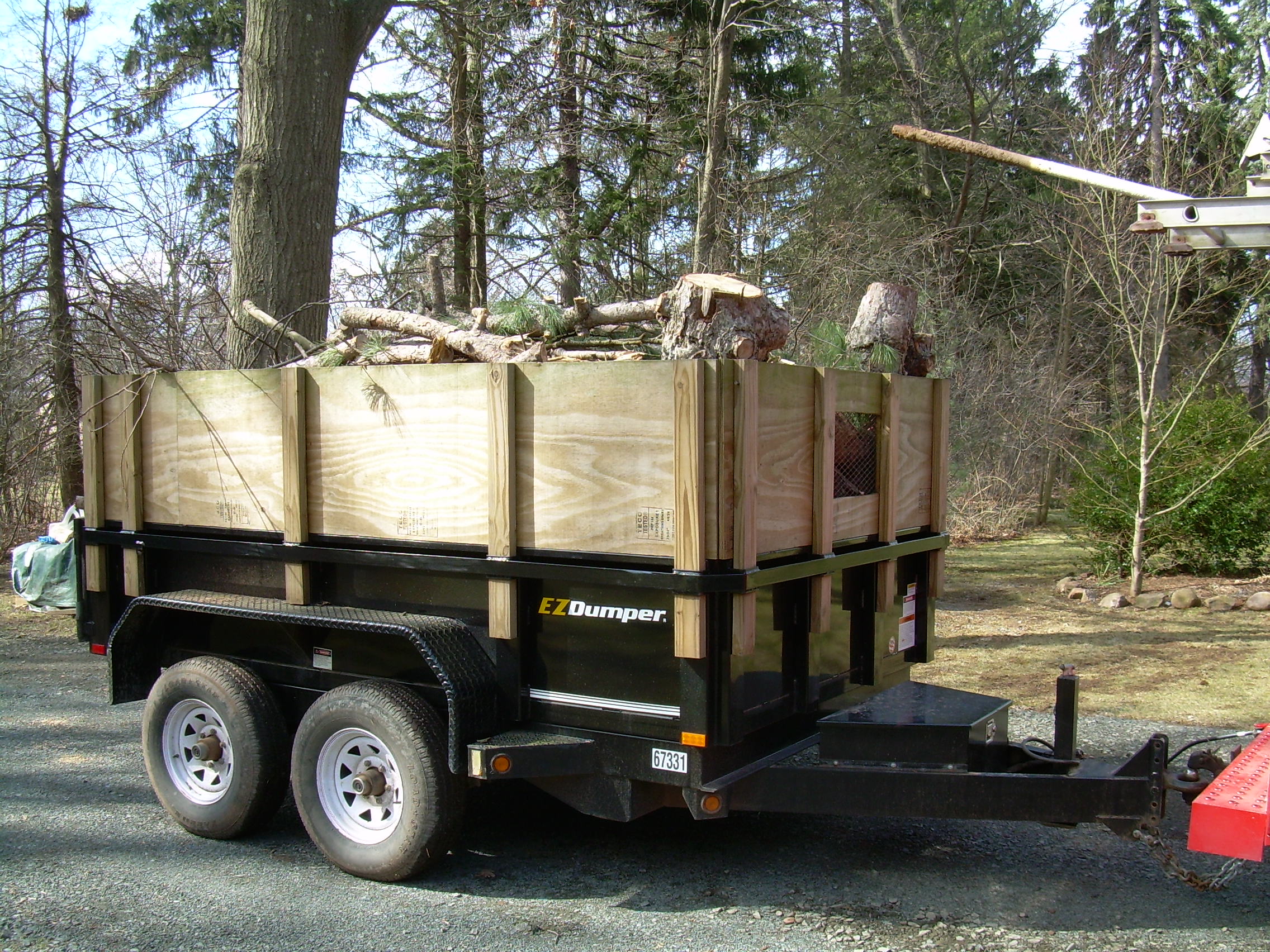

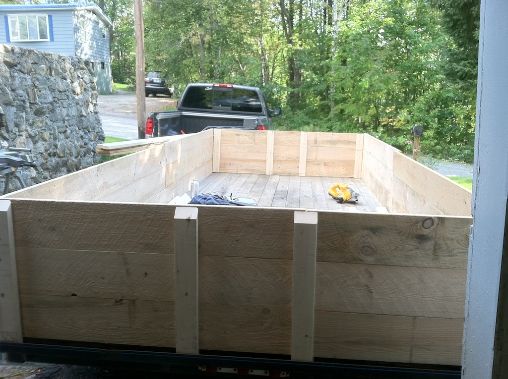

Okay, here's mine. I pulled the new trailer to my dad's place to build them, since he has a radial arm saw, which speeds up the parts cutting process greatly over using a skill-saw. Just finished them today. My prime prerequisite was to keep every section under 6.5 ft so they could fit in my pickup bed if needed. As soon as the last piece was in place, I pulled it over to the wood pile and filled it with firewood for the trek home.
Joe
Good Job!:thumbsup::thumbsup::thumbsup:

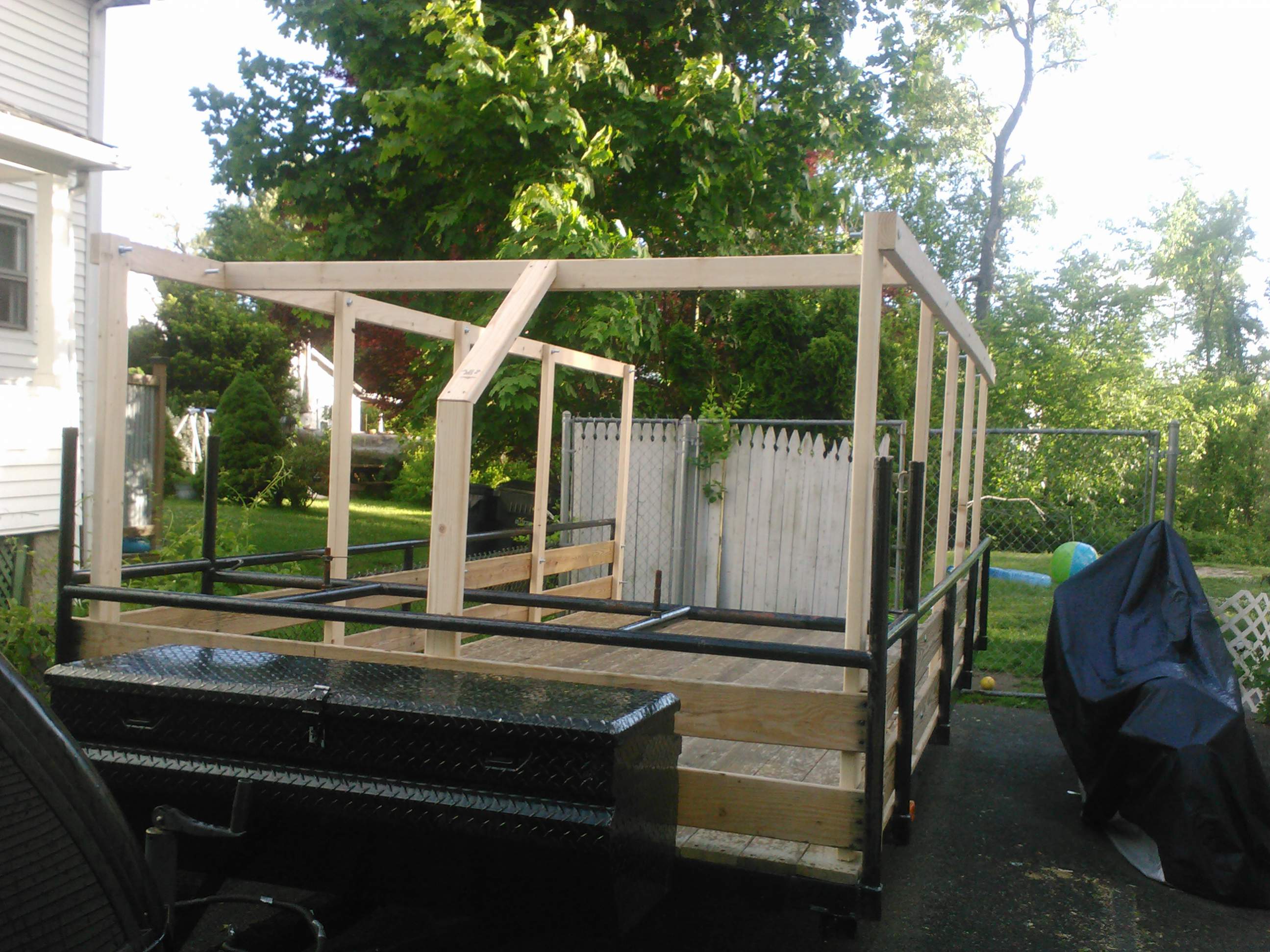

hi ik this old thread but thought i share sum pic of trailer iam in progress of putting sides on

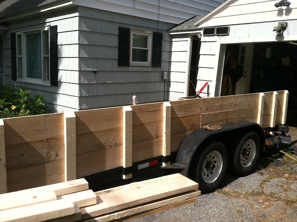

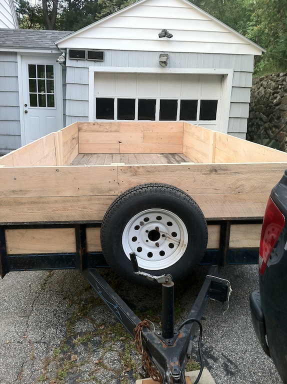

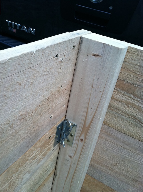

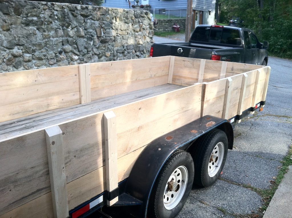

Here's the sides I built for my 16 ft car hauler a couple years ago and still holding together quite well. Built from 2x4s and rough cut 1x8 pine boards. 6 pieces held together with door hinges and hairpin cotter pins at the corners and side section junctions:

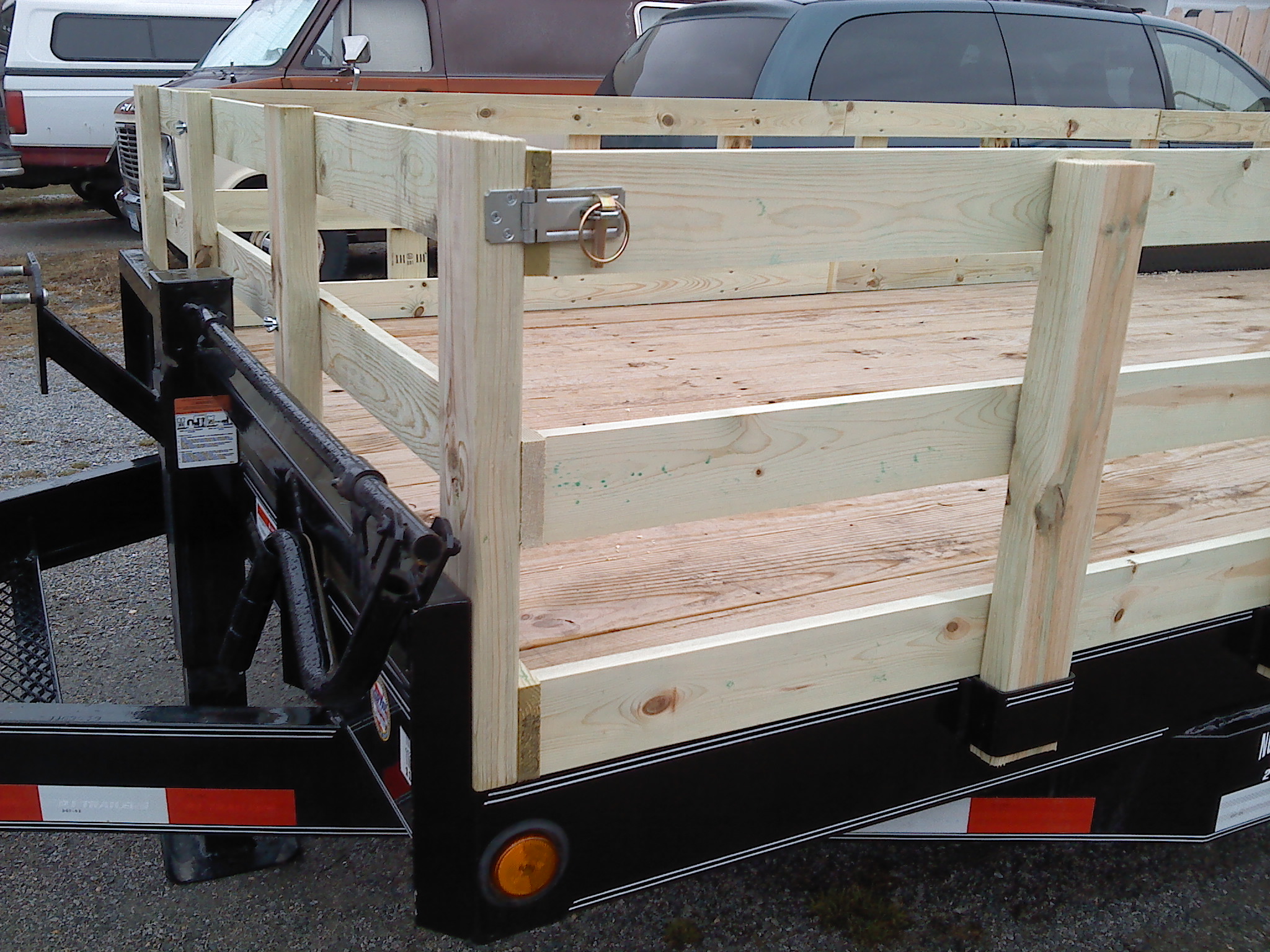

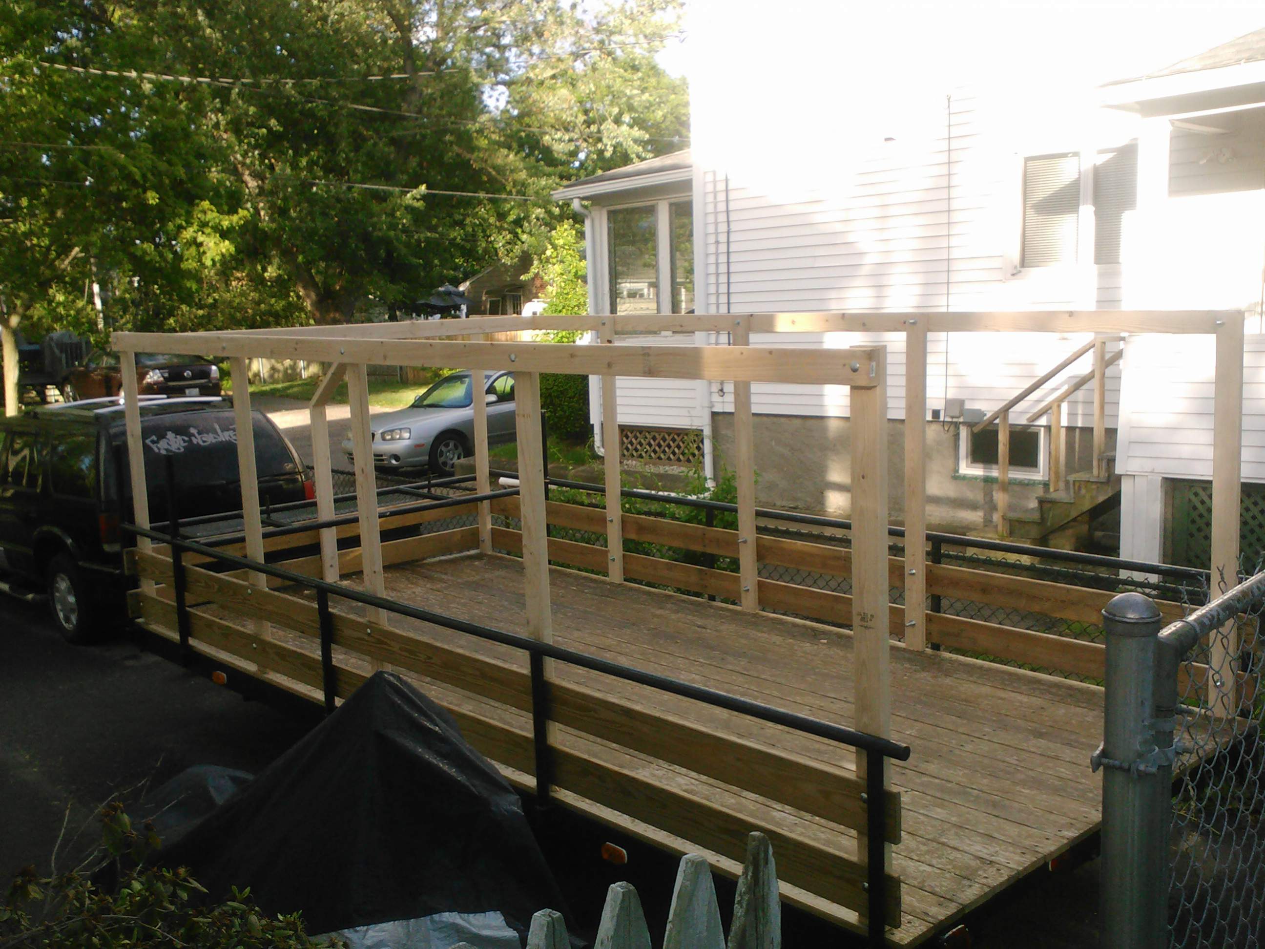

Thanks for all the ideas here. Finally got mine done. Will do something for the end later.IMG_0206.jpgIMG_0202a.jpgIMG_0203.jpgIMG_0204a.jpg

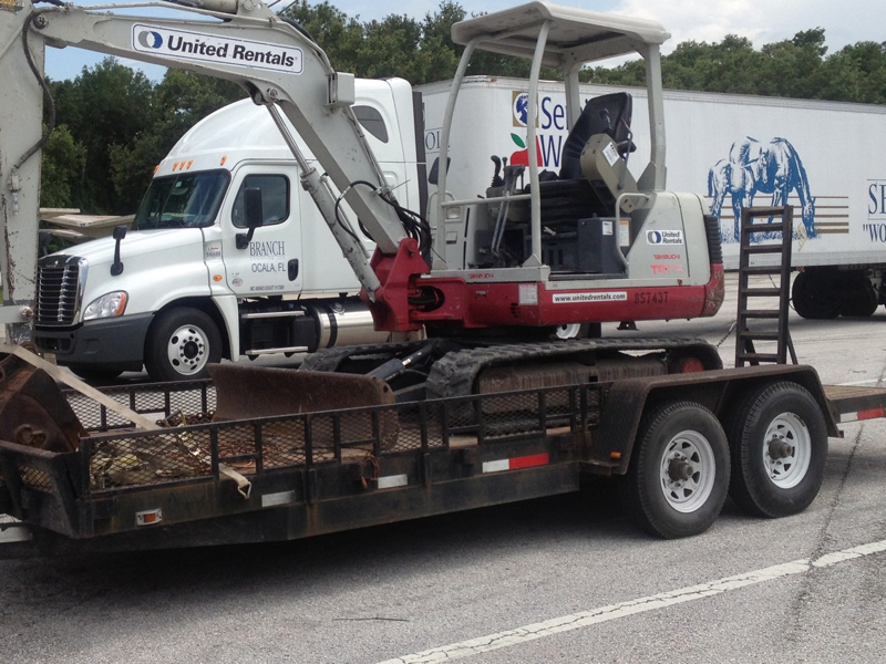

I found a set of side boards off of a big flatbed trailer for sale. I guess I could cut them down and make this sort of setup...
I've always wanted a setup like that, as it seems like 90% of the time the stuff I haul won't fit in an enclosed trailer or would be too hard to load, but just throwing a tarp over an open trailer isn't very waterproof.
Have been researching using MDO plywood for the sides and off the shelf truck tarp bows and brackets.
TruckTarpStore.com - Bows And Hardware - Product Details
