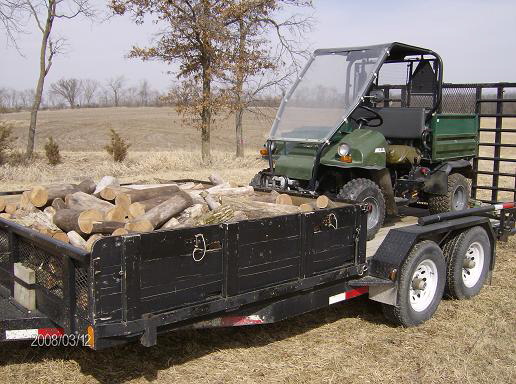

For my 16', I used treated 1x6's, w/angle iron on the top edge. The sides are in two pieces (7' & 9') with joiners & corner brackets from Northern. I can move the end gate up to the middle when needed.

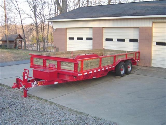

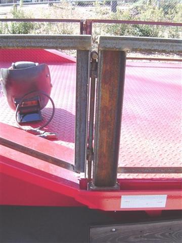

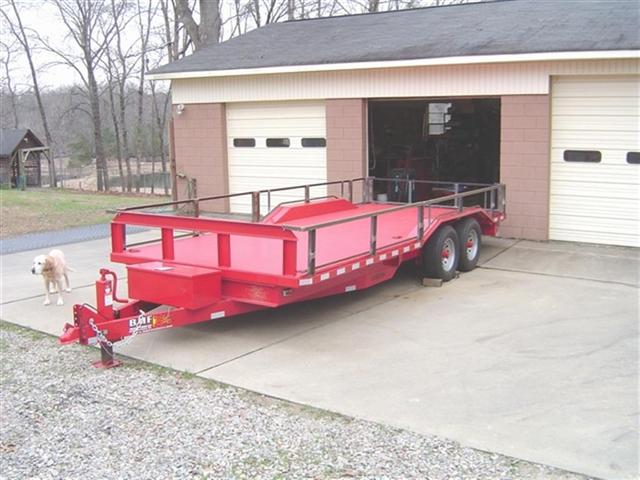

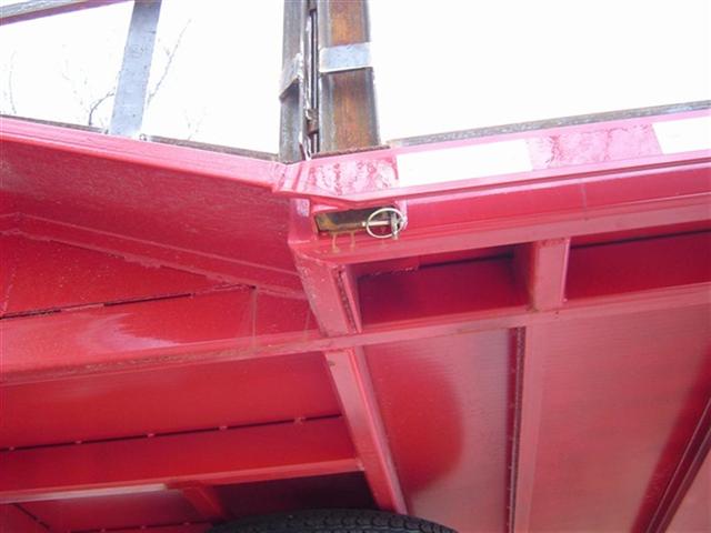

Here's some pics of when I welded up my removable sides to my flatbed...I made the 20 foot sides in two 10 foot or so sections so they would be easier to handle when taking them off.

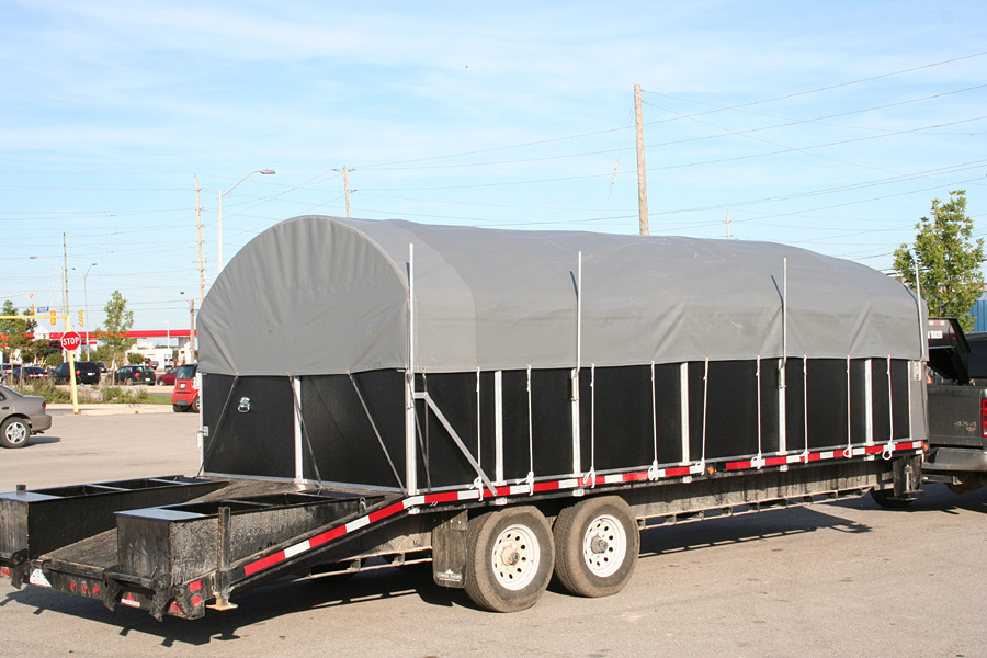

I found a set of side boards off of a big flatbed trailer for sale. I guess I could cut them down and make this sort of setup...

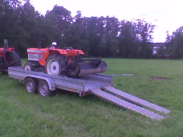

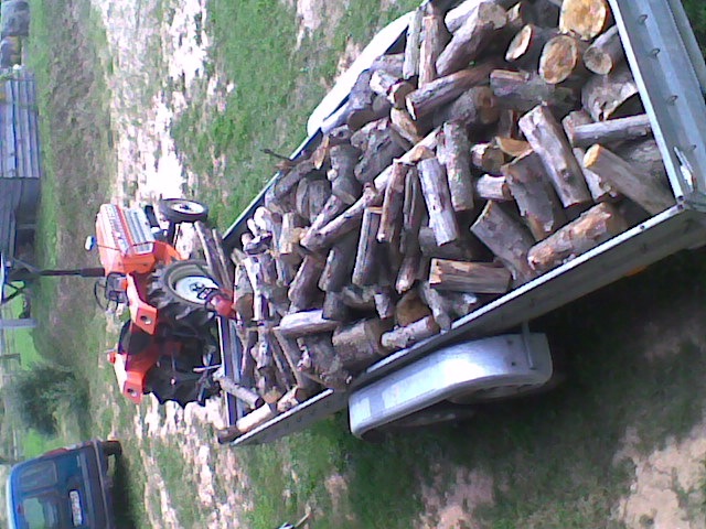

Just for sharing info - you can see in the pics my working rig (sorry for horrible quality). The trailer I still have has the originally welded on boards and the manual winch inside to load long (up to 6 m) woods. Its total loading capacity (trailer weight included) is 1.5 tons. And it worked perfectly for me.
But now I'm searching for a trailer to be attached to a M tractor (or/and to the car/truck) with the fully loaded trailer max capacity of either 3 tons (if without trailer brakes) or better 8 tons with brakes and max drawbar load of 0.8 ton. The use will be similar - to bring the ag equipment (flail mower, disc mower, rotary tiller, woods or whatever else) between my lots in a distance of 35 miles or inside a lot.
So there's no way to express a one word answer to the question "what kind of trailer do I need?". :laughing: For sure you understand that.
That's what I'm looking for and thanks again for a link of PJ I'm still studying. :thumbsup:

Saracenas,looks like that trailer is galvanized steel, right? Are you near saltwater? Nice looking outfit you have there.
Yes, that's true - a steel trailer is fully galvanized; and that 300 ha lake is a freshwater one.
Concerning the outfit, thank you, but I'm in a phase of changes. When you're going from one class of tractor into another (compact ---> mid class), you need to change many things, not only a tractor - attachments, trailer, approach, habits... Most important point is a budget potential. Seems it's not as easy process as I thought it'll be. :)
Well, I'm now about to finalize that phase. One of the last things I need is a new trailer. And the dozer blade in the future, what is complicated in my case...
