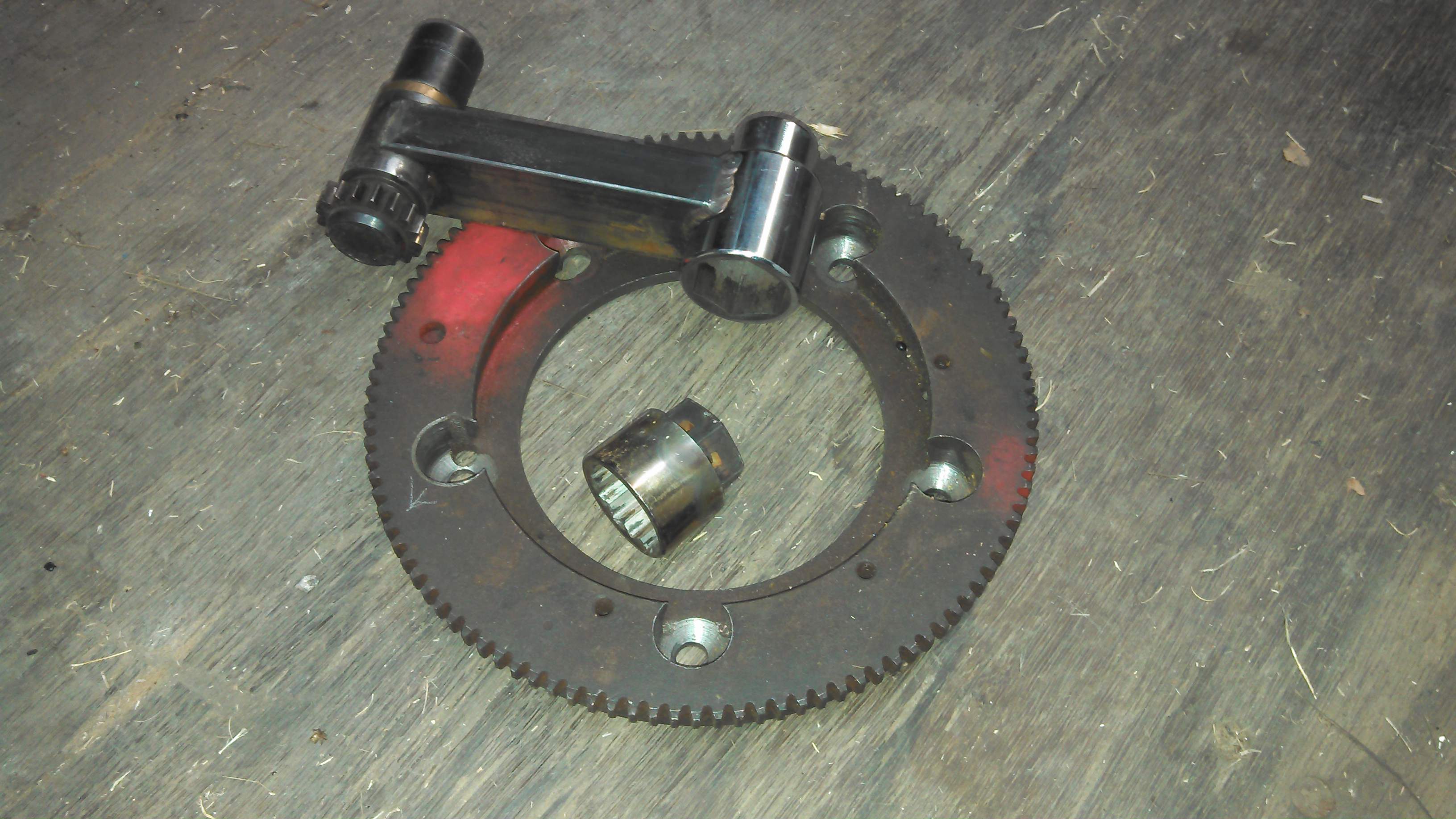

Instead of buying a Chinese lugnut wrench for 100 euro, or a Gedore or Facom for 250 or 300, i decided to weld a piece of pipe around some large size sockets (i keep buying sets, but allways loose common size 10, 13, 17, 19 first) of 24, 27 and 30mm for all agricultural lugnuts, weld on a foot of pipe as a spacer, then weld on an eye of an old hydraulic cylinder, to create extra heavy lugnut wrenches. the eyes fo the cylinder were big enough to fit a 3 foot length of 30mm (1 1/4") alloy piston rod of another old cylinder to use as power bar. Because the pipe doesnt flex like the extension rod of a half inch socket set, a quick yank on the steel bar is enough to pop them loose. When its not enough i slide a 6 foot pipe over it and try again... So far i have only twisted the 1" extension pipe on the 27mm socket, so i will change it for a heavy walled pipe.
No more breaking the half inch square connectors of your ratchets or the 70 euro half inch powerbar. Just beefy steel, its not only cheaper but the size of it makes it less elastic so the yank you give to break a bolt loose, pounds fully on the nut instead of wasting your energy on a 15 degree of flex in the tool, before the nut starts to turn...
I'm sure these tools will last longer than the chinese lugnut spider wrench, and if they break i can just weld a bigger pipe in it... :)

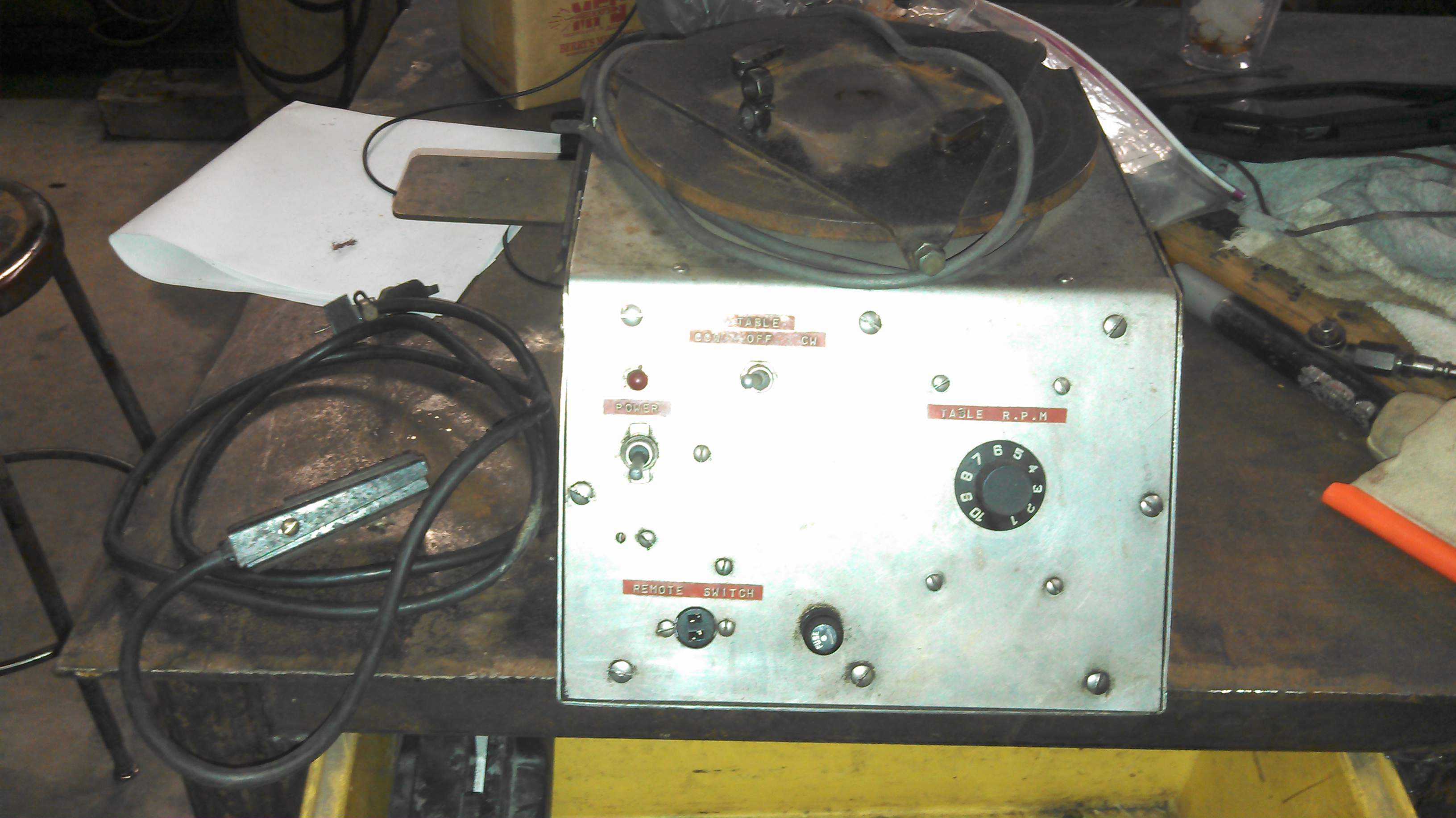

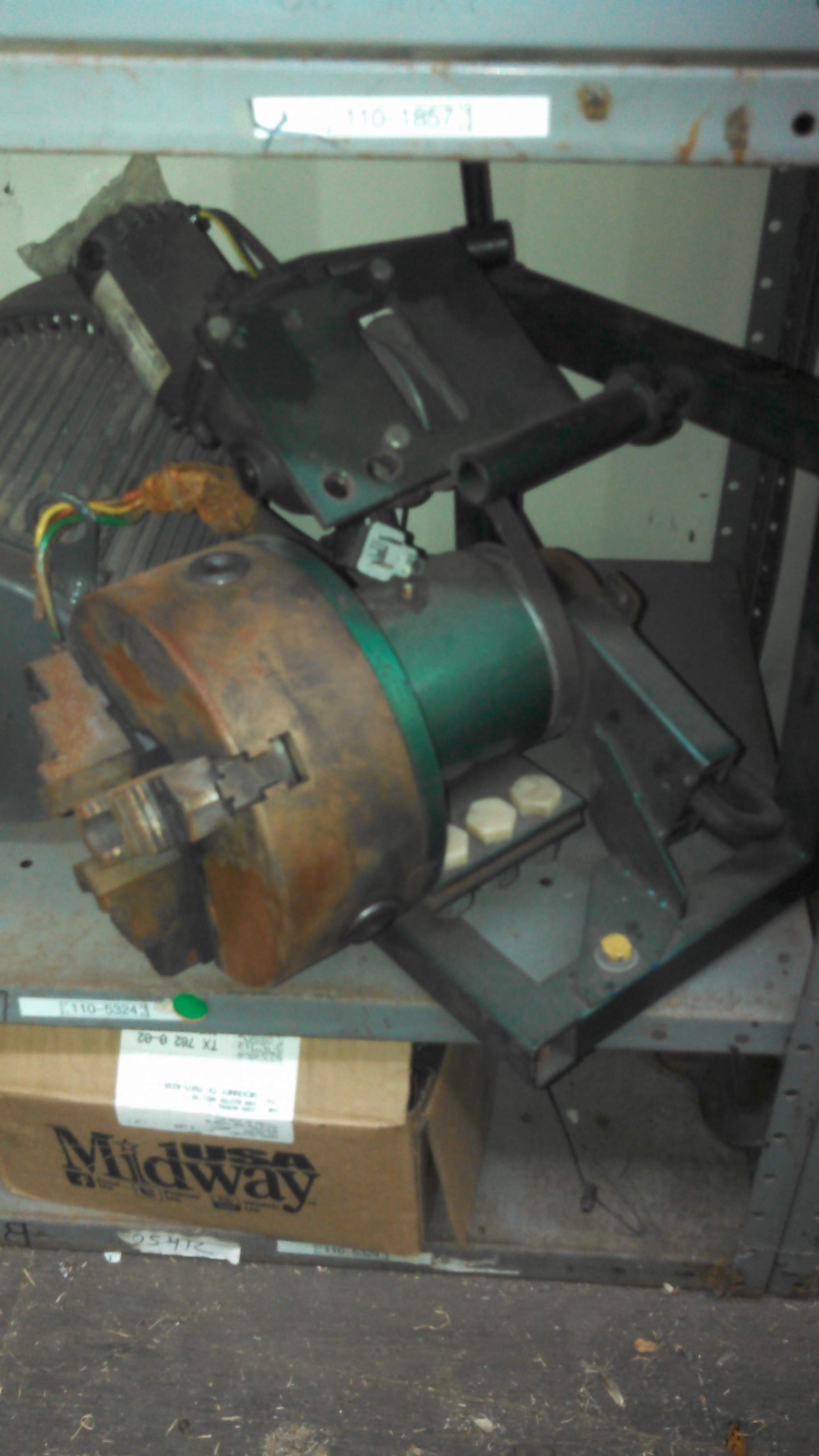

After a number of years making rust, I ran the auto caster again today.
You have to click the photo to play the video.
