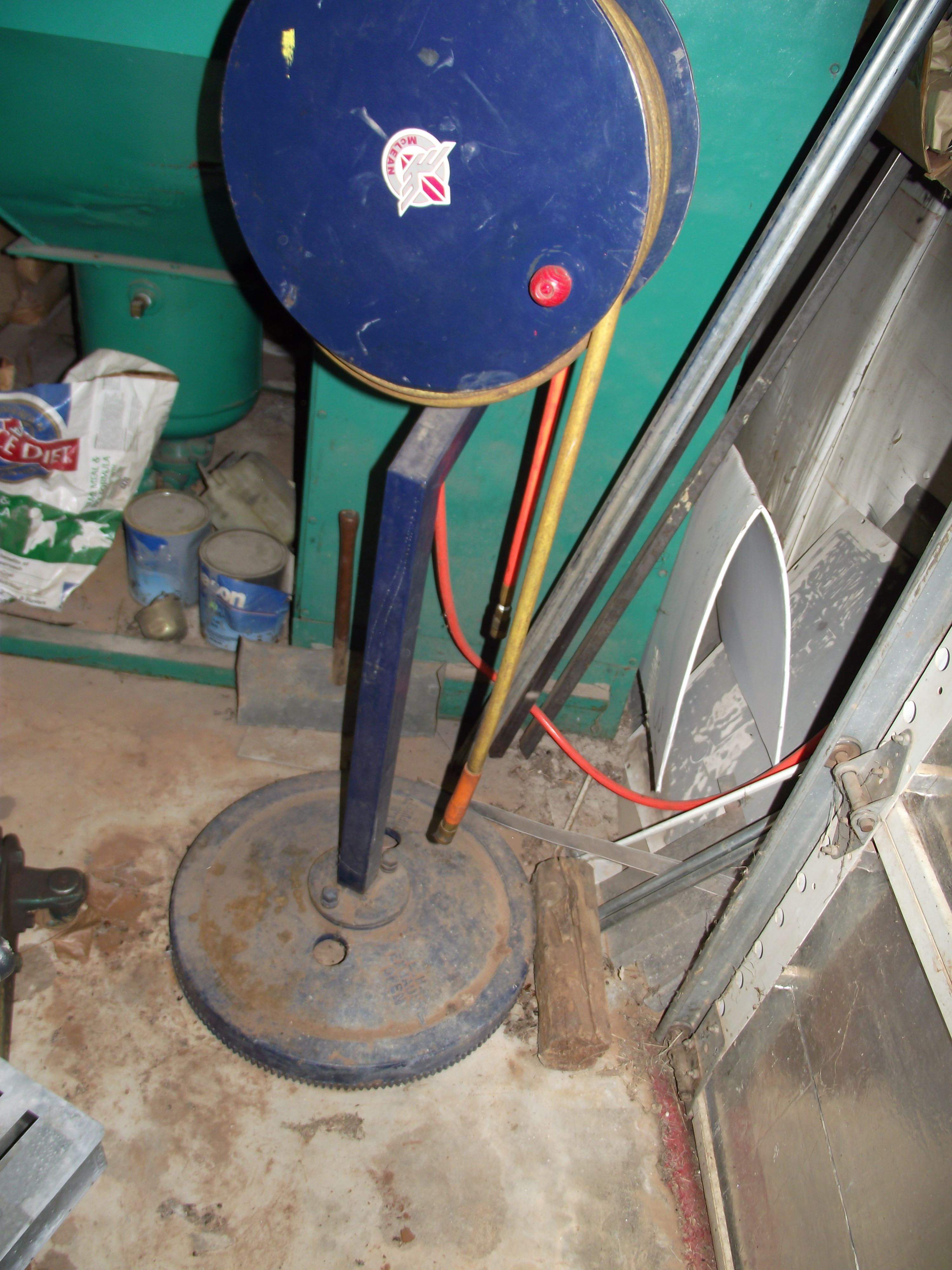

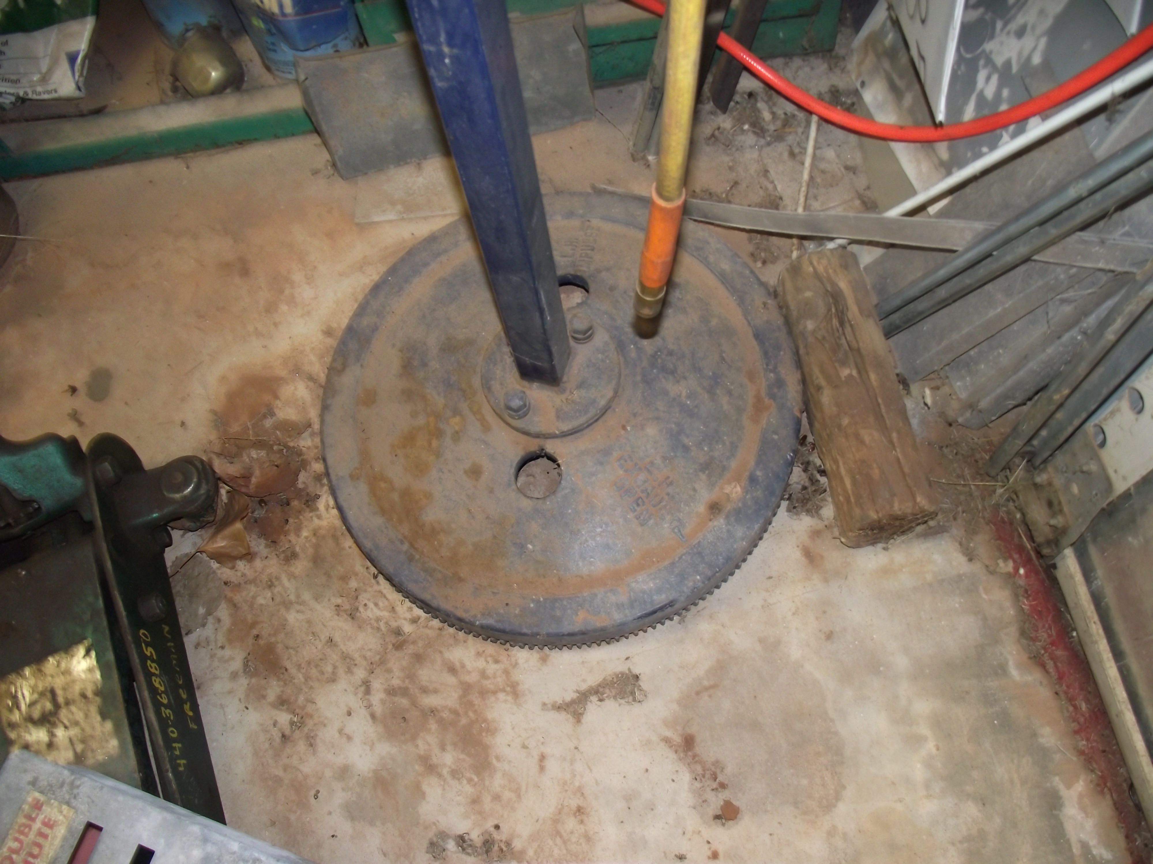

Nine can pneumatic can crusher, paint can rack beside it holds them horizontal so the tube doesn't clog. And quarter turn paper towel dispenser holds tight so it stays put when you yank on them with wire stay so the wind doesn't blow them all over the place.

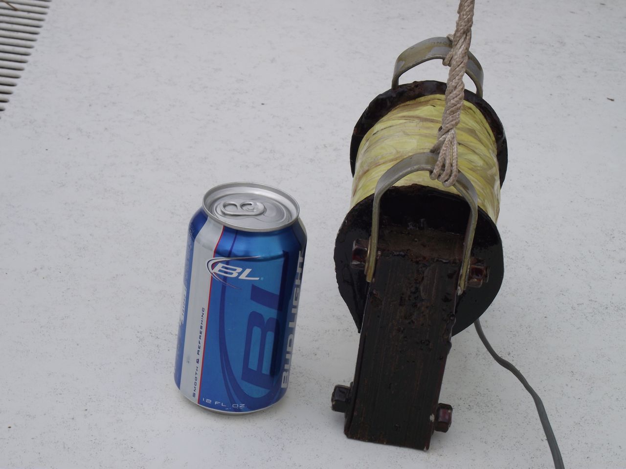

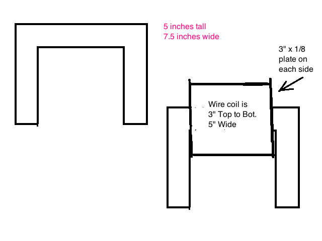

/ Show What Tool You Made* #47

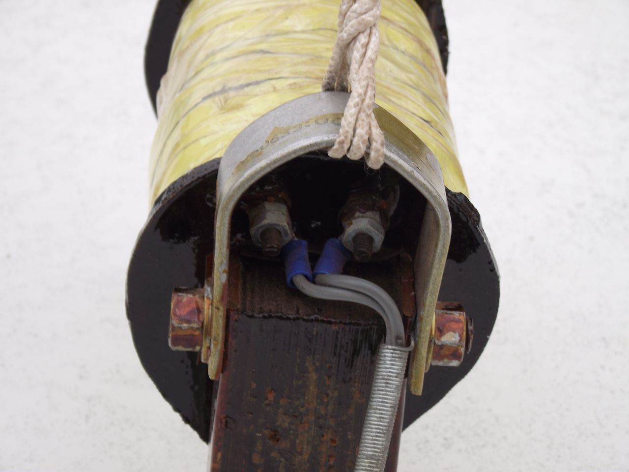

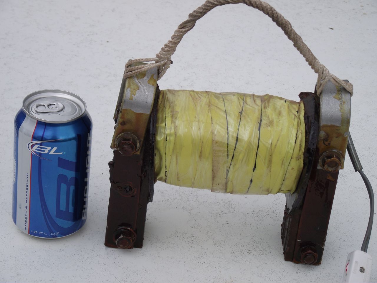

Not sure I understand the logic behind that. Don't the lines of force follow an arc from 1 pole to the other. So the only time you would miss it is if the crack was very short and directly parallel to the magnet, centered between the poles but fairly far away? Ah the weaker the magnet the more likely that would be a problem too. His seems to be a very strong magnet.
Basically what you have is a magnet that you've bent into a U shape. Here's a picture of the magnetic fields of your magnet. The strongest lines are the shortest distance between the poles, hence they will be the ones to best detect a crack. I have drawn to back cracks, a green one and a yellow one. The green one will not show up well because it's inline with the magnetic field where as the yellow crack is blocking the magnetic field and is easily detected. Think of it as putting a flat piece of steel into a stream. If you put the steel into the stream sideways (yellow crack) it will block the water from easily flowing. The water will now have to flow around the sides and disrupts the water flow. By rotating the magnetic field by 90 the yellow crack now becomes inline with the magnetic field and the green crack is blocking the magnetic flow. So for best results you check twice (the second time 90 degrees from the first) so no matter which way the crack runs you will detect it.
