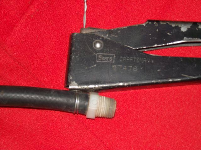

So with some old motorcycle engine cartridge style bearings (like a 6204), I tackwelded the bearings onto an angle iron. Got a $16 air polisher and discs from Harbor Freight. Friction from the air polisher spins the ram nicely, polishes evenly. ( ! :thumbsup: ! ) Evenly enough for this job anyway.
Easy tool to make but probably will never use it again.... can't say it saved me money because I wasn't going to spend $5-800 anyway but this worked out well, got the new packing and all is well.
/ Show What Tool You Made* #133
Re: Hydraulic RAM spinner / polisher
Was doing rear wheel bearings & brakes on my Son's Jetta. Rear calipers are a stupid screw-in design rather than the normal push in style. Mechanic buddy of mine lent me his snap-on set doing the first side but had to give it back before I got to the second after fighting with the bearing for a week. Dug thru the "too good or too many to throw out" bins and made this in about 15 min which is about the same amount of time it would have taken to drive to his house and back.
Did the job and actually worked about as poorly and the snap-on one did. As a bonus, the head is removable to compress regular calipers if I want rather than using a big C clamp.

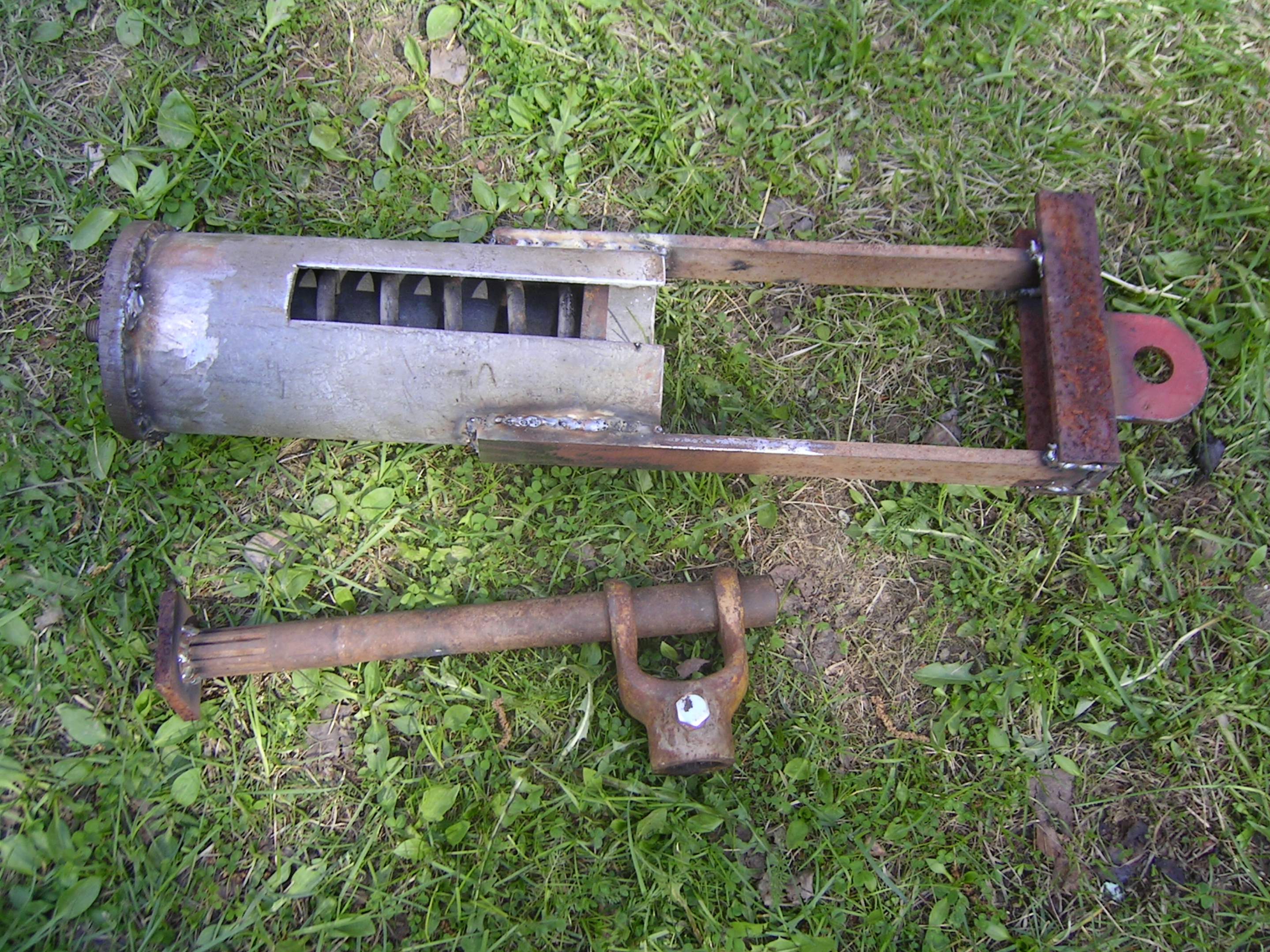

I restore old tractors quite often and it is not rare that the motor is frozen Therefore I created a handy tool to help me, when the cylinders have been left with rust solvent a while then I put this on the PTO so the engine is under tension while I gently taps on the pistons with the a mallet and a piece of wood. SANY0066.jpg

I restore old tractors quite often and it is not rare that the motor is frozen Therefore I created a handy tool to help me, when the cylinders have been left with rust solvent a while then I put this on the PTO so the engine is under tension while I gently taps on the pistons with the a mallet and a piece of wood. View attachment 358042
That sure is a nice one! Also, I have no idea how it works. Would you expand a little on that?
/ Show What Tool You Made* #137
The part with a rod goes on pto and the tube has a spiral spring which pushes the rod. it is a piece of flat iron in the end of the rod so it does not go out of the slot. The idea is that the spring keeps the engine under tension and helps till when I loosen the pistons. The loop on tube is hung either on an engine lift or to a suitable location on the tractor, it is also a threaded rod so the spring can be compressed to make installation easier.
I would guess that the yoke goes on the tractor's PTO shaft and the cylinder/spring is attached to a solid structure with the "yoke" shaft riding in the cut outs in the cylinder. The now compressed spring puts constant rotational tension (pulls) on the yoke's shaft to help turn the PTO. Since the tractor's PTO is engaged, it is in essence coupled to the engines crankshaft. Any rotation of the PTO translates to the crank turning and producing piston travel. This pulls the pistons downward while Tor can tap the pistons from the top with a mallet to help free them. Is that correct Tor?
/ Show What Tool You Made* #139
Exactly right. It is a great help when trying to loosen the pistons.:thumbsup:
