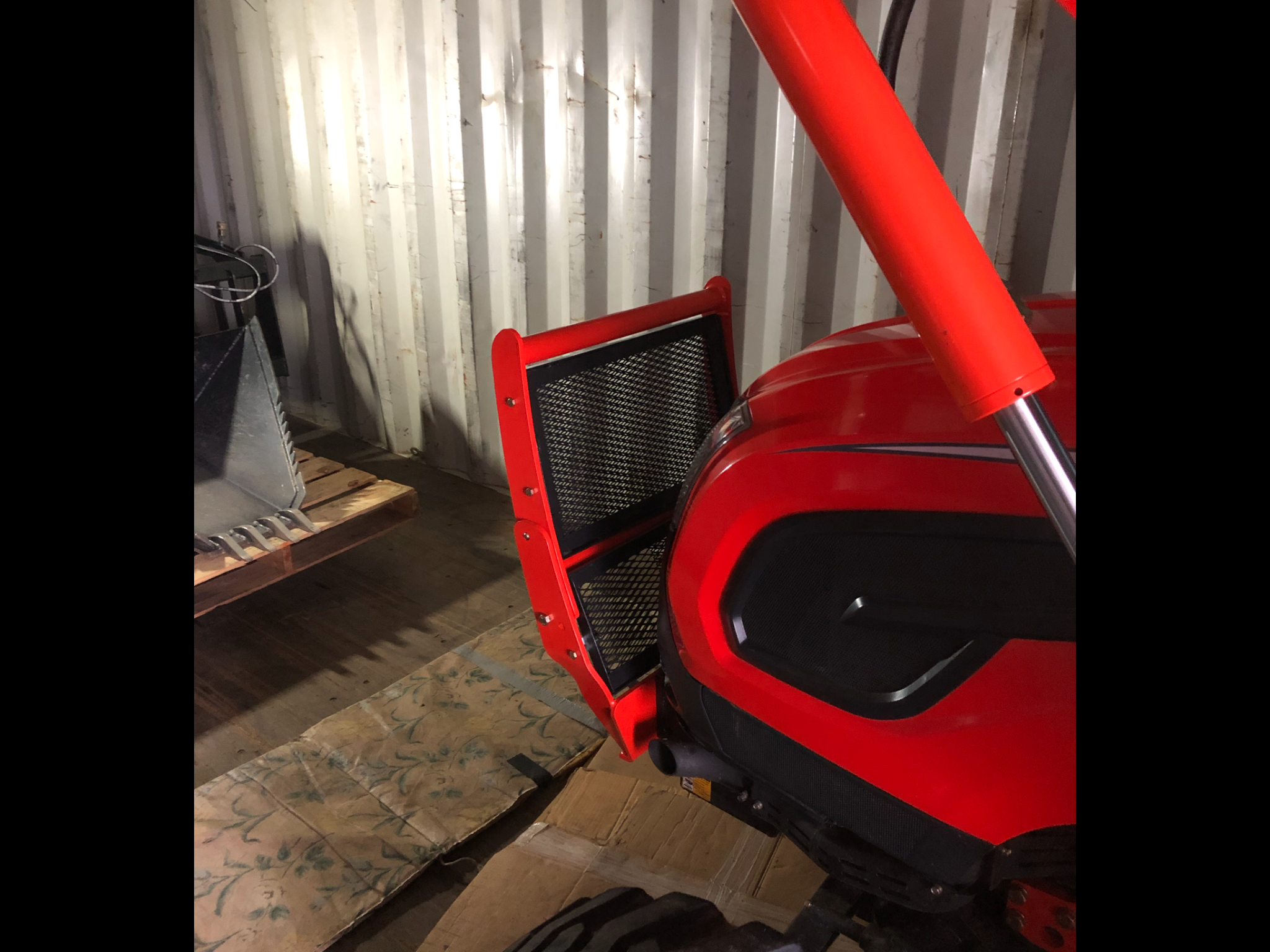

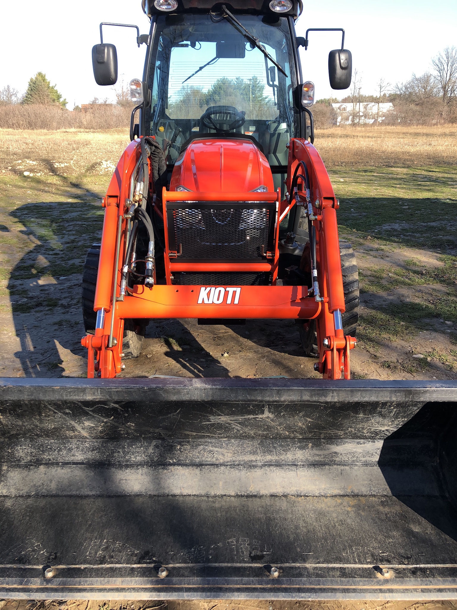

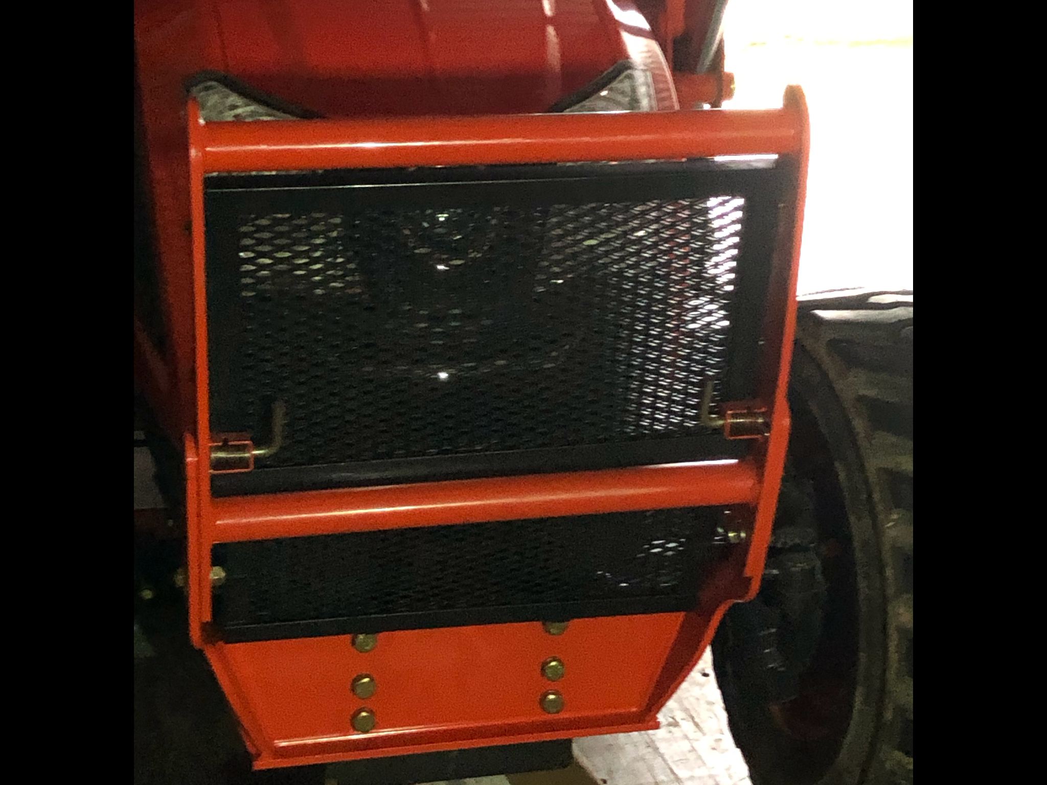

Just FYI for new tractor owners you generally do not think about adding this add on until a branch goes through your grill. This can happen to you no matter how careful you are especially if you are using a grapple
Either fabricate a brush guard or add expanded metal to the back of your grapple cage area.

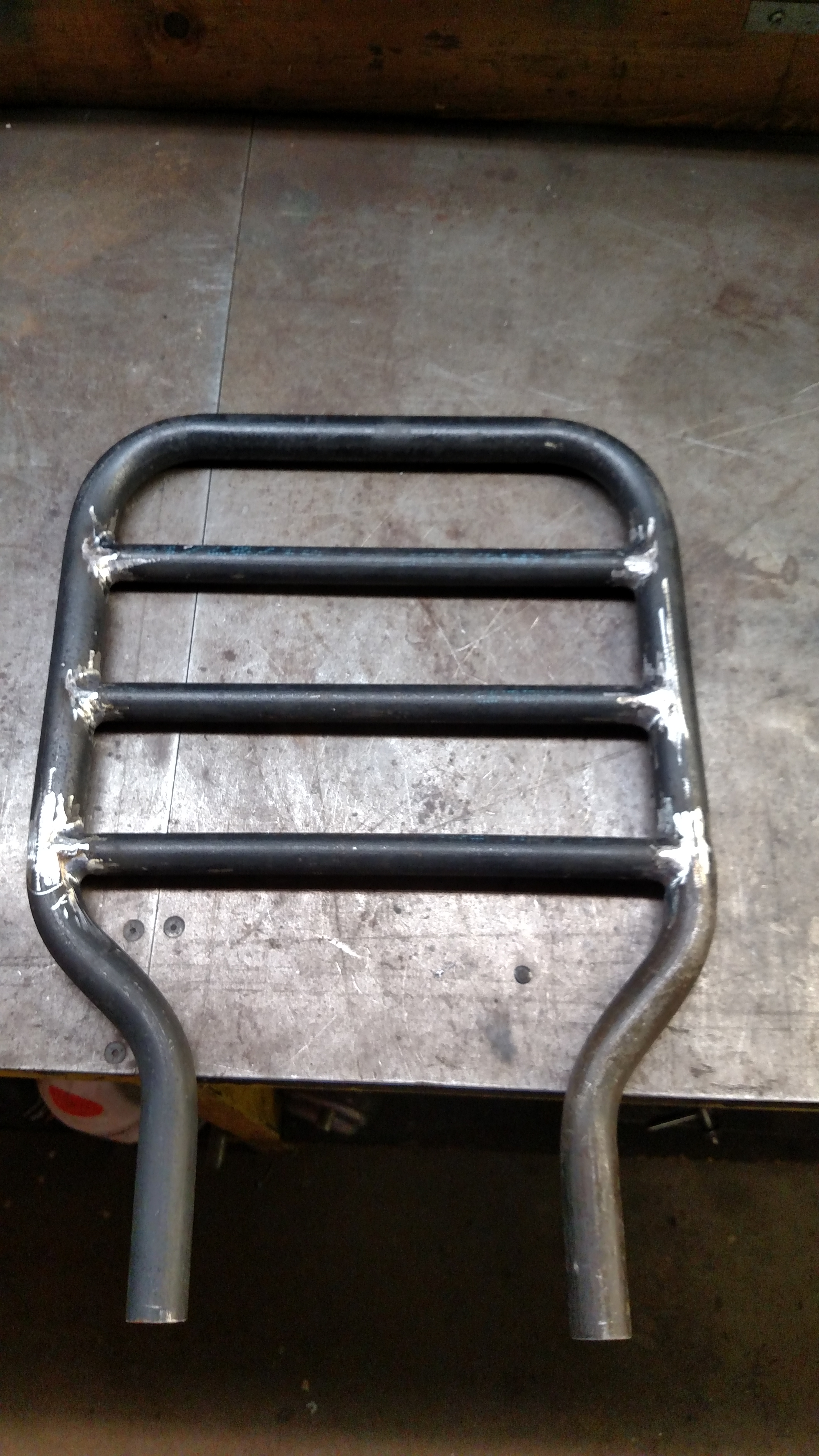

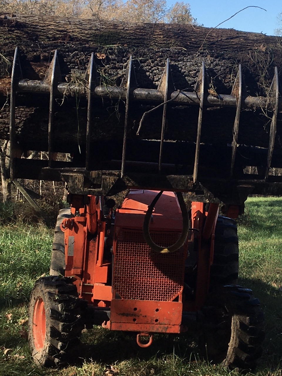

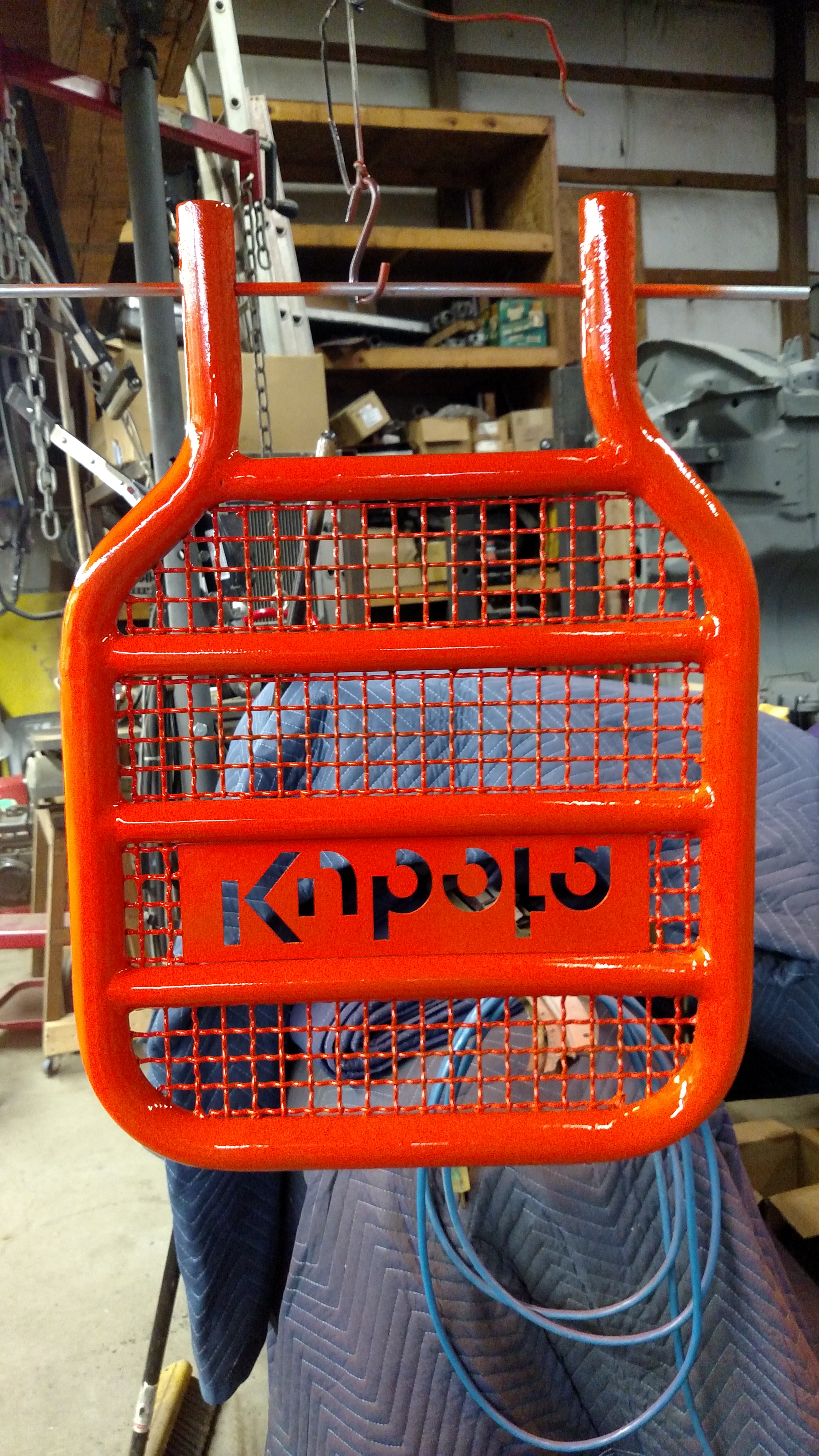

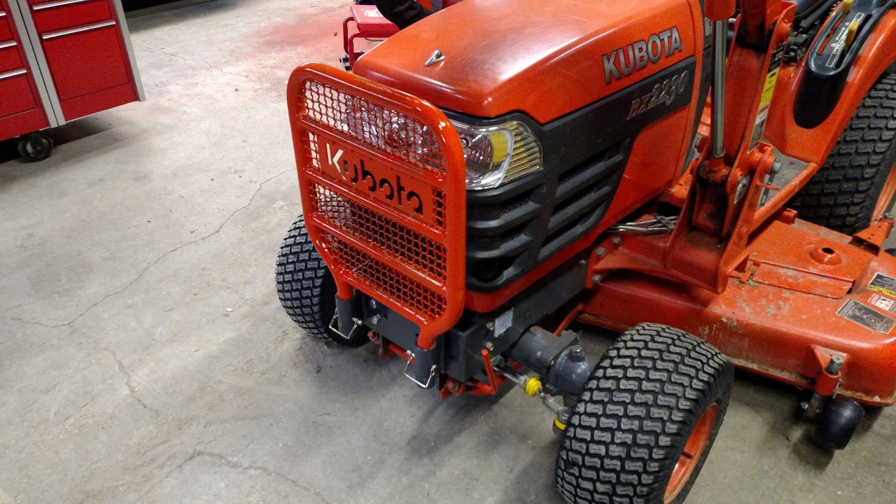

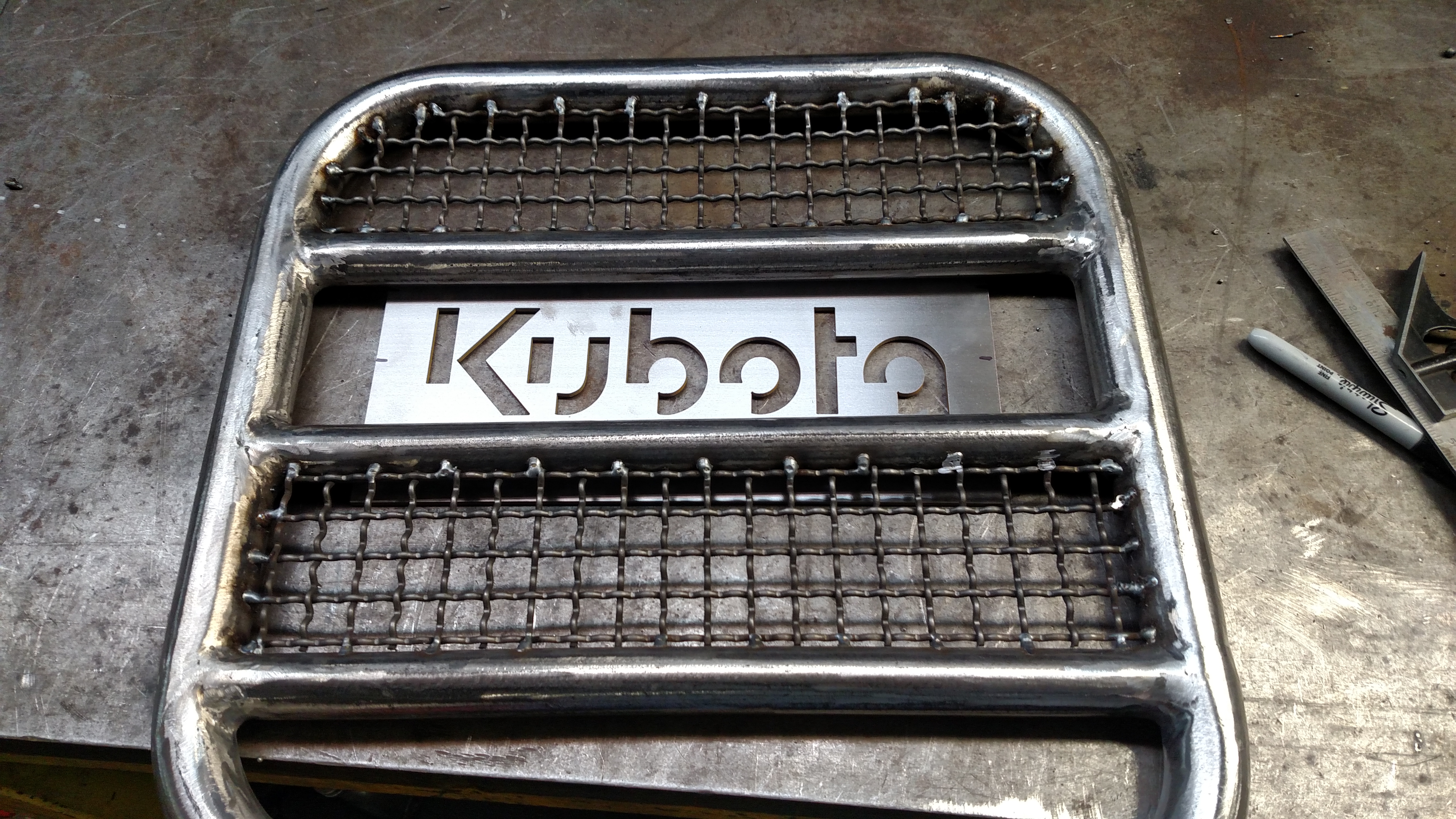

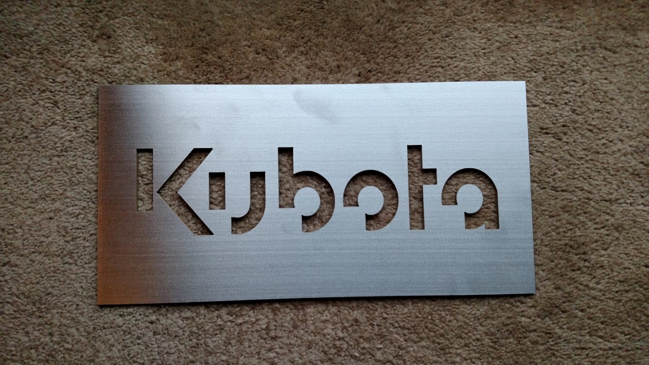

I built this for my BS last year. I had a local shop bend the 1" tubing and had the logo plate made at eMachineshop.com. I got the mesh off McMaster-Carr. Has saved the front of the tractor a couple of times.
Held on with a couple pins, removes in a few seconds when necessary.

Very nice Professional built
