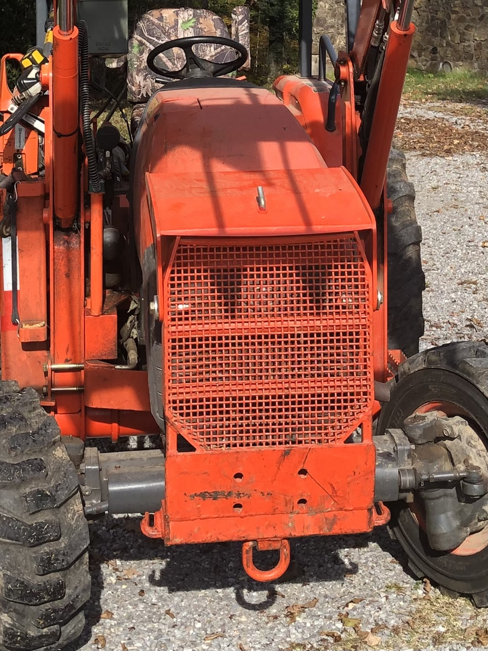

Look closely at the picture - post#2. The top of the grill guard swings forward to allow the hood to open.
The top bolt locks the grill guard in the upright position. The bottom bolt is what the top of the guard swing on. The "swinging grill guard" is OEM on my M6040.

Smokeydog - I DO really like the look of the brush guard - middle picture.

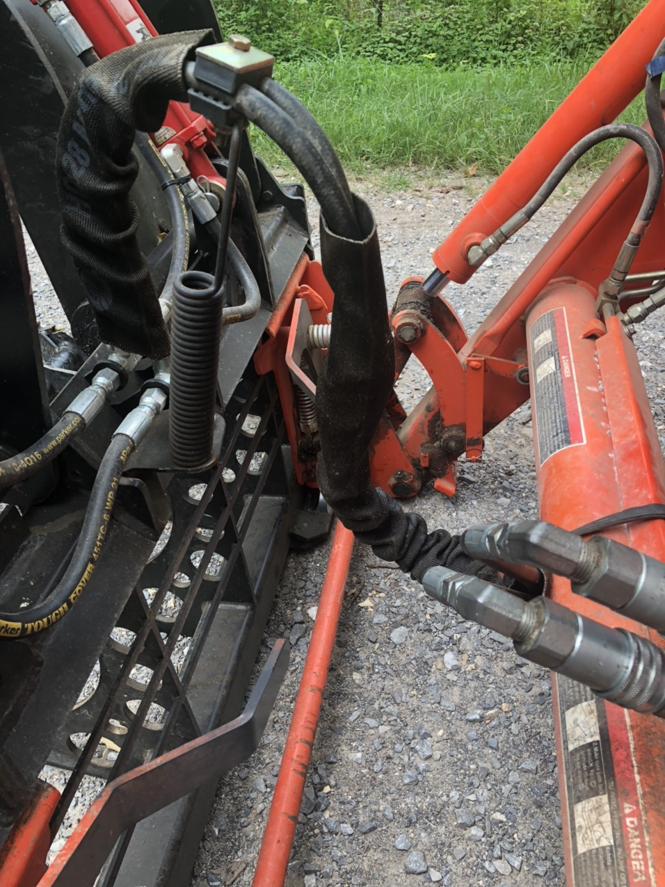

On smaller tractor hose management is more of an issue. The spring hose mount standard on EA wicked helps.

Smokydog - I DO like that spring hose mount on your EA grapple. I have a couple bungee cords. They run from the bucket level stand-off to the hoses. Kind of Mickey Mouse but the do the job. Look closely at the bottom pic in post #4.

The Danuser Intimdator also came with a spring hose mount. Still use bungees on cross tube to keep hoses safe on all the grapples.
