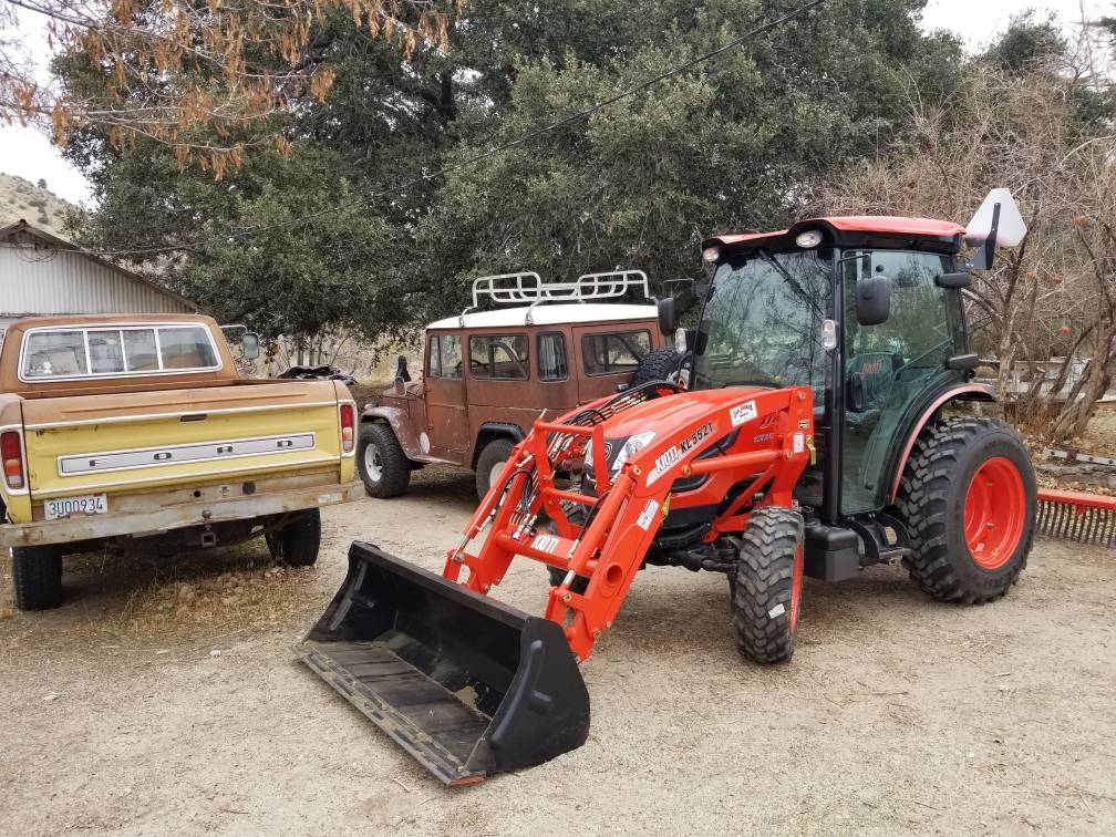

Kioti RX7320PC
Anyone happen to have the current OEM Kioti 3rd function installed on their tractor? (Preferably NS model, but they may all be the same)

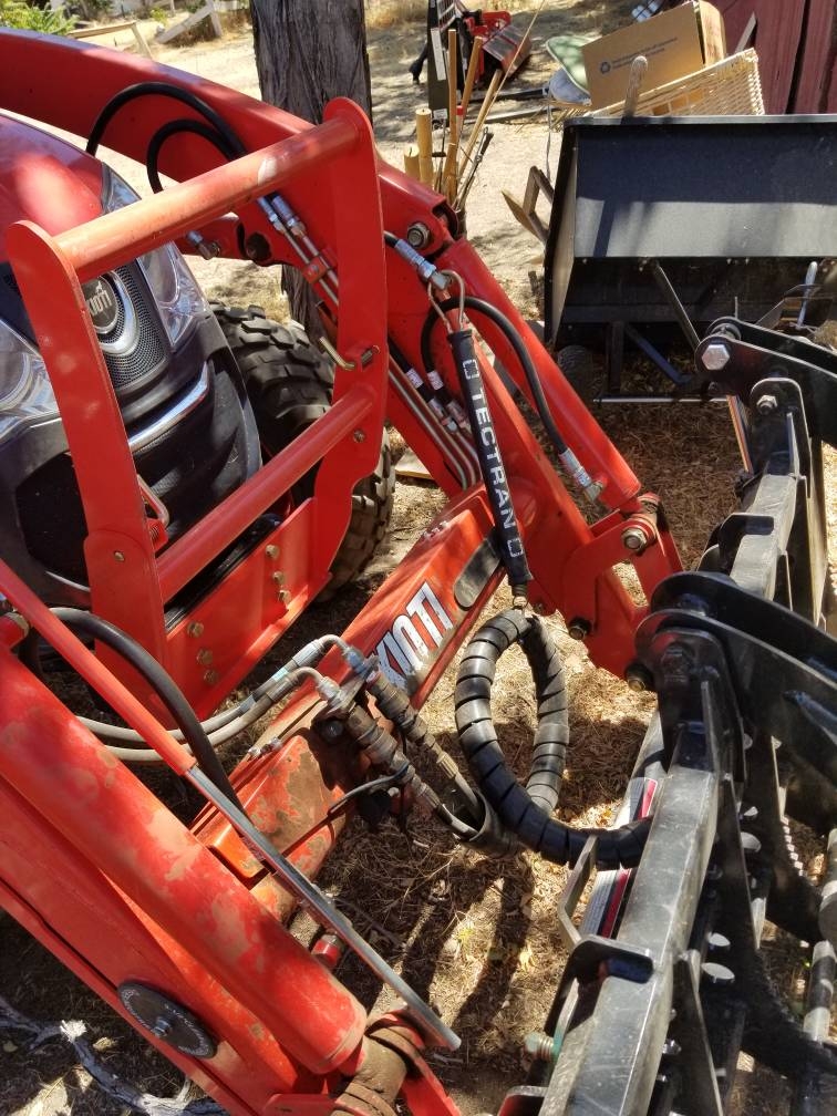

I have the factory 3rd function on my DK4710SE. If RPMs are high it will sort of operate the grapple while curling.
My two complaints are more about the design. First is how the hydraulic system is protected. Second issue is that rather than go to steel tubing across the loader arm,they just ran hydraulic hoses held on by zip ties.
Overall though I am satisfied with the option. The only problem I have had with the 3rd function is brush disconnected one wire connector. I pushed it back together and kept on working. View attachment 837704

I like the wicked 60 grapple I have. I can pluck brush straight out of the ground sometimes. I held the hoses as shown and it works well.

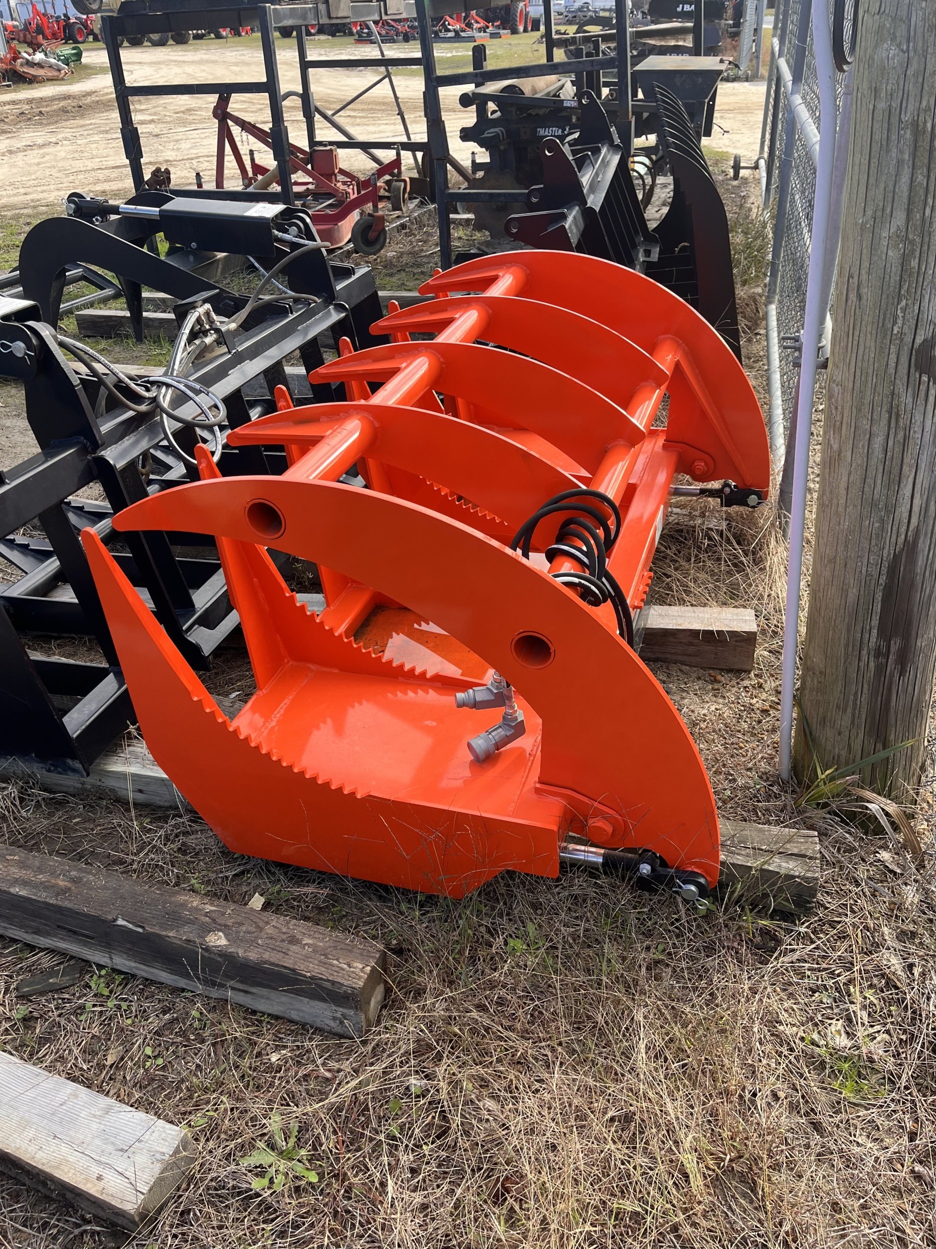

I finally pinned down the type of grapple I wanted (root rake style) and located a nicely priced one with my dealer made by CID as their skid steer medium duty 66” grapple rake. Orange one pictured below. I really like the style and features. They are supposed to
Hold it for me till this weekend. Now if my 3rd function kit would hurry up and get here I’d be set. Lol

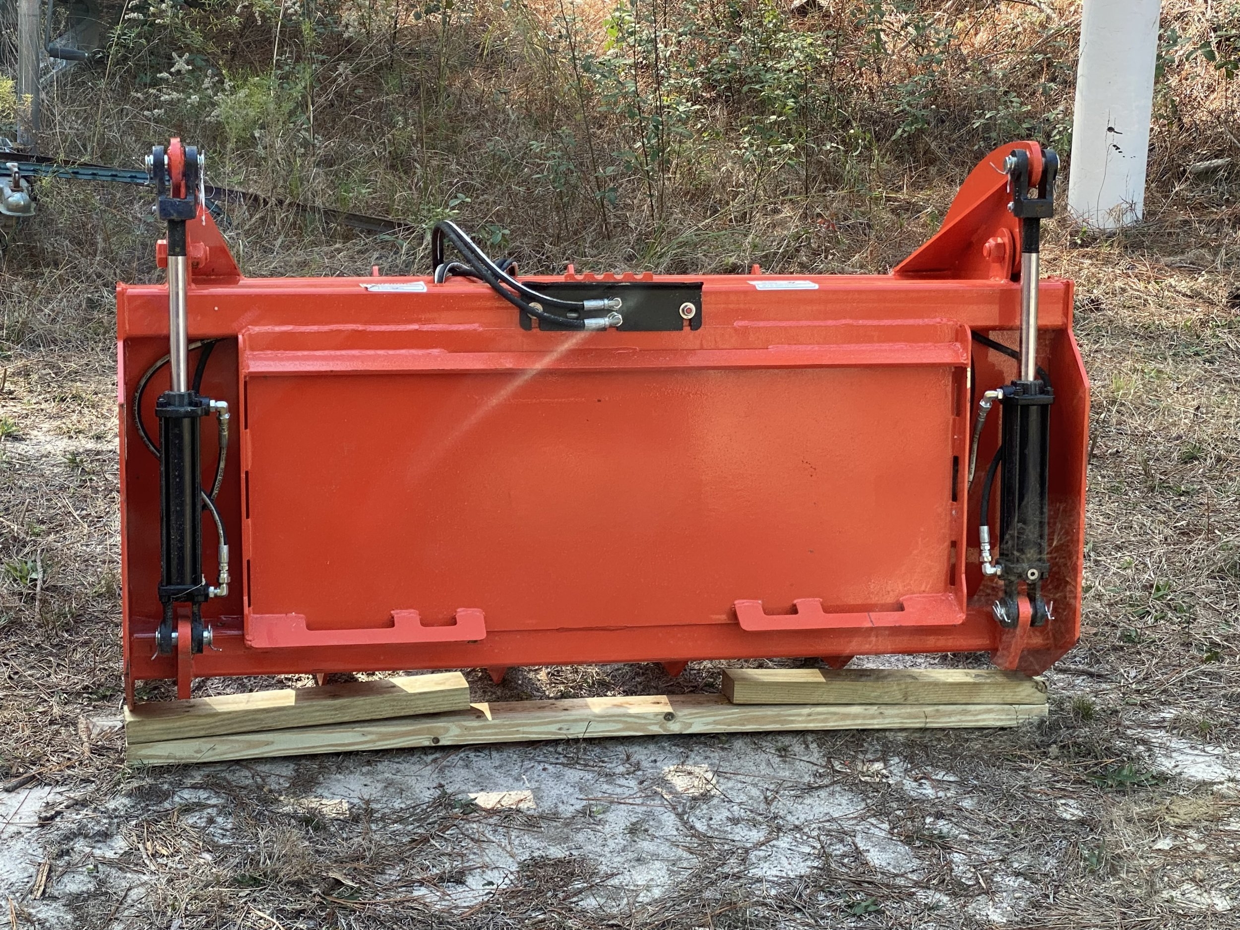

I also ordered the second Kioti rear port kit and ordered the top and tilt link kit from Michigan iron.

Got the grapple today but can’t use it until my Kioti 3rd function kit comes in. I sure hate waiting. LOL. Hopefully won’t be too long.

Lastly, my Michigan Iron hydraulic top/tilt setup shipped today so hope to have it sometime next week. Just like the grapple, just need my second rear hydraulic port kit to show up so I can start using both of them.

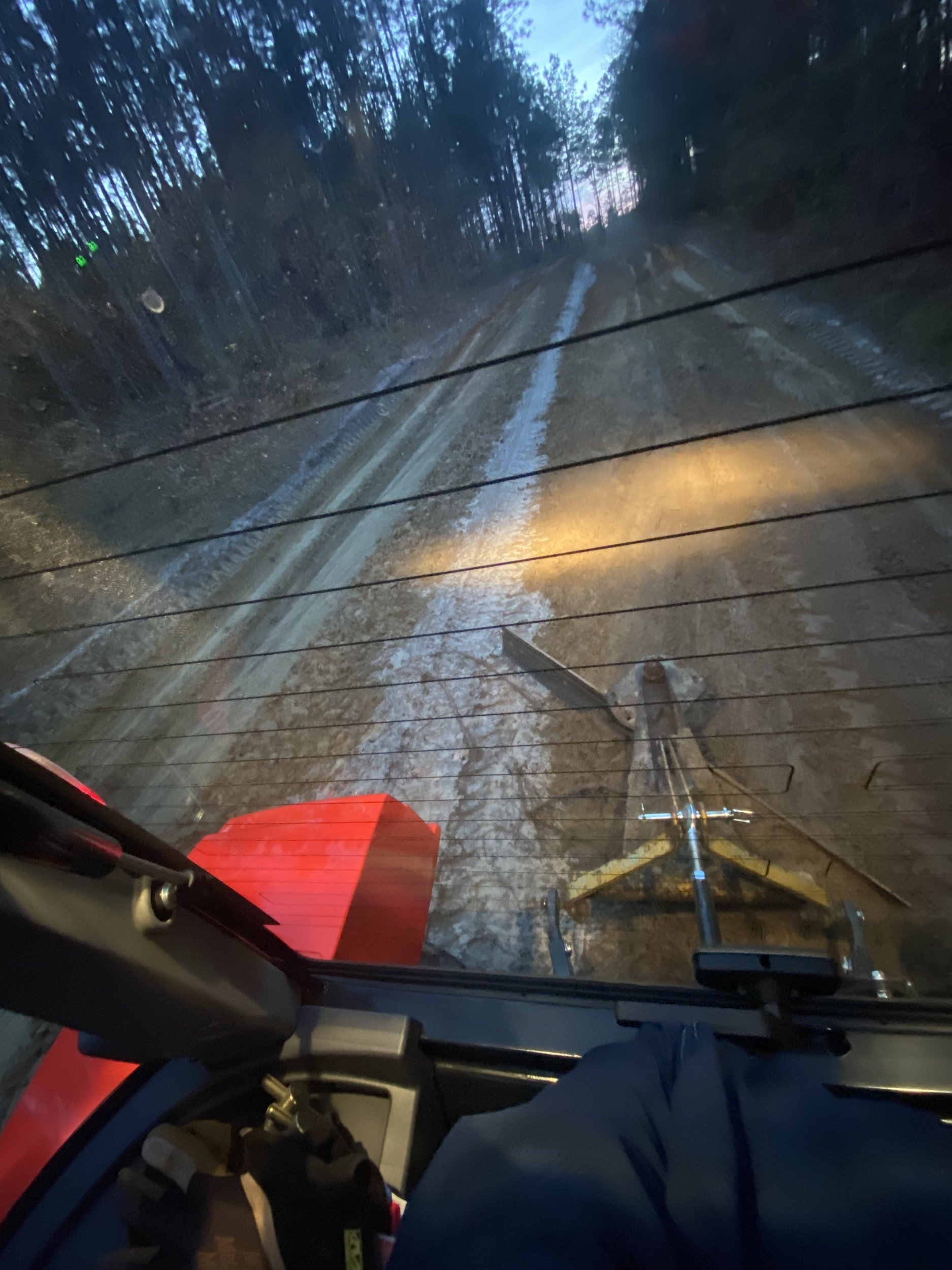

Could really use the top/tilt kit now as I’ve been working to crown one of our roads and I’m tired of having to constantly make manual changes to the blade tilt.

That grapple looks quite beefy! I like how it has closed panels. That should help protect the grill better.
/ Kioti OEM 3rd Function vs the Lane Shark WR Long kit?
#9
That is one of the features I really like also. It also has the cylinders and hoses protected fairly well. Would love to have had one of the 66” Wicked ones but it would have cost me at least $2k more than this one. Considering my usage for occasional cleanup around our property, I’m thinking this one will serve me well Though.

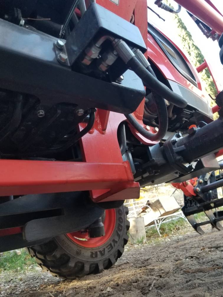

Overall though I am satisfied with the option. The only problem I have had with the 3rd function is brush disconnected one wire connector. I pushed it back together and kept on working. View attachment 837704View attachment 837705View attachment 837706
Can you flip that box 180 degrees and run the hoses out of the top of it?
/ Kioti OEM 3rd Function vs the Lane Shark WR Long kit? #11
Yep, I'm going to try that. If there's any problem, I will make a better one.
/ Kioti OEM 3rd Function vs the Lane Shark WR Long kit? #12
Yup, I saw that and a lightbulb turned on. Flip that over. The hoses are a hazard for grabbing brush.
