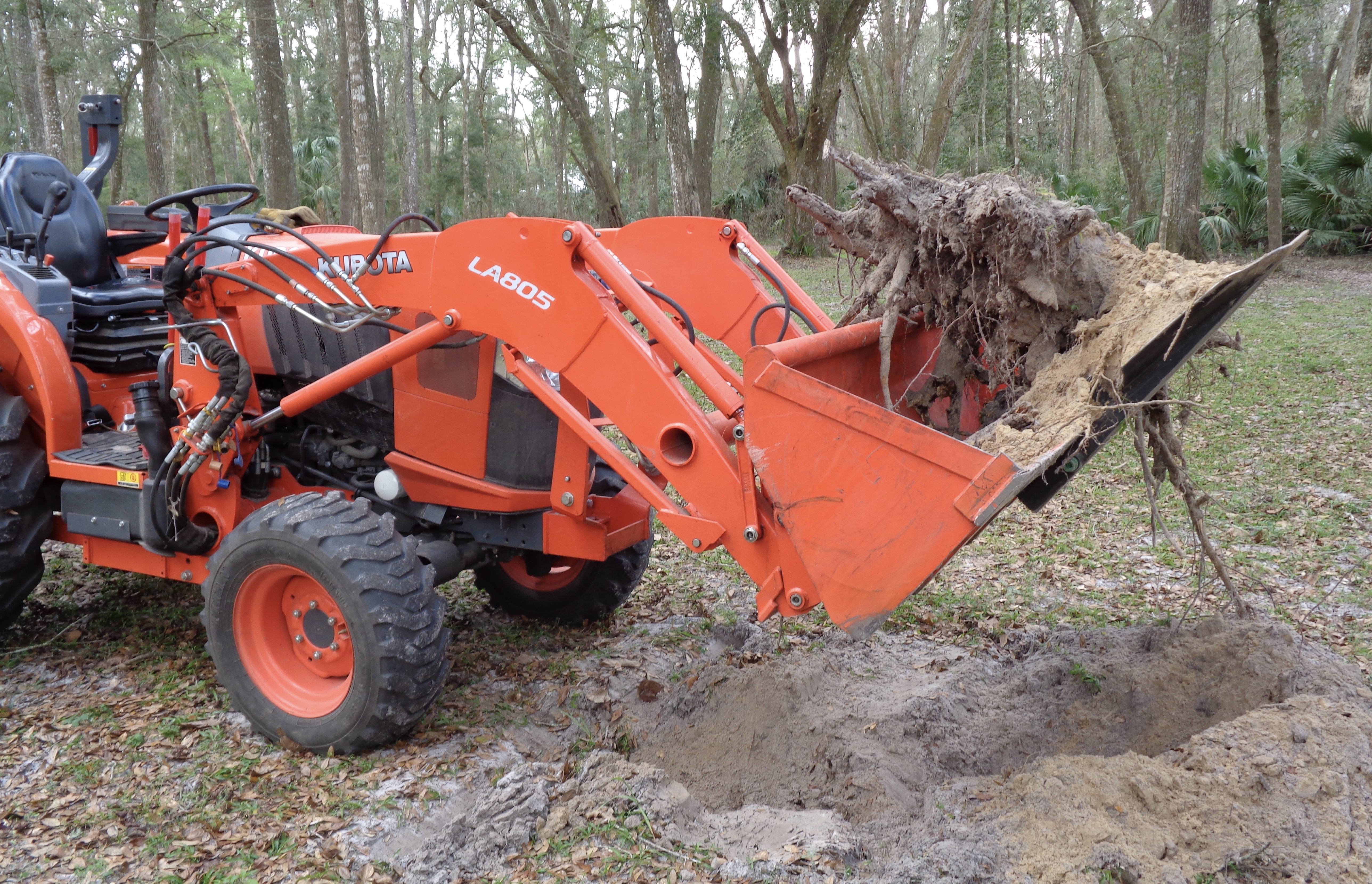

I cut stumps near grade level then treat immediately with undiluted 2,-4d herbicide. Wait one year and the small roots will have decayed and stumps come out pretty easy. The stump has to be dead for the roots to rot, hence the 2,-4d treatment.
Roots decay 12 months in Florida. Your decay rate may differ.

Interesting that people say a tractor isn't made to push/remove/pull trees down. I have two huge piles with over 100 small 3" to 5" trees which I removed with my tractor and a proper implement. The Piriniha will also dig under a small tree and lift it right out of the ground and no the RR won't as easy/quick because of the lower tooth bar and that is hard for me to admit being the RR greatest fan for years.
