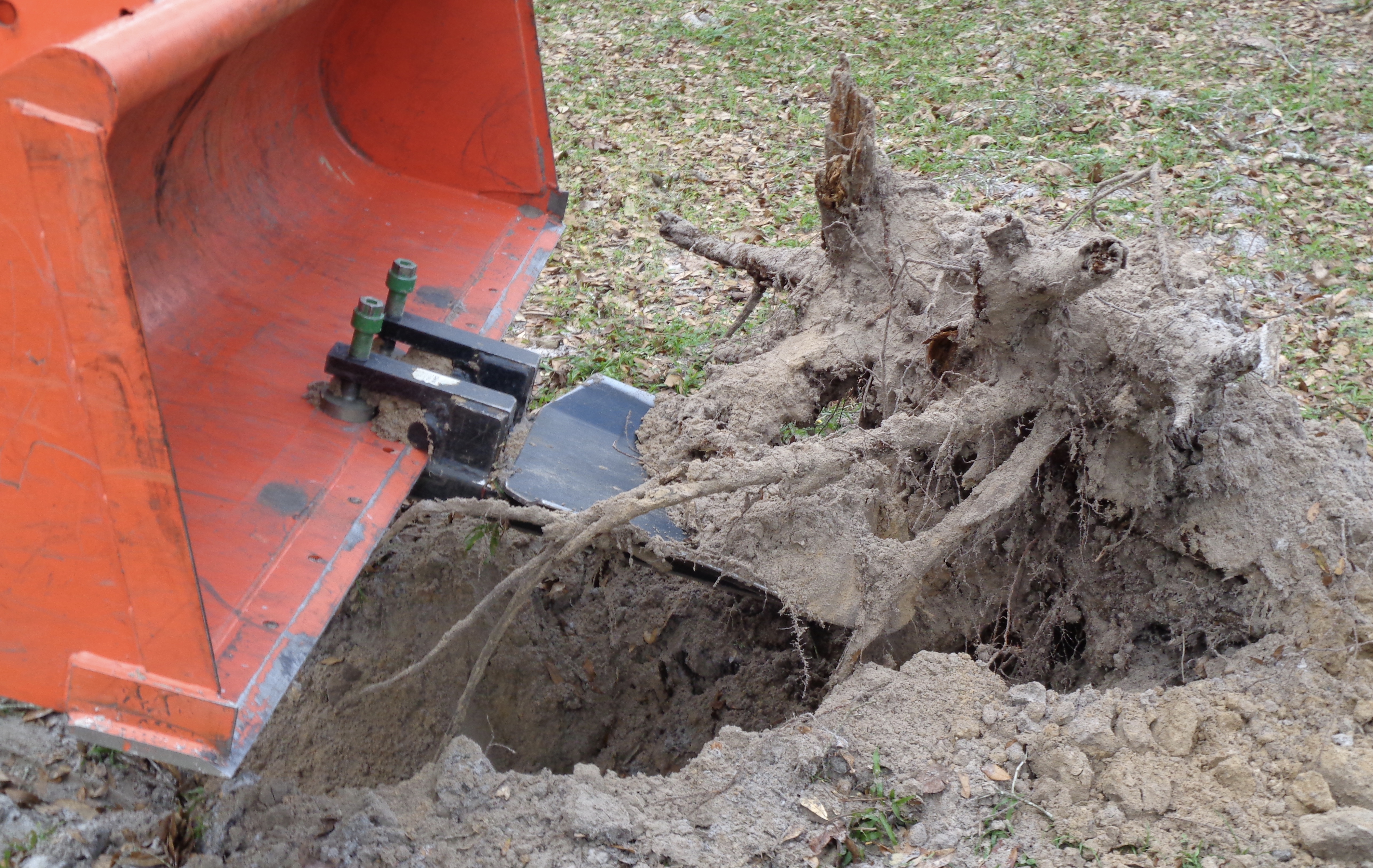

My Kubota L3560, slightly physically larger than your L3301 but weighing 3,700 pounds bare tractor, is barely heavy enough to push over 3" hardwood trees. Kubota MX series is also around 3,700 pounds bare tractor but physically larger.
If you convert to an L3560 you can probably continue to use your existing implements. If you convert to an MX series you will need to consider buying an increment wider implements.

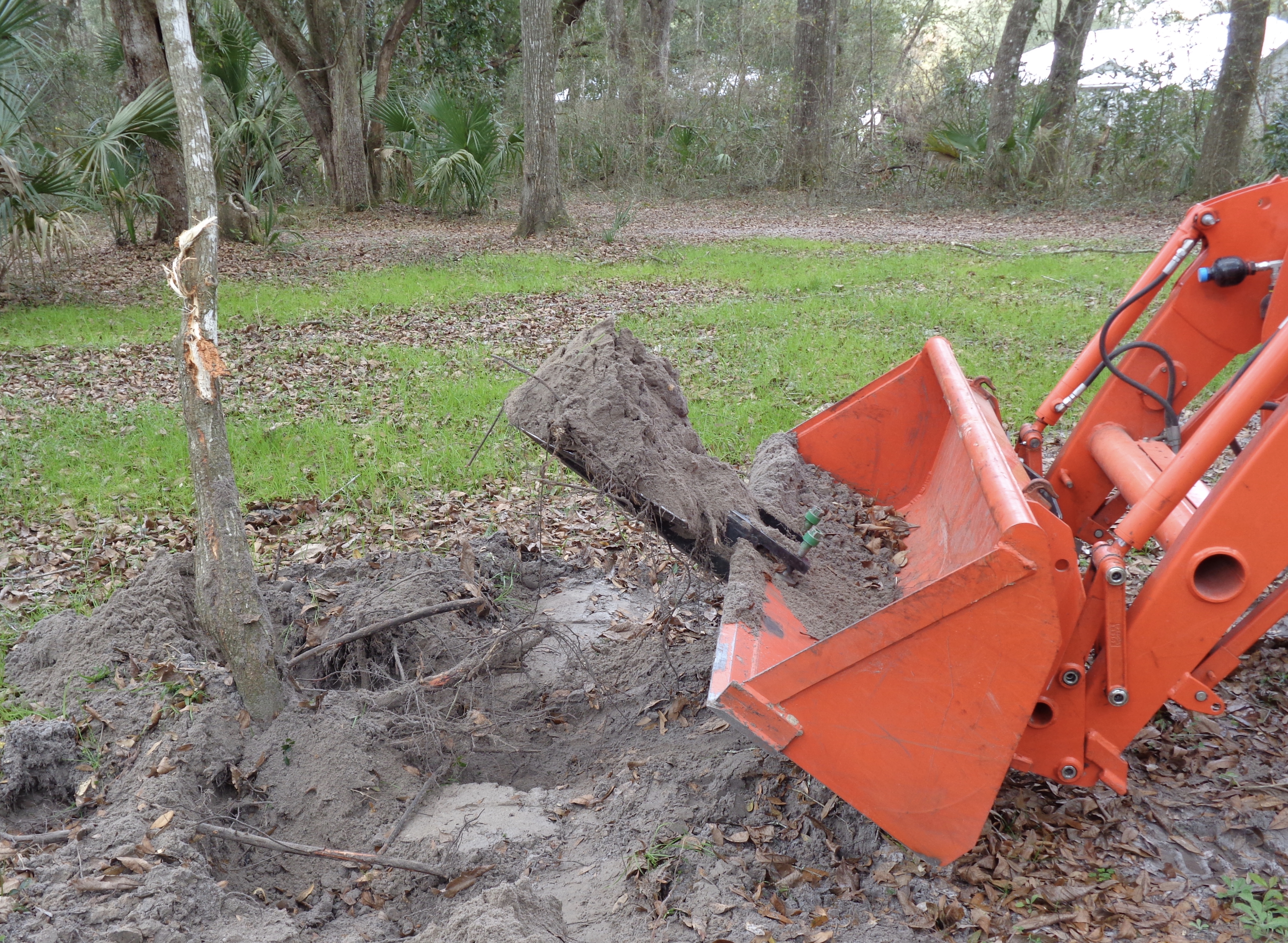

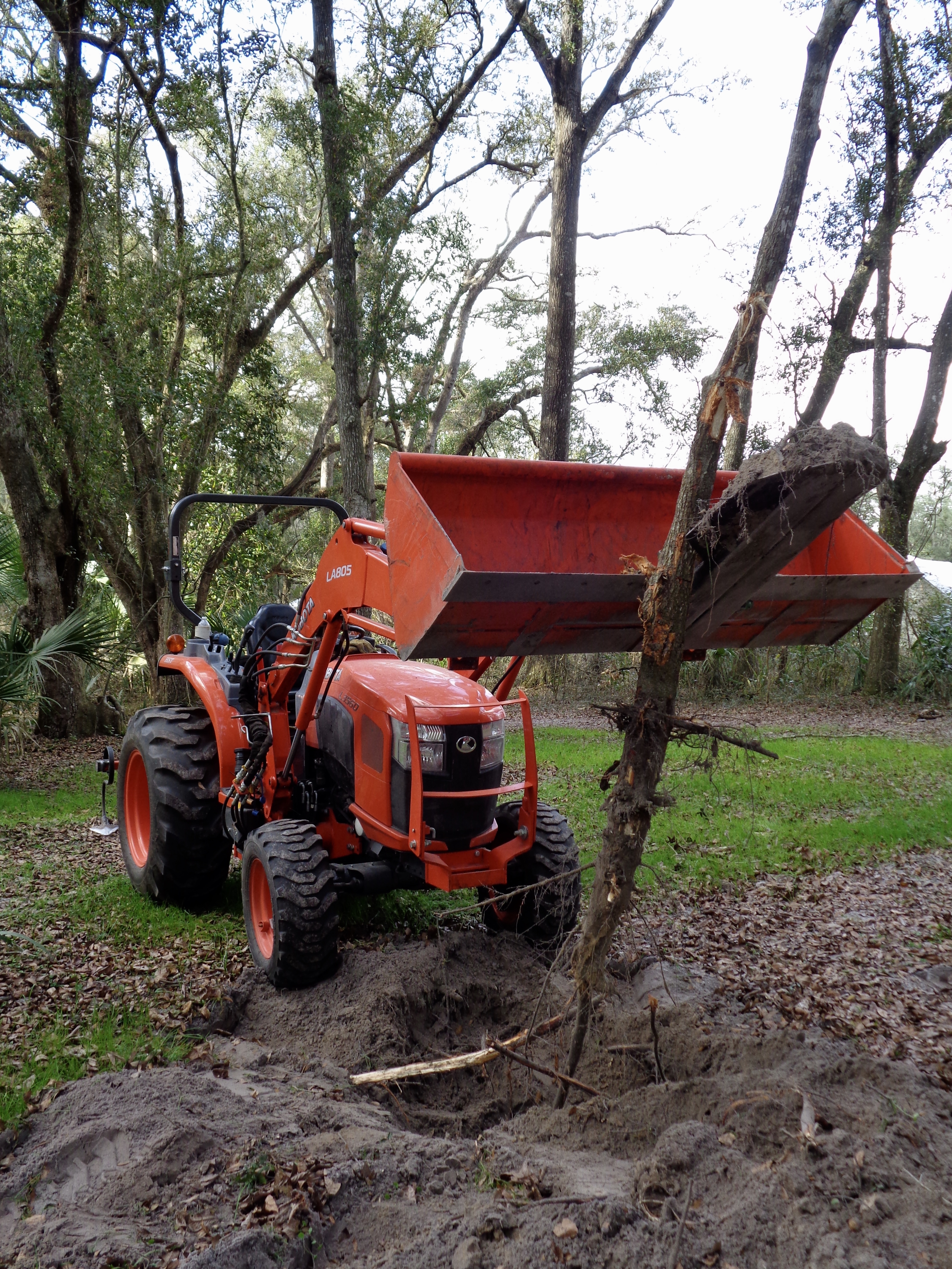

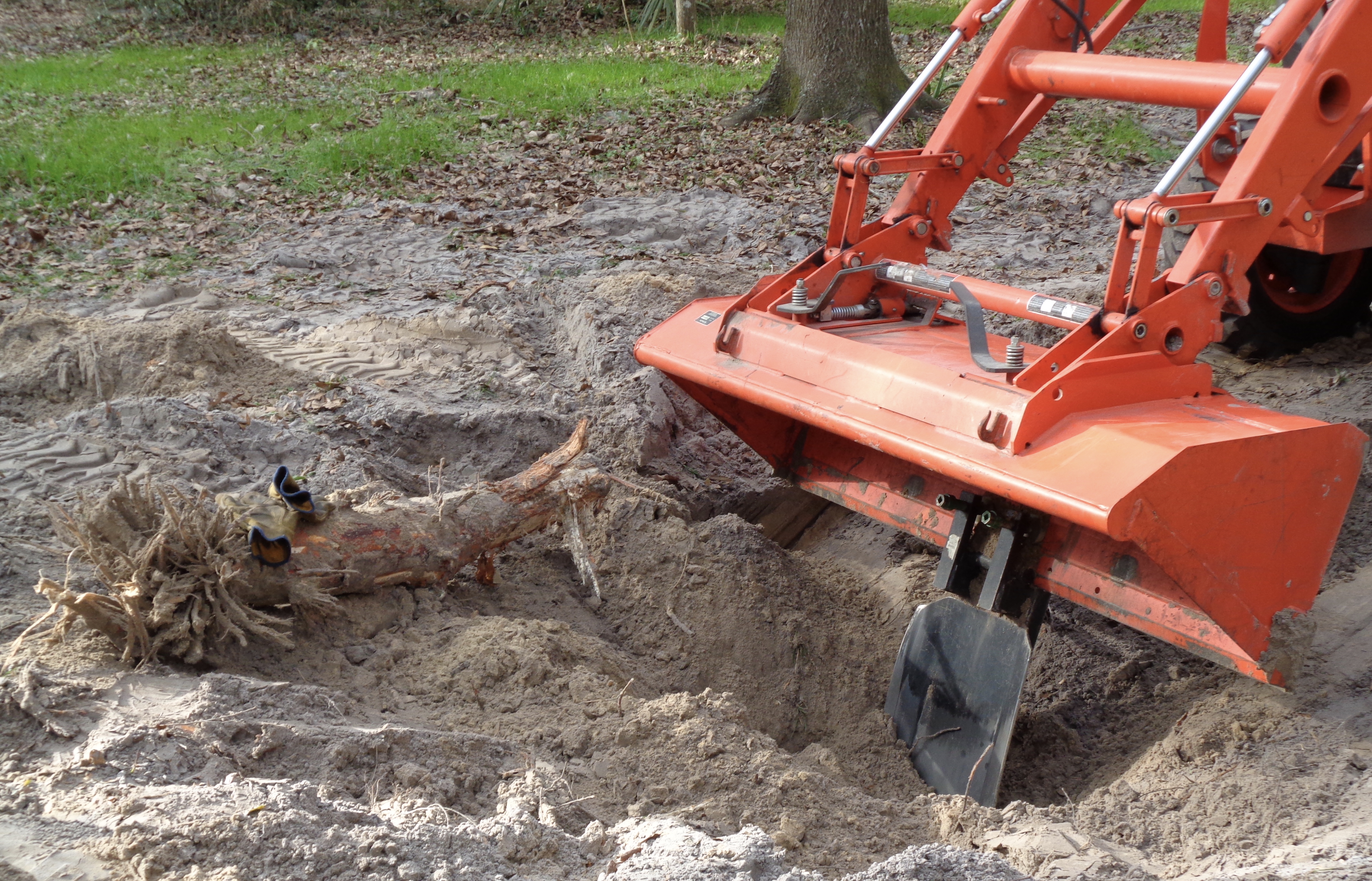

A Ratchet Rake bucket attachment grips trees where an unadorned bucket tends to slip.
A Bucket Spade bucket attachment is also useful.
Neither will meet your needs on an L3301. You need additional tractor weight.
In my opinion the L4701 is rather an orphan and future resale is likely to disappoint. Better to consider a mainstream MX, which are priced very close to L4701.

I took out 3 non producing fruit trees last November with my 33 hp LS. It wouldn’t have much luck pulling them out by just using the bucket and fel.
I used the clamp on spade, similar to Jeff’s, to loosen up the root system first, then pulled them out nearly in tact with a chain. Barely needed to get off the tractor.
If you have the wherewithal to get a bigger tractor, that is one way to go, but finding workarounds is a lot cheaper, and at the same time, it was kinda fun to do.
