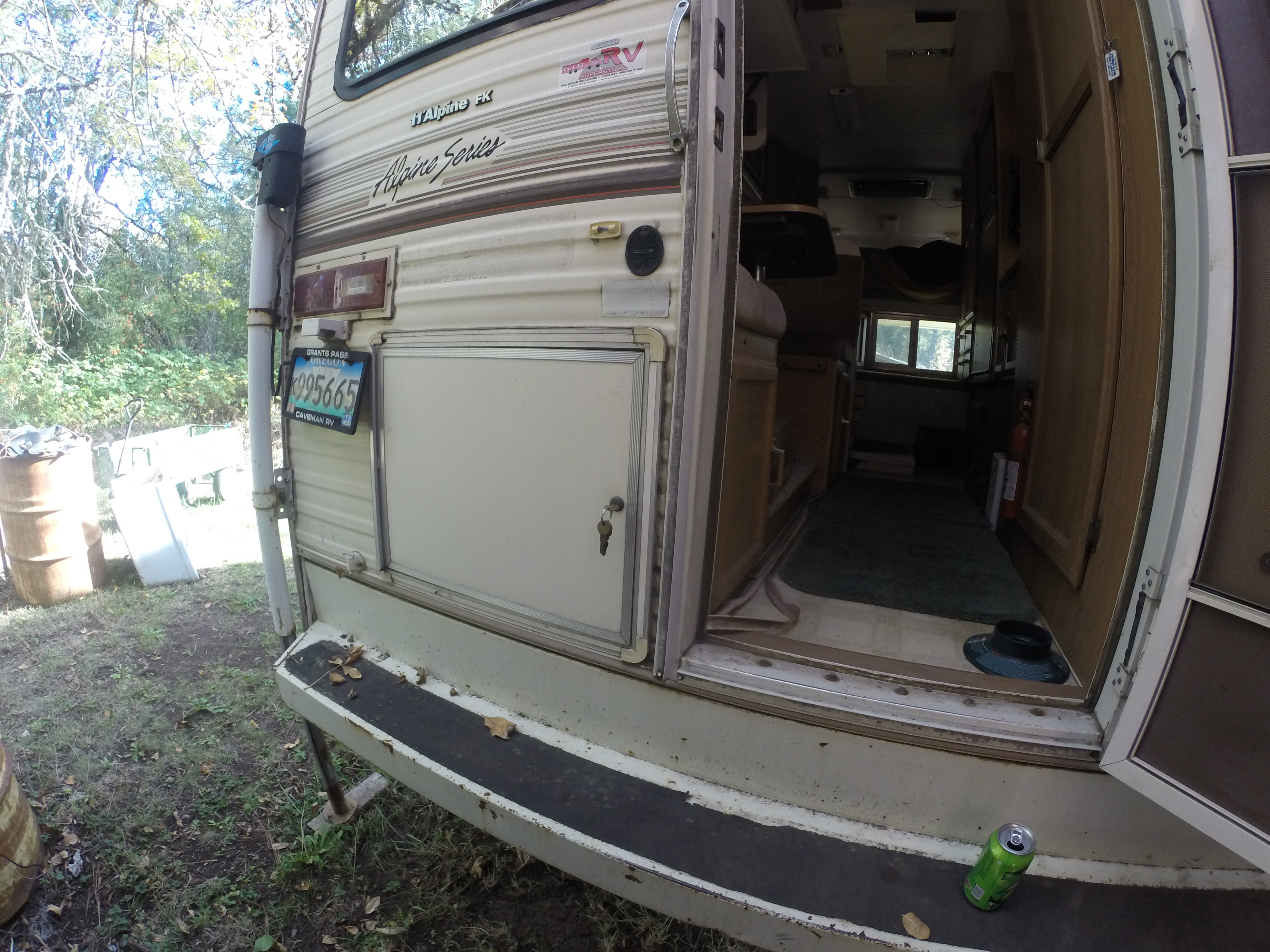

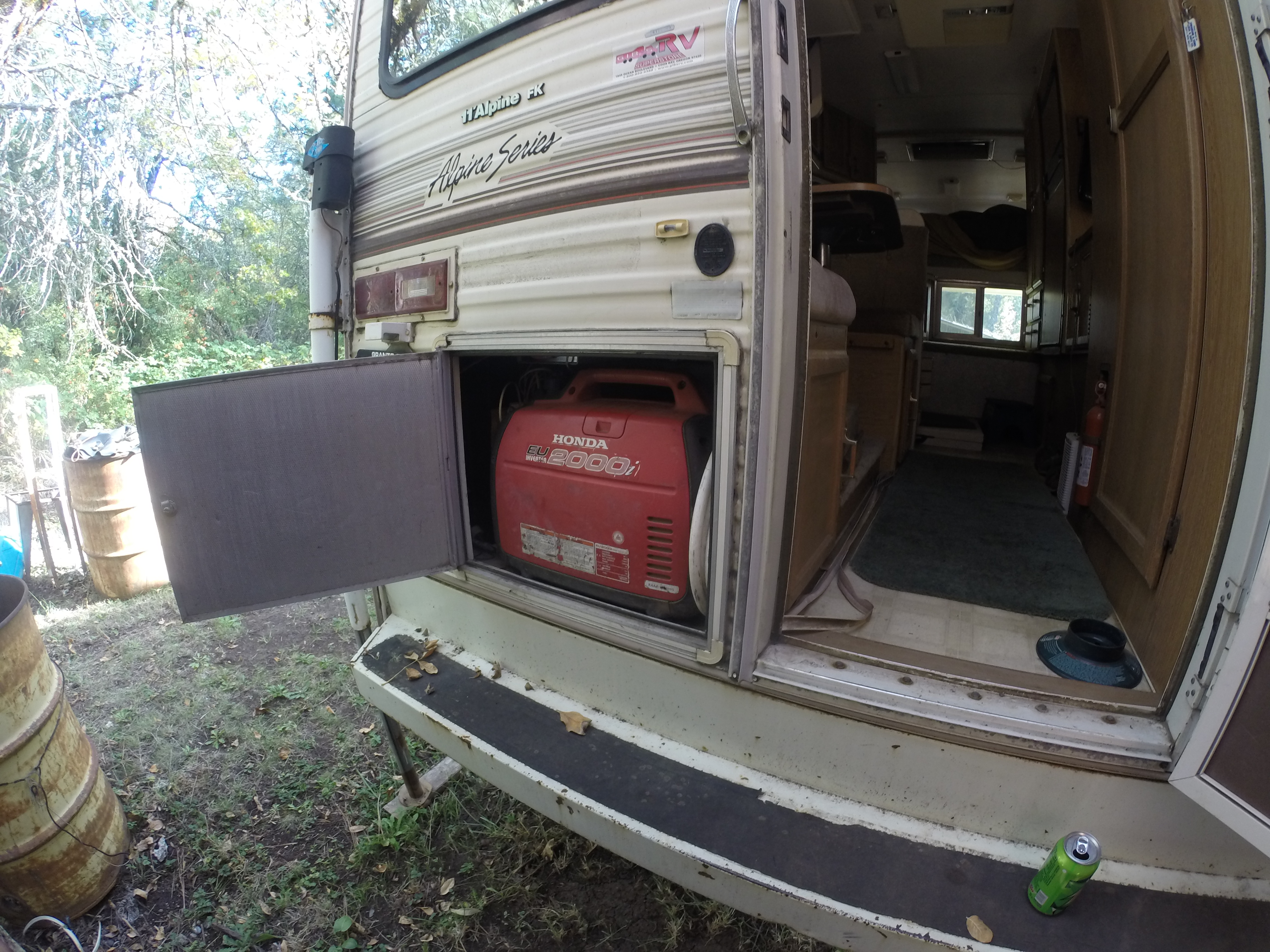

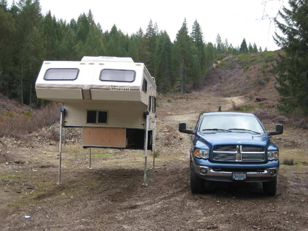

I love my Honda EU2000i. whisper quiet, economical on gas, ECO mode. 46 lbs. 11 amps. That's the backside of my cabover camper. It will run the microwave or the rooftop AC with no problem. It's been more than enough for my needs. Lately I keep in in the back seat of my RAM 2500 which I use to tow my tractor in my dump trailer. I set it in the bed and have it running and connected to the battery charger strapped to the tongue on the trailer, charging the deep cycle battery when I'm using it. It's a very handy setup.
