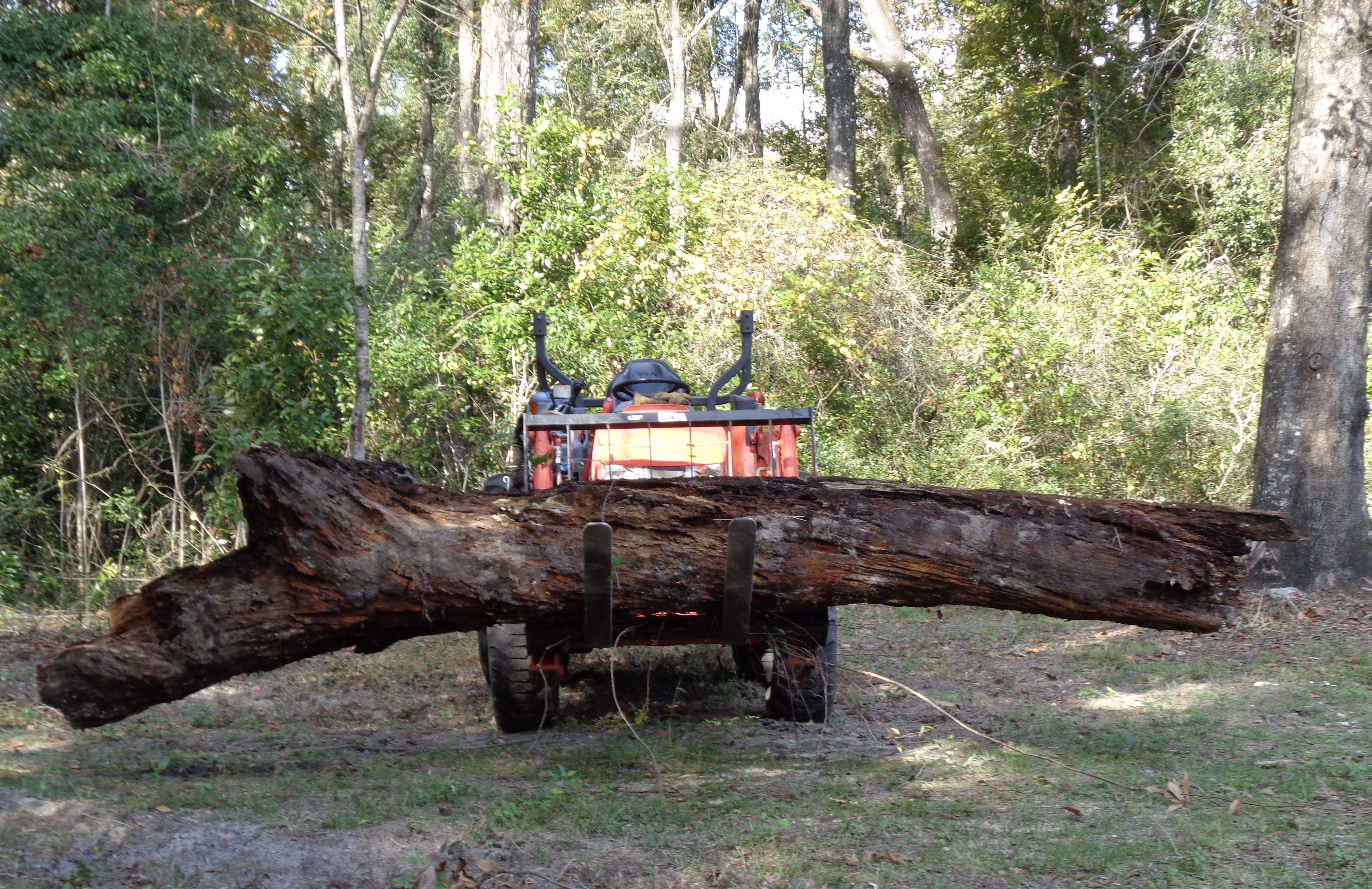

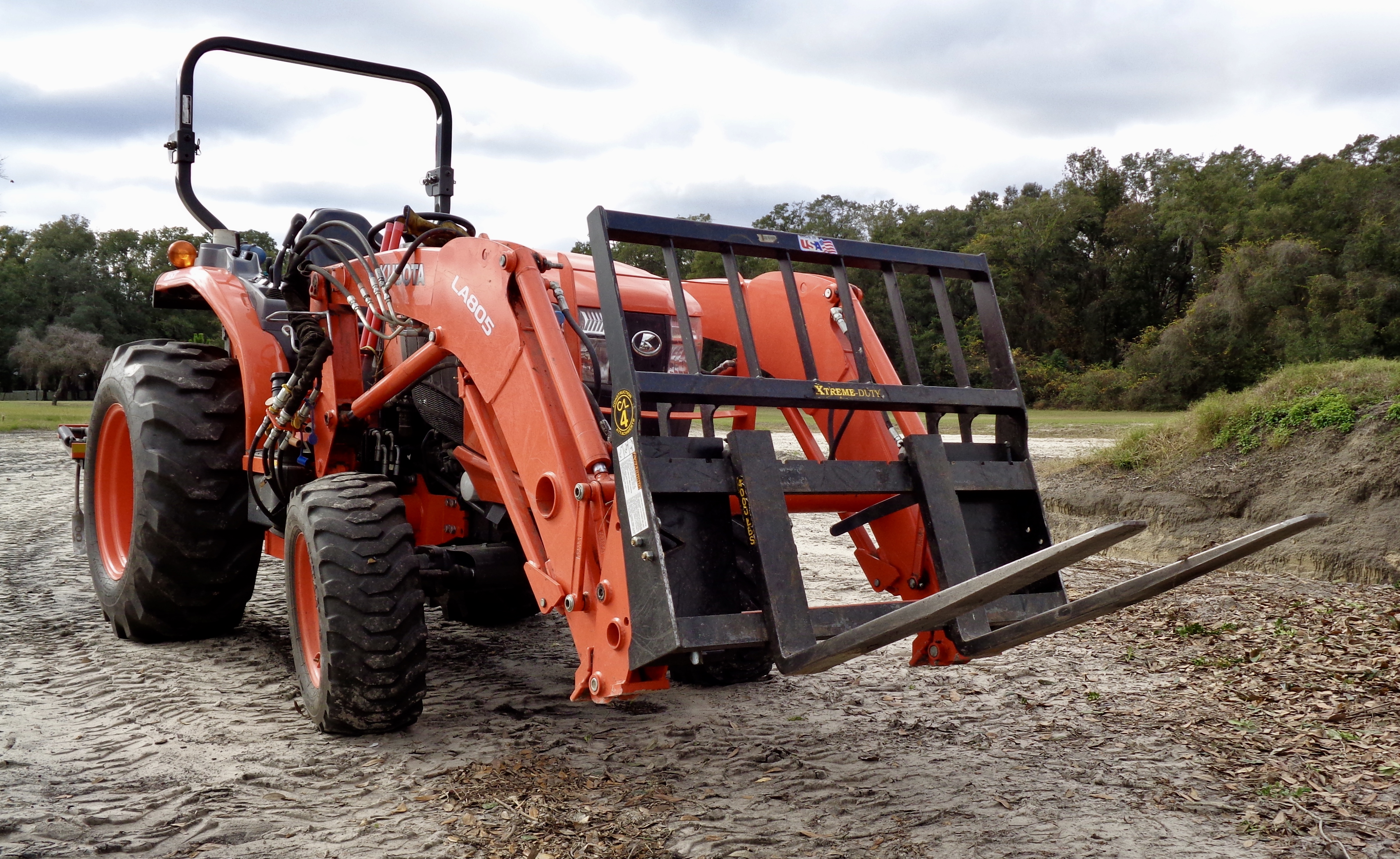

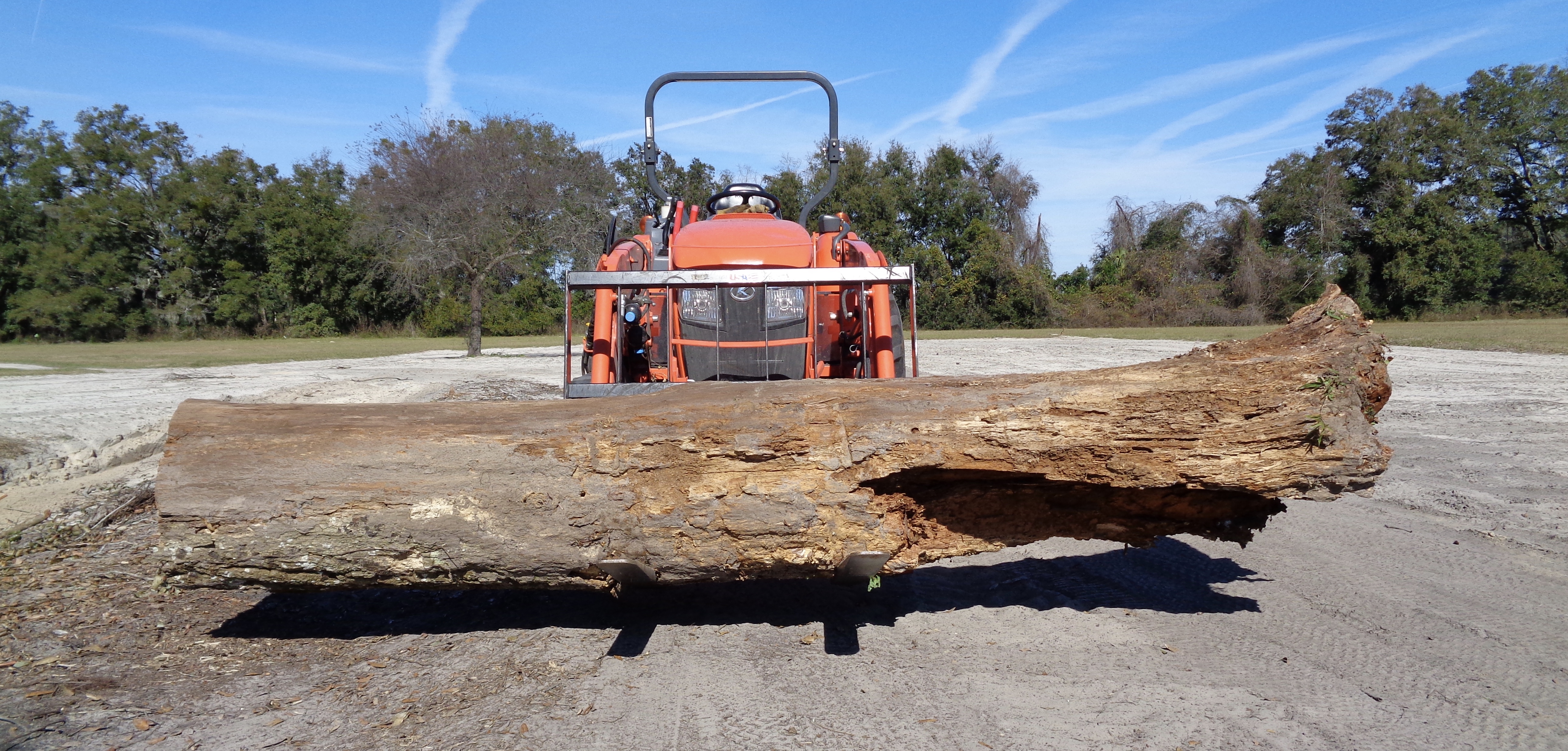

2) For moving trees SSQA adjustable-width Pallet Forks will work as well as a grapple. Simpler, cheaper; no front remote hydraulic connection necessary. 32", 34" or 38" Pallet Forks will match the lift capacity of your B2301 FEL better than longer forks.

3) If you pull vines on a fence the fence usually comes out of the ground before the vines. Spray the vines with Gordon's Barrier, Crossbow or Crossroad, Rural King's private labels formulation of Crossbow.

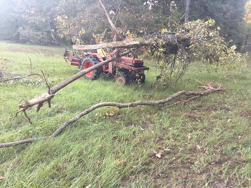

Whoops, someone forgot to tell my little tractor it could not uproot trees with the EA 55" Wicked Root Grapple! :shocked:
