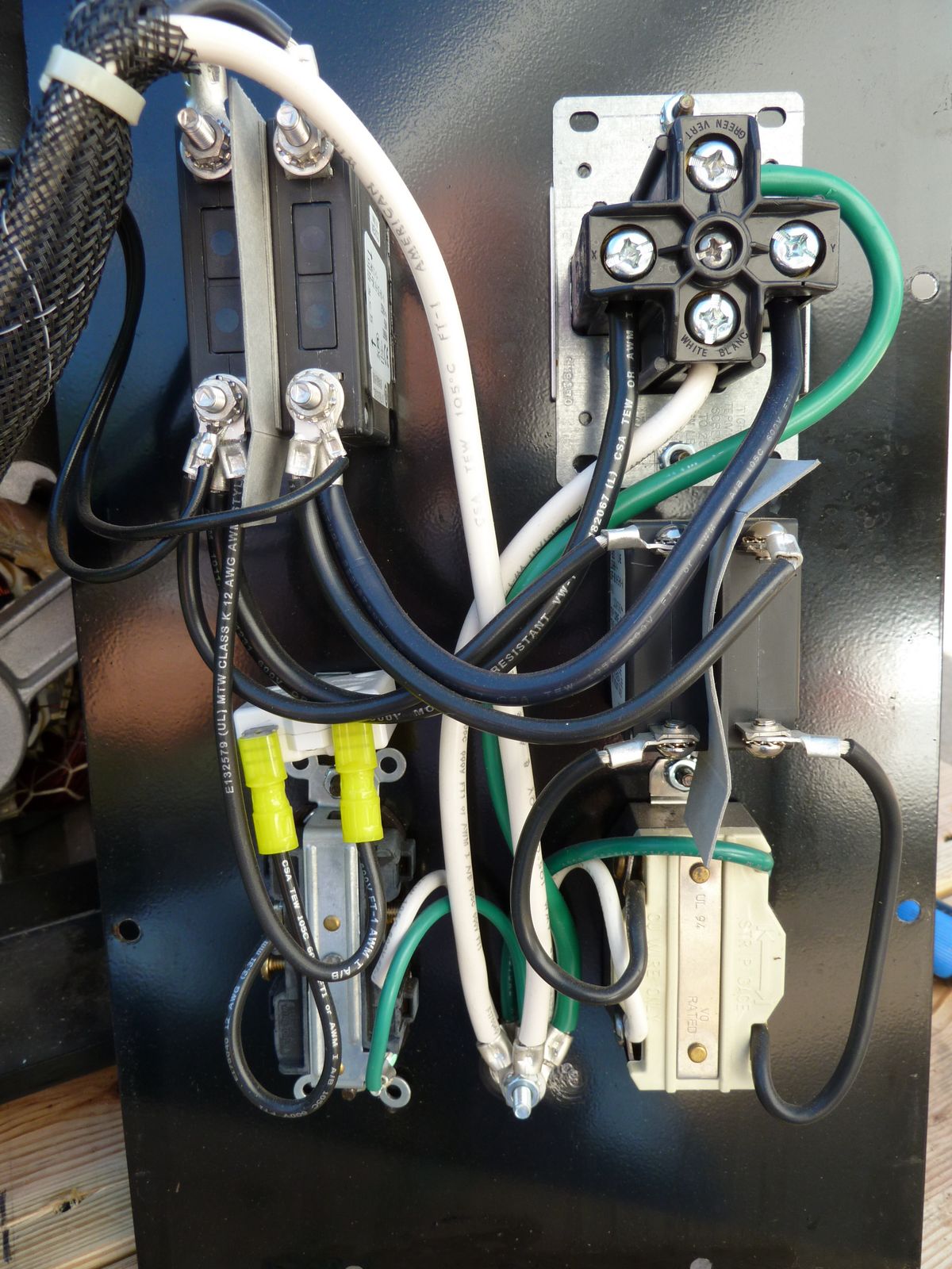

PTO Generator Now Wired and Tested
After much consideration, I modified the generator to have a Floating Neutral and made up a plug that Bonds Neutral to Ground for standalone usage.
A clamp-on meter from HF was used to test current draw on all my high usage items so I would know what combinations I am able to use with the genset at the same time.
I also mounted a remote 120v outlet on the front of my TSC carry-all for a Kill-A-Watt that can be seen from the tractor seat (or from the ground) for properly setting frequency.
An outlet tester shows proper configuration at 120v outlets in the home when the genset is connected and running, and the generator shows the same in standalone mode when using the bonding plug.
Yesterday I did a full test of the Generator and ran everything in the house, setting the frequency at 62hz with no load and then testing first lights, high usage items then electronics.
My high usage items are a 1.5hp 650ft well pump, electric dryer, range/stove, and a 4 ton central A/C unit.
The generator had no problems with any of these and will easily run the well pump with any other single high usage item along with lights, refrigerator/freezer, TV/Satellite and PC/Internet.
The Kubota has plenty of power with 37 PTO hp and I never saw lights flicker, the rpm vary much or the frequency go below 60hz under the highest loads.
This setup may not suit everyone but will provide emergency power to anywhere in my home and barn which is what I was after.
Thanks to all who responded, your advice was appreciated.

   / Should I change my PTO generator from Bonded Neutral to Floating Neutral? #67
Going to show us the "plug" for bonding Stoney? IMHO the only safe way to do this is with welding cable,
one piece, bolted connections at each end. Safety trumps convenience every time. I'd settle with a welding cable extension, the connectors are solid. Put on some kind of lock with a key that's on your
keyring. There should never be a way of that being disconnected without you knowing. Give **** a place to happen and sooner or later, it will.
#68
Currently mine looks just like the one below, except I used a 20amp 120v capable plug with a 10ga jumper.
May make up one using a 50amp plug with a 6ga jumper though, since to connect the genset to the house it would have to be removed as my cord uses that receptacle.

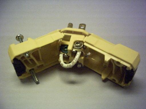

No, the grounding electrode (ground rod) has nothing to do with clearning a ground fault.
This is correct, but it's assuming that your generator was either manufacutred without the neutral and equipment ground bonded or that there is a removable bonding jumper. Your generator was not manufactured this way and should not be modified. The generator was designed, manufactured, and tested by a third party to ensure that it meets certain safety standards. Modifying the generator changes the system, voids the tests, is prohibited by code (see NEC 90.7, 110.2, and 110.3), and would not be recommended by anyone who understands the hazards involved.
The purpose of the neutral to equipment ground bond is to conduct fault current. If you have a fault between the ungrounded (hot) and equipment ground, then all of the faul current must flow through the plug/jumper in the photo. I would not trust that and would not be surprised if the circuit breaker never opened during a fault, as the resistance of this configuration is much higher than a solid connection. That is a fire hazard. Also, if there is a bad connection in the plug/jumper and there was a fault, the chasis of the generator would be energized and you could be shocked or electrocuted. The same is true if you separate the neutral and equipment ground and connect the generator to your premises wiring system the way you describe. A bad connection at the plug will result in shock/electrocution hazard and/or fire hazard if you have a fault between the hot and equipment ground.
I agree with most everyting you are saying,, All except for the part about the 50a plug and receptical not being able to clear the fault.. If the plug is UL inspected and sized for the load then there is no problem useing it..
