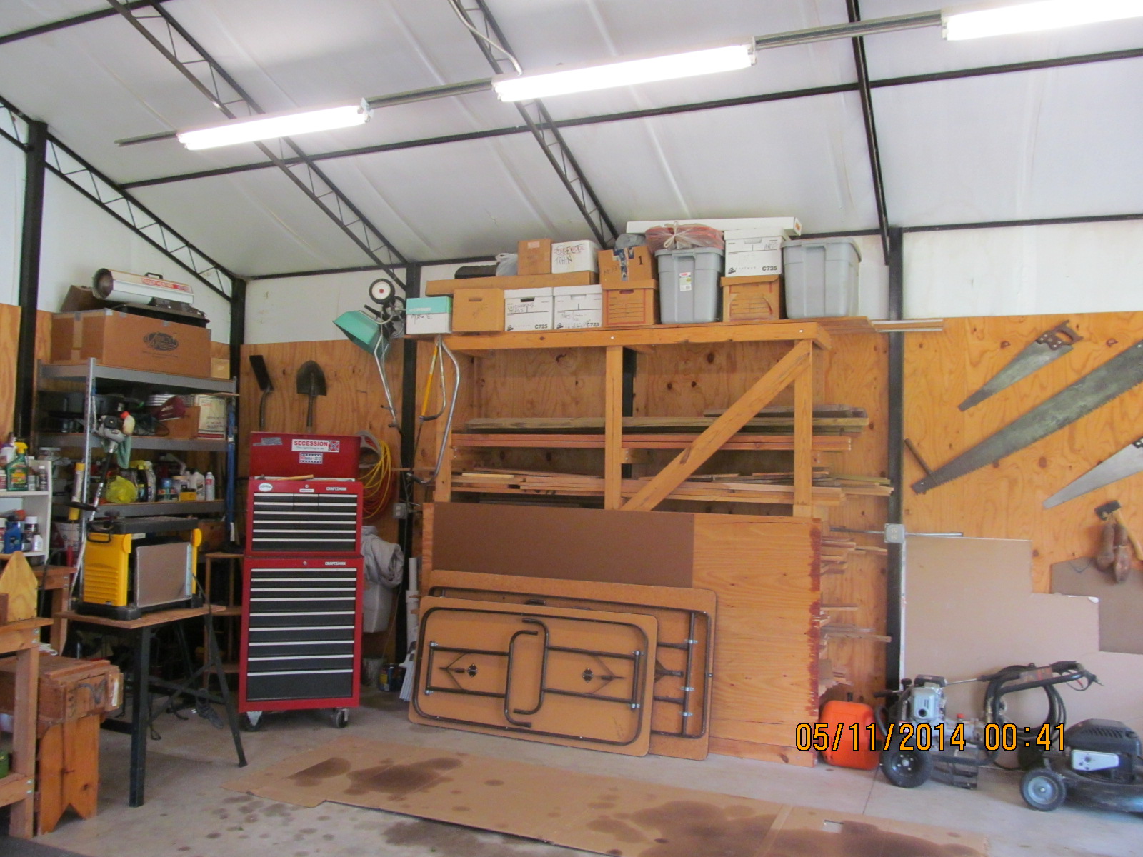

I left my OSB unpainted because I know how much paint it sucks up and I'm OK with the looks. If I felt it had to be painted, I would have gone with a different option. Probably metal liner panels like I have on the ceiling.
/ Shop Walls #27
I went with OSB and painted it white. Looks? Fair to poor, it does suck up the paint. It is a shop though and good enough for me. Mine is also OSB every where, wall and ceiling.

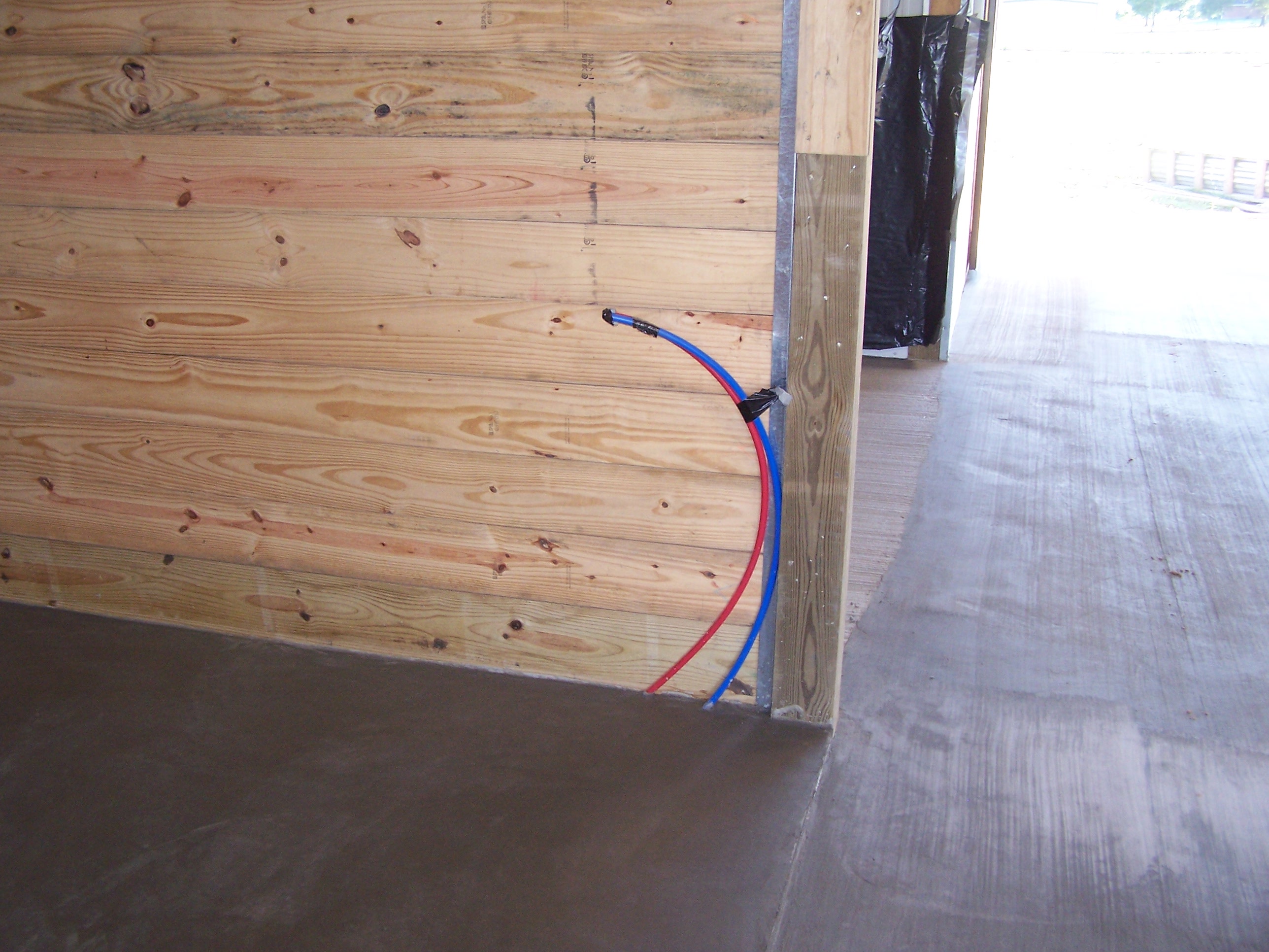

My definition of inexpensive is probably different from your definition. My Morton stables has 2"X8" tongue and groove with the bottom board being ground contact. It looks nice and has absorbed a lot of impact from 1500# horses hooves without any damage. I used Menard's as an example for pricing. You could use 20' sticks with the bottom treated and the 2 above it not treated. That would give you your 24" height and 20' of wall length for $100.
https://www.menards.com/main/buildi...nd-groove-treated/1111260/p-1444422142679.htm
https://www.menards.com/main/buildi...ellow-pine-lumber/1028887/p-1444422743797.htm
My walls are 8' tall but this gives you an idea of what it would look like.
