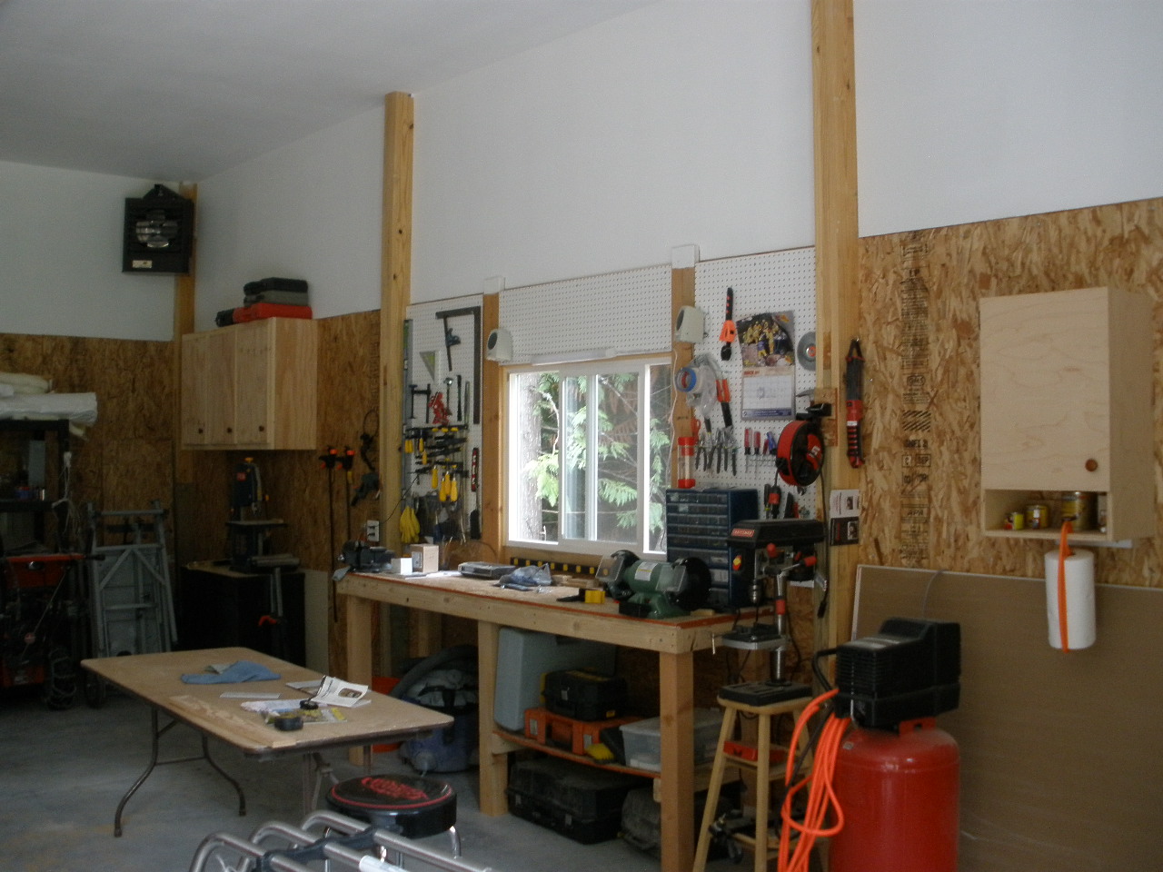

Metal would be nice. I have T-11 exterior paneling on the bottom and OSB on the top 8 feet. OSB doesn't look bad and it's mostly covered with shelves, pegboard and hangers.

OSB on the bottom 8 feet and drywall for the upper 4 feet. I just raised the OSB about 3/8" off the floor, I think it looks ok for a shop.

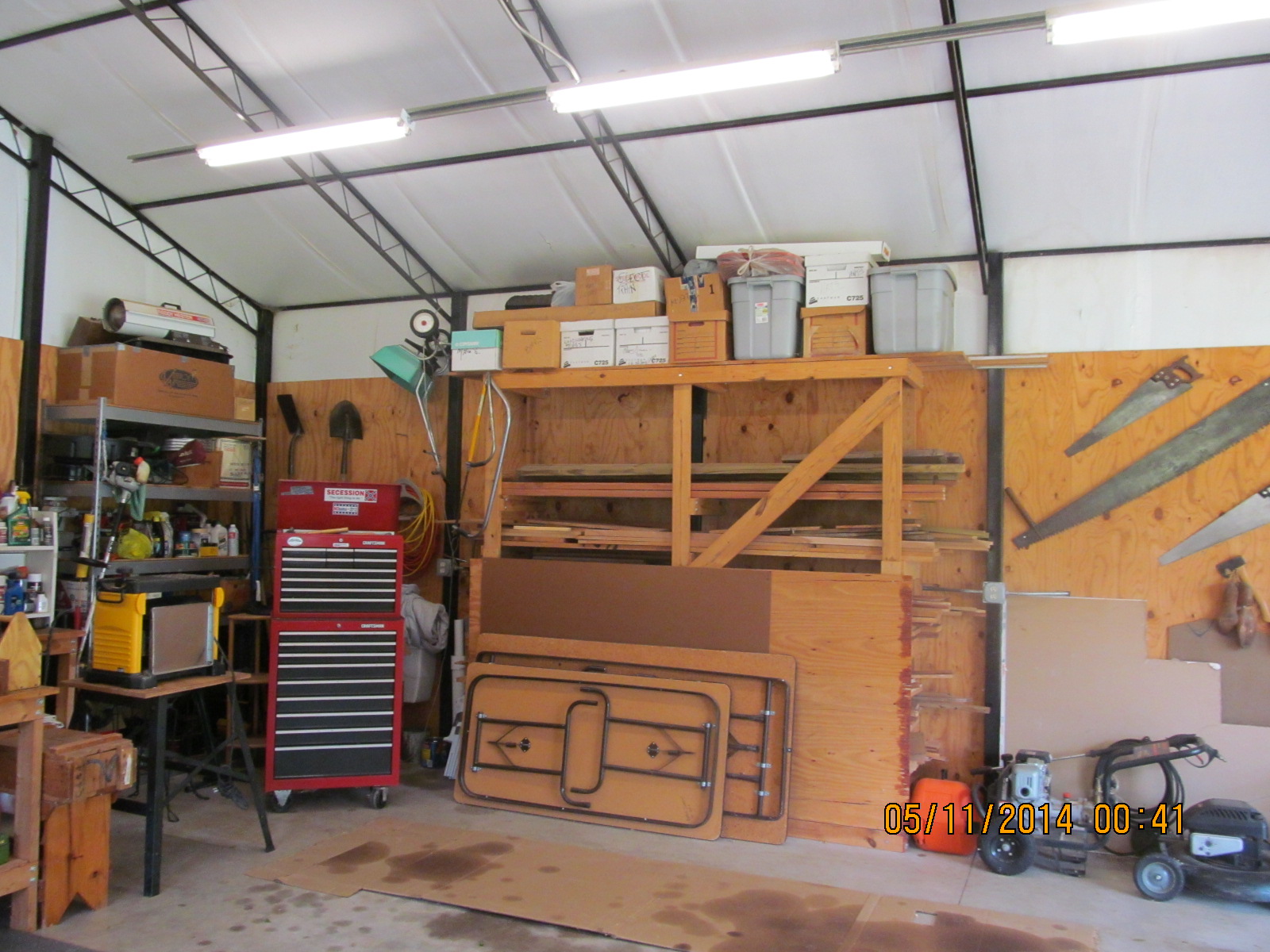

I just put up plywood. Intended to paint it all white, but you know how that goes. The white showing above the plywood is insulation.

I used a 10' 1x4 on the floor as a spacer when I put up my 1/2" BC plywood walls.{sanded on 1 side}
IT worked out great.. & I do get some water intrusion in certain spots when it rains.. but NO wicking.!!!
