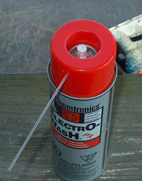

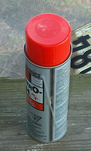

Here is a tip I have used in my repair shop to keep from losing the straw from a spray can.
I cut out the center section of the cap and drill a hole though the side for the straw.
This also protects the valve when the can falls on the floor.
