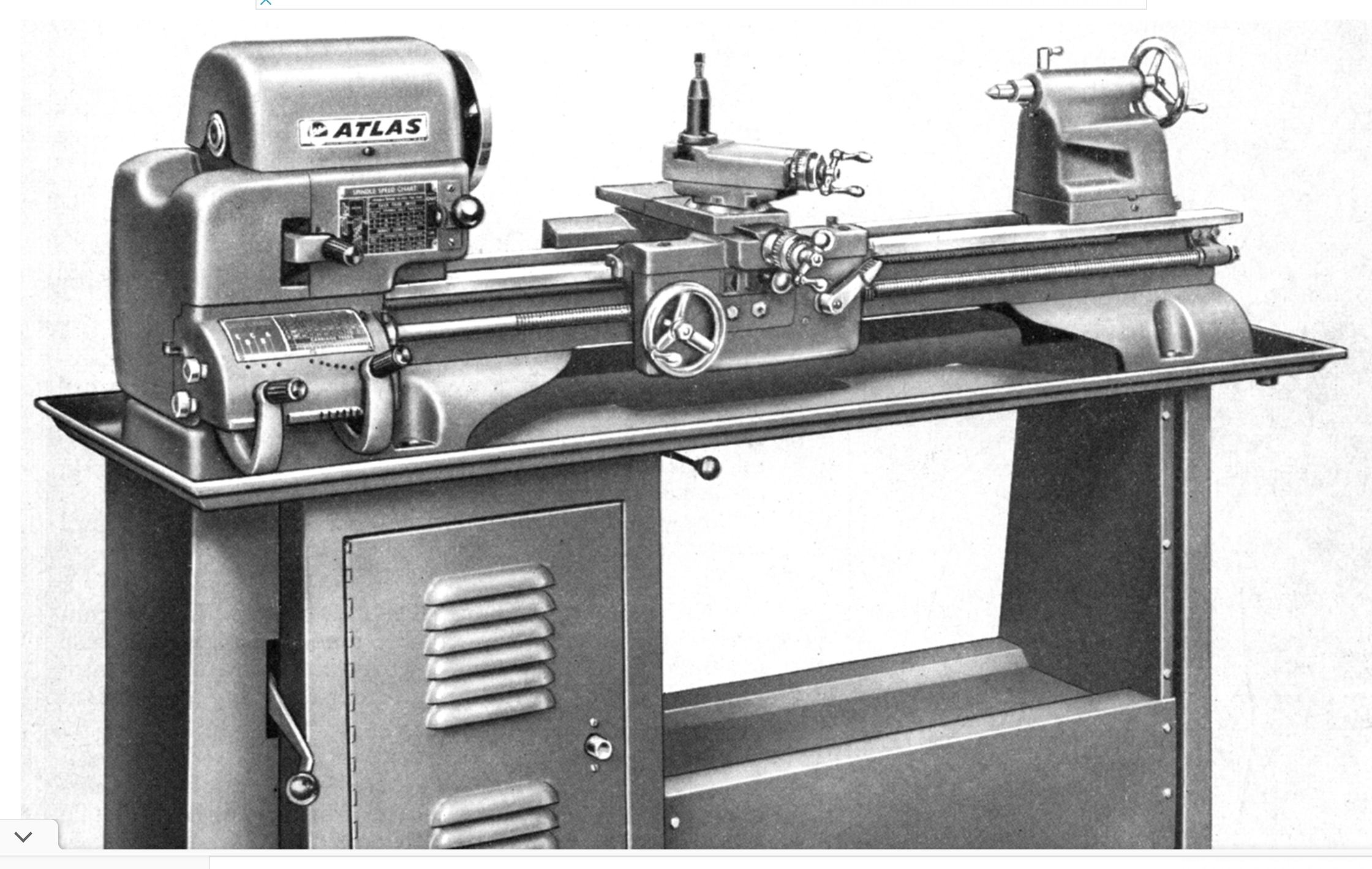

I was looking for a nice home shop lathe when I ran across this light duty 12" Atlas with the factory underdrive and long bed. It came with a ton of tooling - 3 and 4 jaw chucks, all the manuals, quick change tool holders.... on and on. Like new condition.
It wasn't my first choice - I was looking for something more "vintage" or else more modern. I also like a lot of imporrted machine tools from Taiwan and Japan 30/40 years ago. I seems that any country on its way to becoming a modern industrial power needs to make a really high quality machine tools for their own industry. And as they do so, it is a natural for those tools to become a high value-added export for them. Much the same as we saw in small 4wd tractors from Japan and Asia where an industry developed for a domestic use became a good export item.
The Atlas 12" commercial 3000 series was made in England and sold in the US for many years. Ultimately Sears bought it - Back when the Craftsman brand meant good quality... not TOP QUALITY...... but very good quality for the price.
It is adequate for a home shop. For pins and bushings and making tooling it is perfect. It is more than accurate enough for small motor and pump rebuilds. I use it a surprising amount for cabinetry. A downside is that the bore through the headstock spindle is oddly small, which limits using long round stock. And the old lantern style tool holder and cross slide is not as rigid as it should be for accurate work. That means the micrometer cross slide dials are not dependable and that turning to a thousanth of an inch means constant stopping and measuring - but it doe have a rigid headstock with good bearings there. Upgrading to a heavy Aloris quick change tool holder really helped with the cross slide tooling rigidity.
The quick change gear feeds cover every common Imperial and metric threads.
Atlas 3000s are often inexpensive on the used market because of the flat ways - although that way geometry is a matter of preference as much as anything else on a home shop lathe. When new, both styles are equally good. The OEM bearings, gib adjustments, and bushings are first class throughout. Runs very quietly and powerfully on 110v.

O have one of them, fully tooled with Timken tapered roller bearings in the headstock. Got it cheap at an estate sale. Nice machines. Not as nice as my LeBlond Servo Shift however.

No, it's not as nice as a LeBlond or Clausing. I don't really have a use for a real indusrial size lathe, but just like in tractors there is less downside to a large lathe than one would think. Other than pure size of course. In my little shop with 6" concrete floors I could fit and use something at least twice as capable as the Atlas 3000. It gets by. I paid a reasonable price and am not enthusiastic enough to go through all the effort to install a larger machine... so the Atlas will probably stay - even though that wasn't the original plan.
I once acquired a barn cat on a similar basis.
It's rare to see any good small to medium size lathes for sale. Everyonce in a while I do run across really great deals on large lathes that some business wants to get rid of for a pittance. Scrap prices mostly. If I was doing it again, that's where I'd be looking. Problem would be finding one that can be made to run on basic 220v.

Great replies, guys. Keep them coming. Re: Atlas, owned one many years ago. Worked well enough for simple shop repairs, etc. Not a bad option, for benchtop scale.
