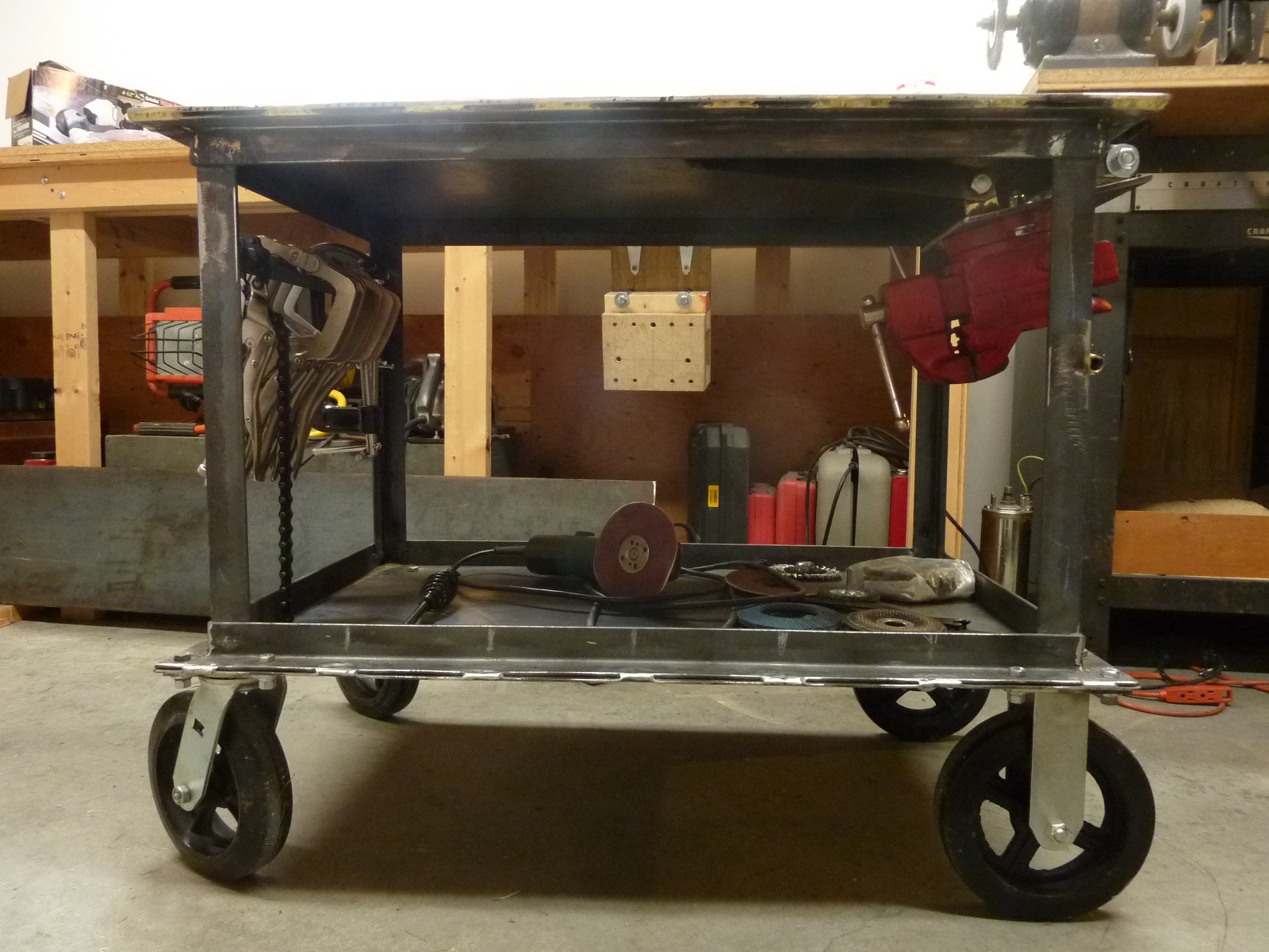

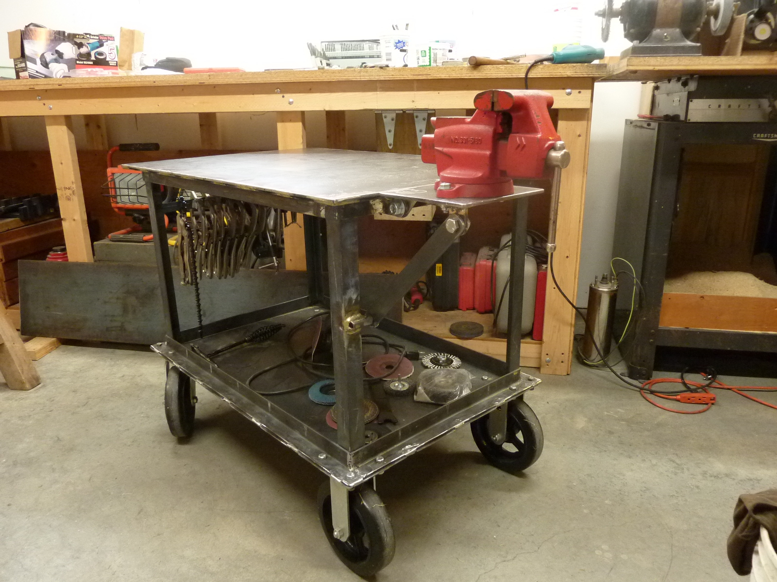

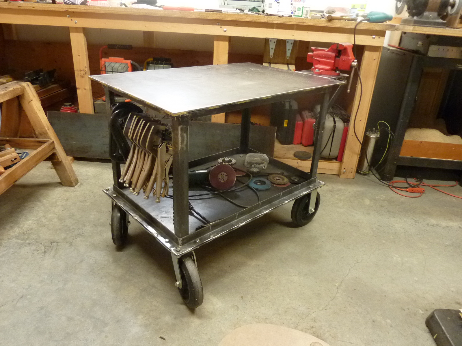

I build this 2'X3' work/welding table and use it every where inside and out. Big caster makes it easy to move. Vise folds down for a flat surface for big stuff.

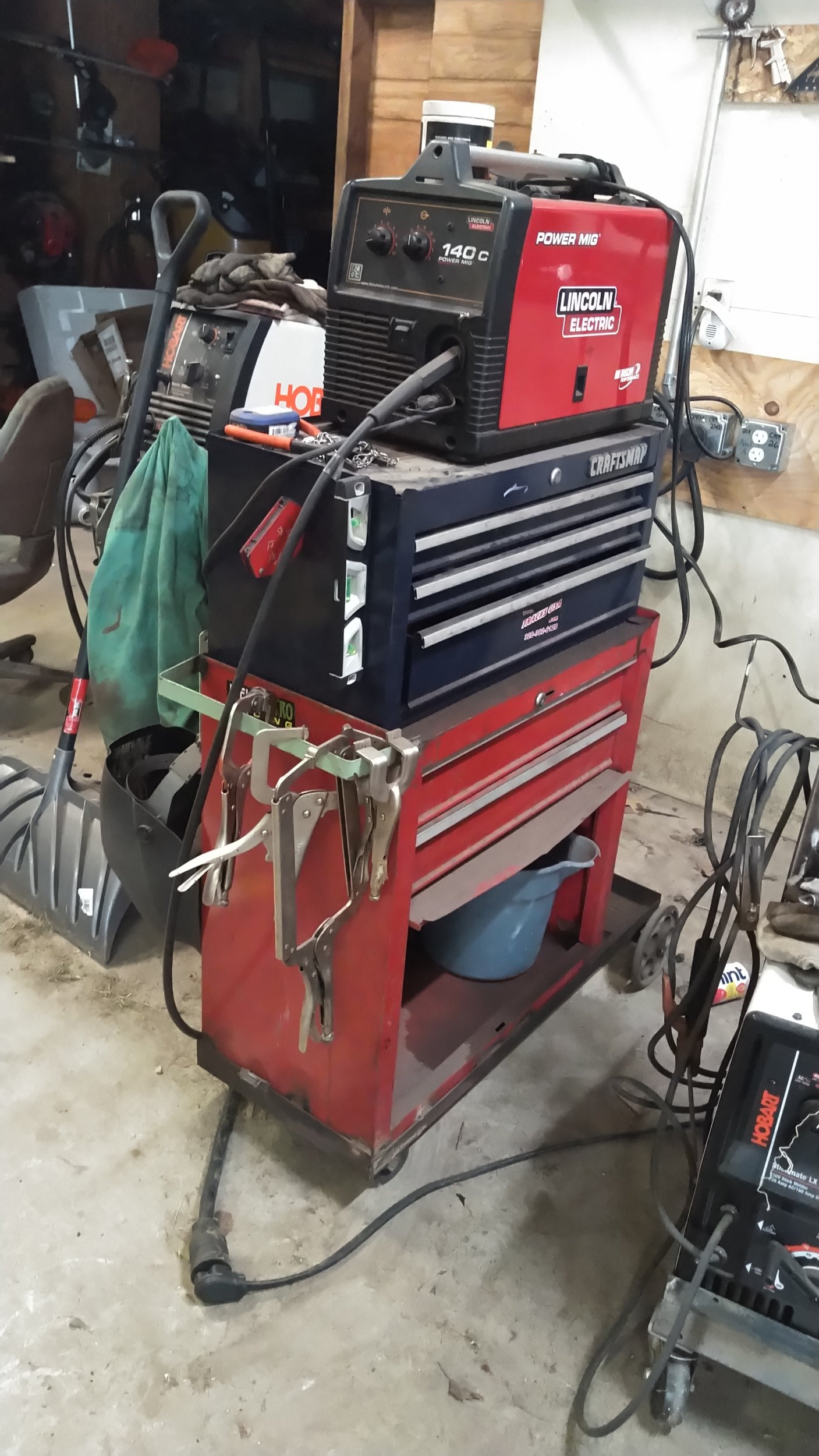

Built this using an old craftsman bottom chest, angle iron for a frame, old rear axle off a snowmobile skid and two old swivel casters for the front. Thought about running angle up the sides to reinforce and welding a piece of steel plate for a worktop getting rid of the mid box. When I worked at boatyards I utilized Stanley, wheeled carriers for organizing and hauling tools along wharfs can use the tops for a workbench kind of.

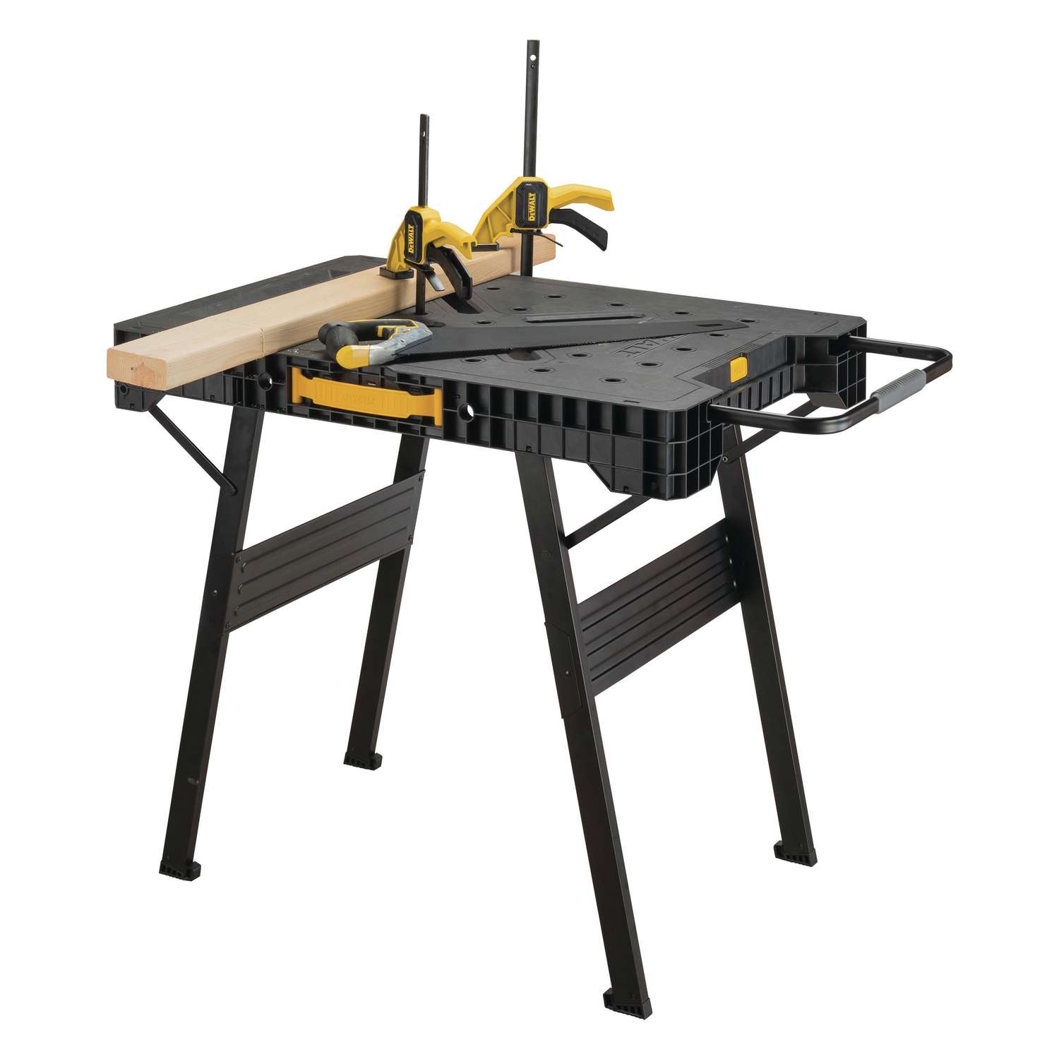

Bench top planer is heavy, about 80 pounds. This shouldn't be a problem for a decent work bench and in fact the weight was no problem for the WorkMate. The problem there was that the planer slipped around on the smooth WorkMate surface. Rubber feet on the planer would help with that. Or a set of clamps.
This bench gets good reviews:
https://cdn-tp3.mozu.com/24645-3713...-1a699327467e?quality=60&_mzcb=_1649148331752

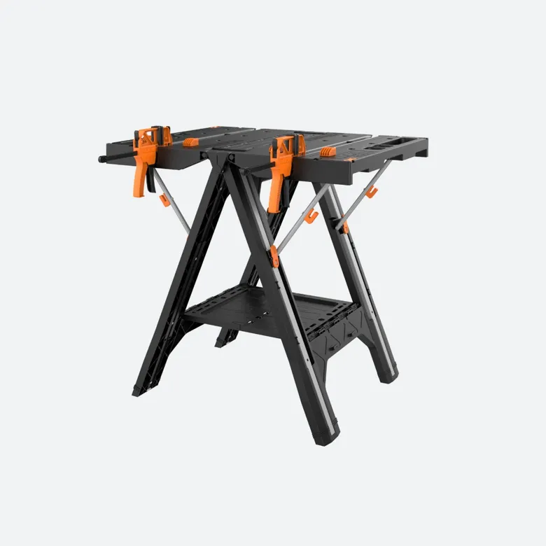

Like you, I'm usually doing projects by myself. A decent portable workspace with clamps is like another set of hands. I have both the WORX table and a KETER table. Both are light and portable but hold hundreds of pounds. Deploy and fold easy. I recommend them both.
