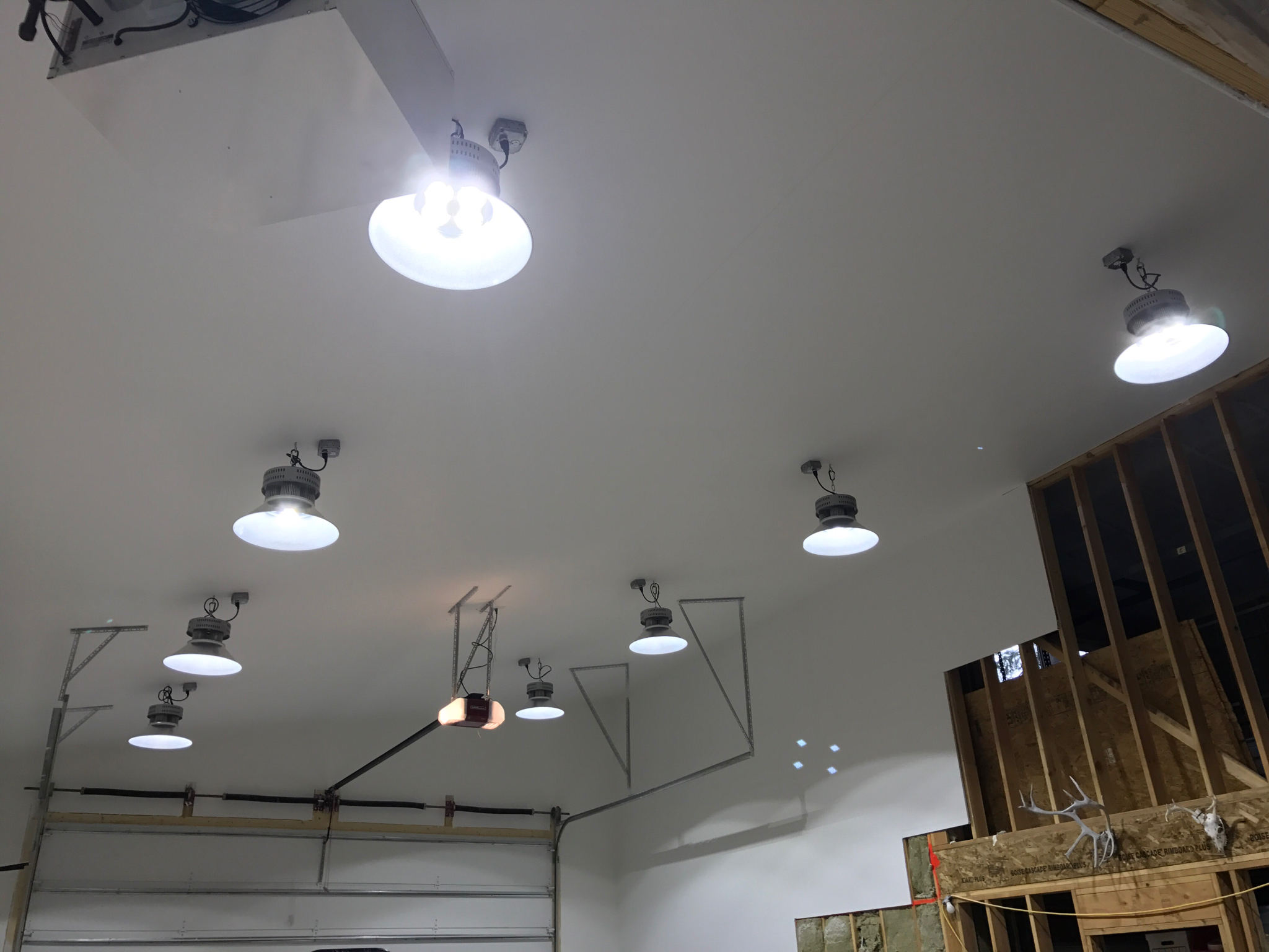

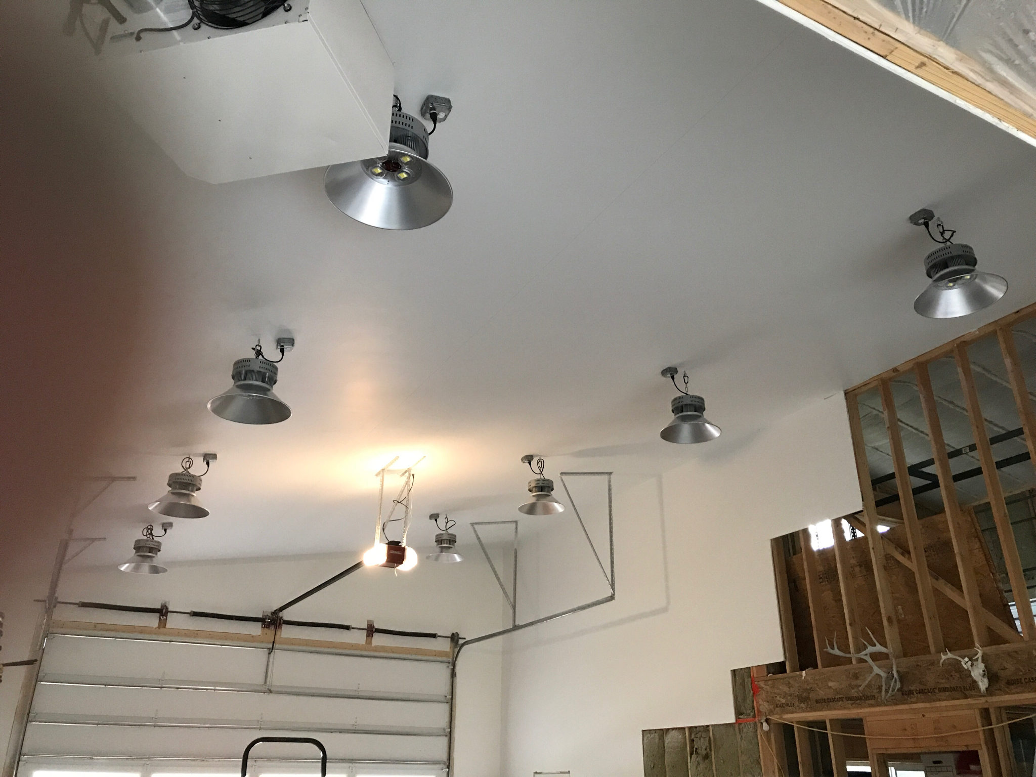

I looked seriously at the LED UFOs and then found these on eBay. The folks were easy to work with. I was able to coordinate delivery dates etc via text.
The lights work well. My shop is 25x40' with a sloped ceiling 17' on the high side and 14' on the low side. I chose to upsize 1 size based on the eBay description. I would only need task lighting under a vehicle or tractor- the rest of the shop is very well lit.
