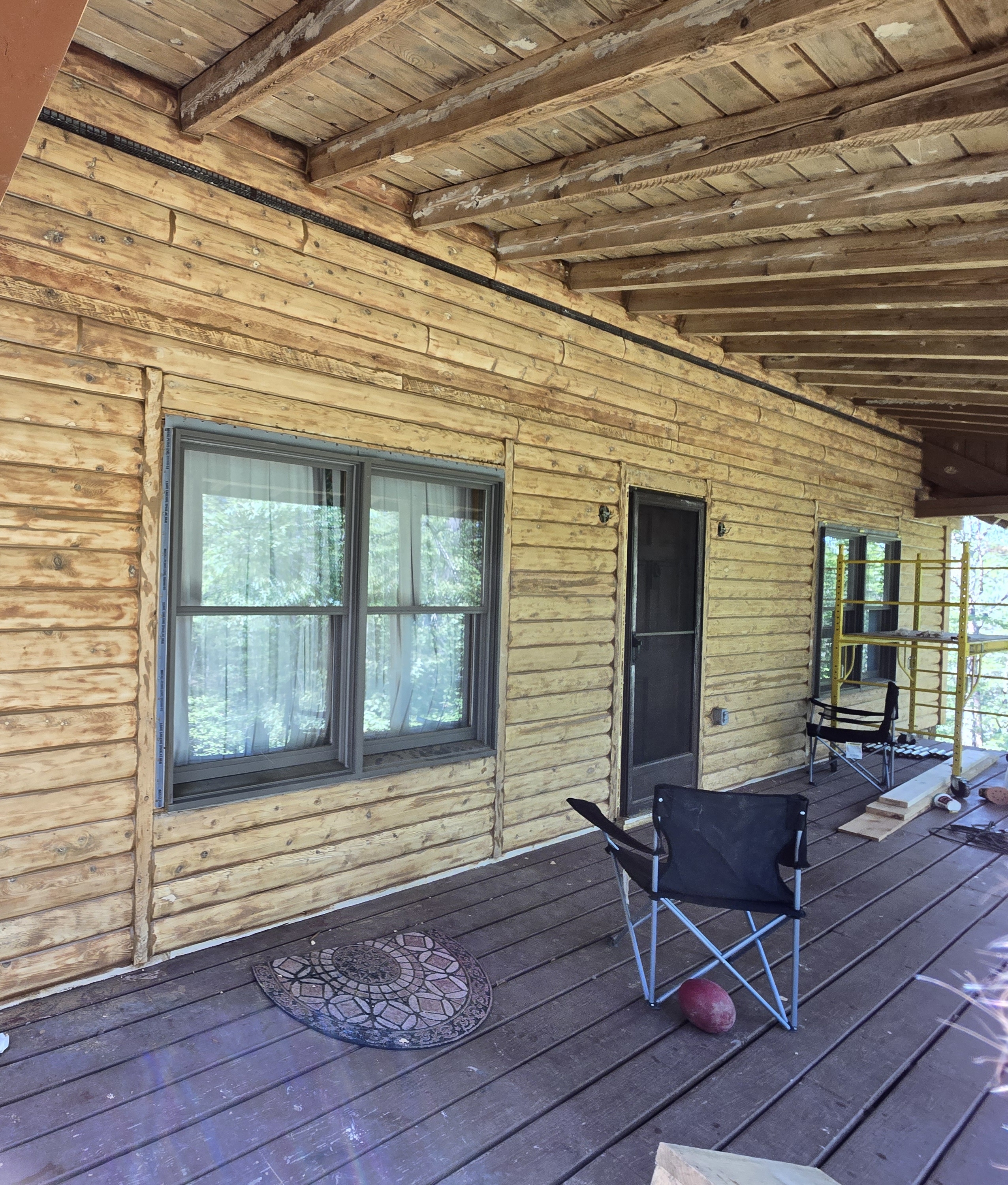

Quick Attach 80" Rock Screening Bucket (A50514)
