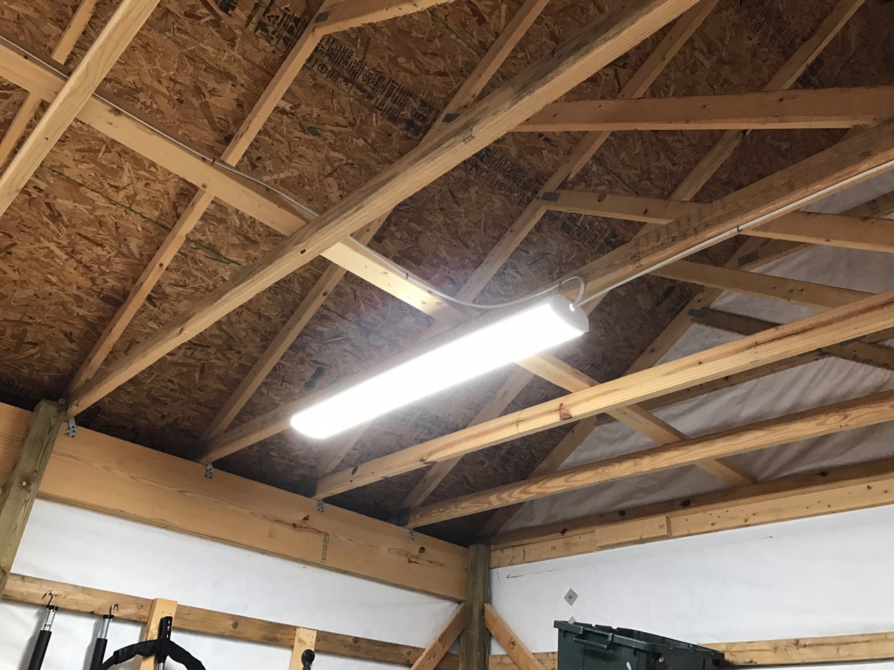

I installed x2 of the RuggedGrade LED lights I bought off Amazon. I plan on installing two more.
