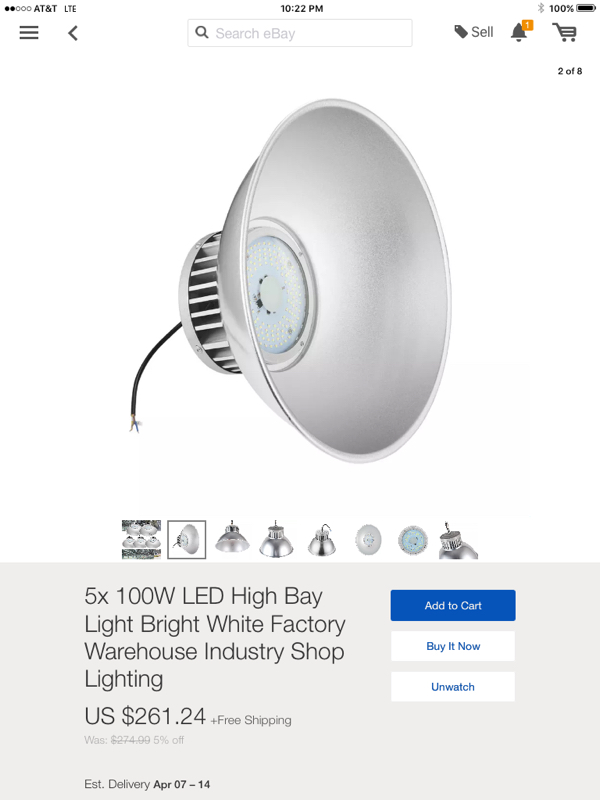

Finally finished my 40x60 shop and now I'm trying to decide on what to do for lighting. Any suggestions would be appreciated.
I was thinking about 6 of these lights

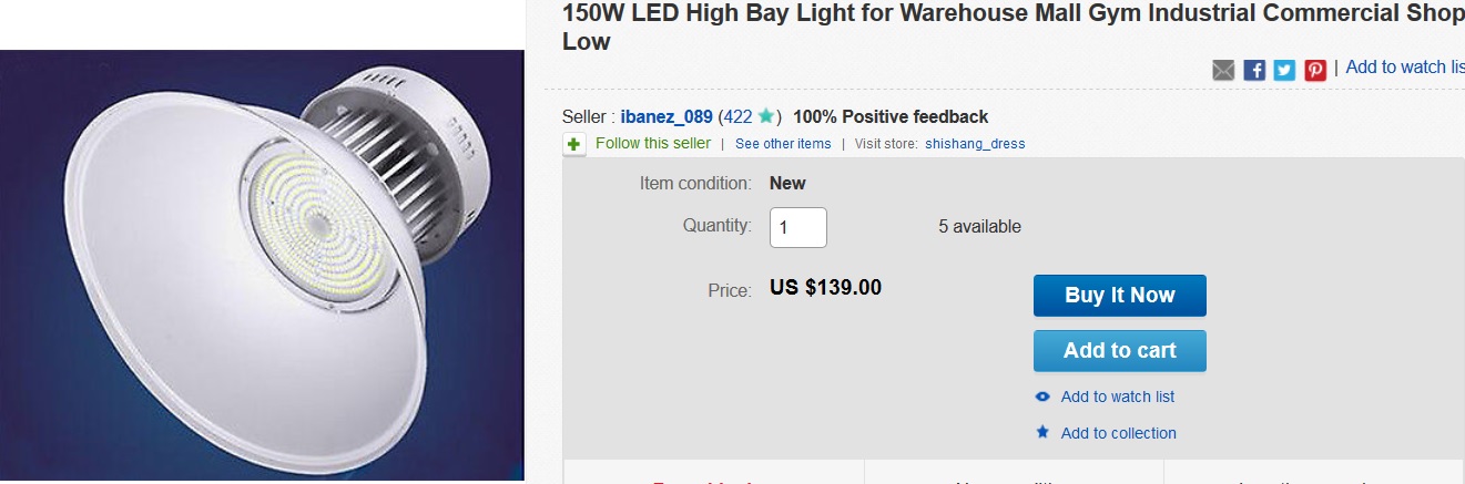

These look interesting.
This Upgraded 150W LED High Bay Light is an ideal lighting fixture for your warehouse, factory, workshop, plant, supermarket, basement parking or other commercial places. Its high stability current and superior LED chip will provide your working place with stable and sufficient brightness.
Features:
Superior LED chip
Long-lasting using: 60,000Hours longer life span
High Lumens, super bright: 16,000LM
Durable construction
Die-casting aluminum housing makes a smooth exterior
High efficient heat sink for extending service time
Scratch and fade resistant
Recommended Height: Within 16-3/8ft to 19-5/8ft height above ground
Six total lights or six 5 packs of lights for a total of 30? The 10k lumen output isn't a lot for a big shop with high ceilings and a dull and or dark finish. Google lumen requirements based on task and determine what you are comfortable with.
The "UFO" style high bays are popular. Their is a post with several pages of data that occurred a few months back.

Six total lights or six 5 packs of lights for a total of 30? The 10k lumen output isn't a lot for a big shop with high ceilings and a dull and or dark finish. Google lumen requirements based on task and determine what you are comfortable with. The "UFO" style high bays are popular. Their is a post with several pages of data that occurred a few months back.
I was hoping for 6 total one between each section of the beams on both sides of the ridge

If you search Ebay for 150W LED High Bay, you can find some for around $85
1��W 15�W LED High Bay Light Bright White Warehouse Factory Industry Lighting
Can't vouch for them, but you could buy one as an experiment (both for placement and light).
